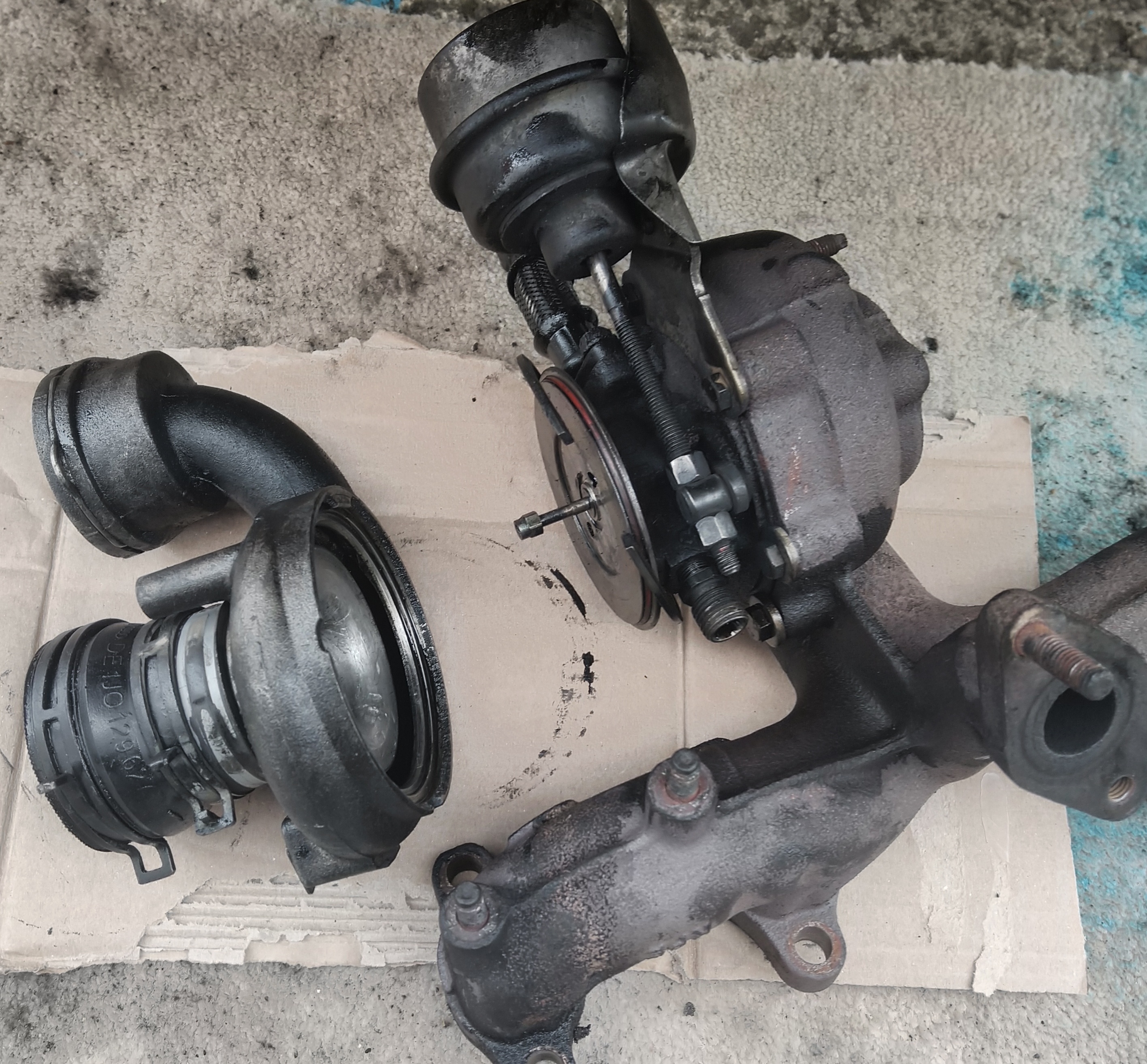

Well it's out. In both pieces .lol.
Was like that when I found it. Have to see if I can find the turbine bits now.
