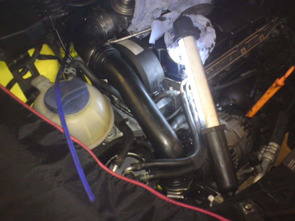

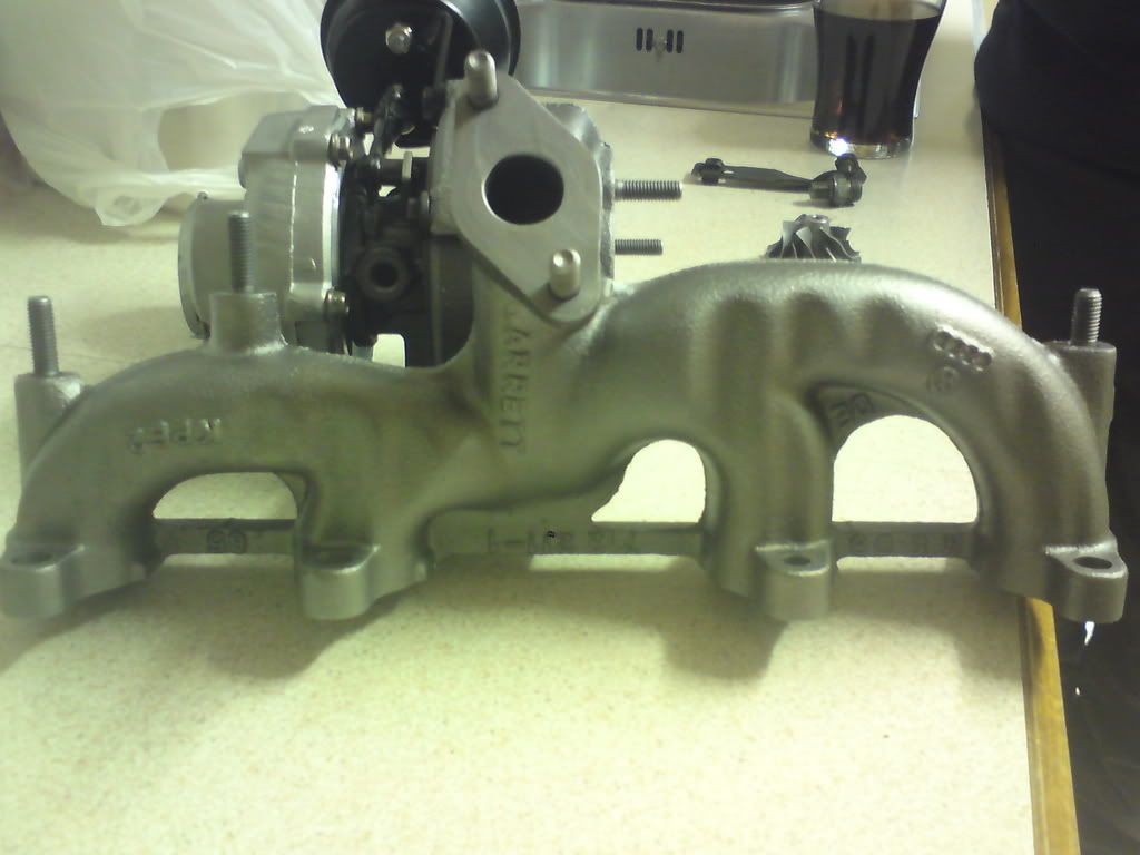

Removing the old system!

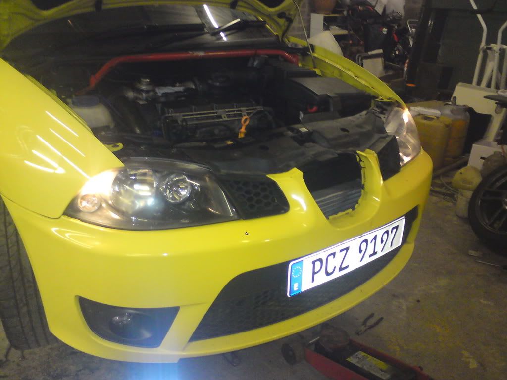

fitting the new system

Looks like you've been busy! Those bhp and torque figures are crazy! Must be quite a handfull to drive :)

Very nice, but I am surprised the stock injectors fuel enough for 250+ bhp. That's why I had to swap in some race injectors because whatever I tried I could not get the car past about 230bhp, due to lack of fuelling. Got plenty of fuel now though. :D
Very nice motor.
I thought exactly the same devonutopia. There is me struggling to get 230 out of mine - did you get the 520's?
Sprint 520s are for the non PD engines. For PD you need Race783 nozzles from Bosio, and get them refitted to the oem PD injector units, balanced, tested, then fitted.
