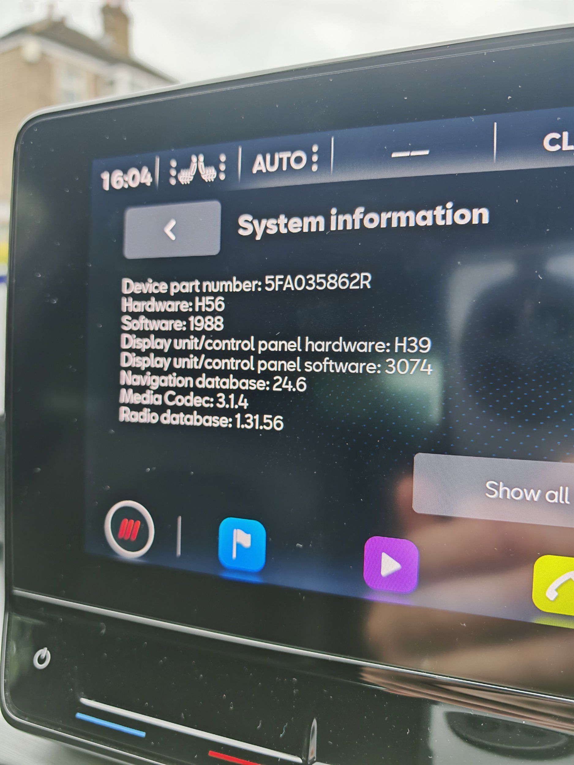

Ok but I think that in my case my radio db is older than 1.31.40 because my Leon is 2020 one.

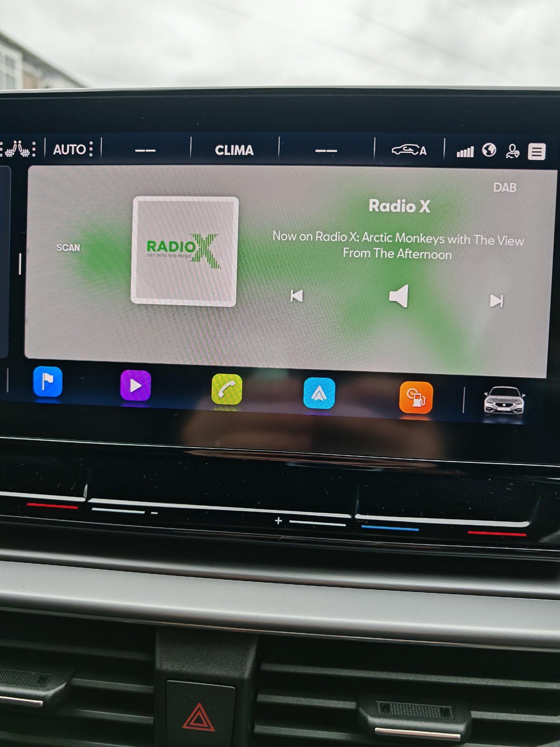

Ok I've re pinned the thread. It's not going anywhere until Phonostar include the Seat / Cupra ID as shown above - you can look in the .mnf files - the manifest file that steers the import - not SE on those lines no import. To save repeated threads I've pinned it back up as a statement as to where we are. If you keep connect services you get updates, if you don't, you can't update the radio logo. The German company that looks after the logos can be problematic with UK stations in any case... we know that, so even with that you my may not get the logos shown. MNF
A cross-check of the mnf file of the firmware with the mnf file of the logo file will tell you whether it will work for the technically minded. Later logo files have the SE in them but you need to examine the two. You can't edit them yourselves. Since I don't have MIB3 pass to those who have, to keep an eye on things. MartiniB is keeping that thread up to date.

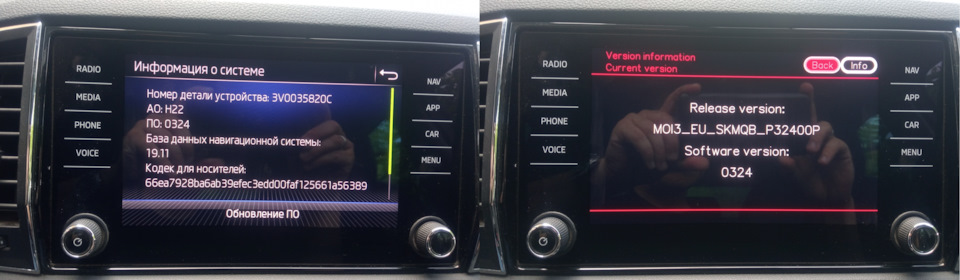

If you see an SE in the list it means it might work with a Seat / Cupra. I don't have mib3 but if anyone wants to give it a go. Ideally you need to know your infortainment unit, place it on the list and see whether it's marked up as SE.
The red menu in Mib3 tells you what radio database you are on. Connected services if more recent will obviously be better than these if they are more up to date. Suspect radio logos are still like Swiss Cheese for Mib3. Reckon your best bet at the minute if you cherish radio logos is to keep the Connect services contract going and nag Seat / Cupra.
