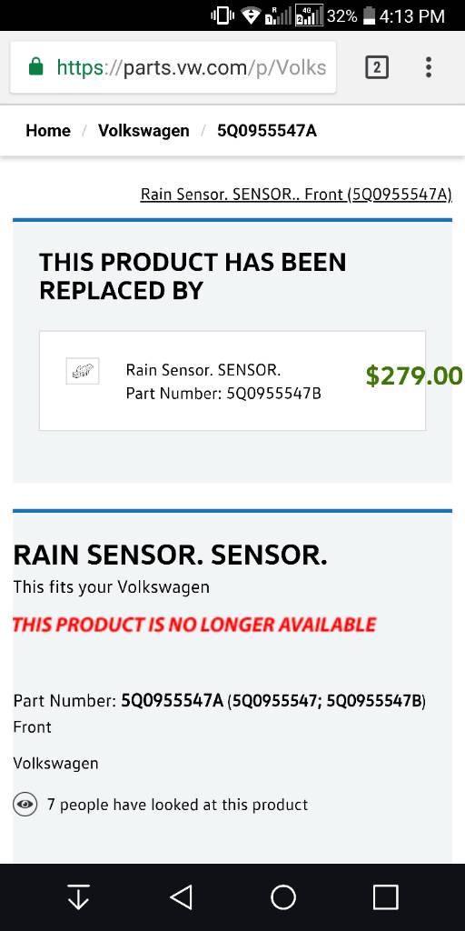

I have a Seat Leon FR 2014 without rain sensor and auto light lights.
If i get these parts HEAD LIGHT SWITCH 5G0941431AF and RLHS Sensor: 5Q0955547A
I think the RLHS Sensor: 5Q0955547A will be ok.
But i am unsure if i need a light sensor wire to go with the HEAD LIGHT SWITCH 5G0941431AF
So do i need a light sensor wire AND auto light switch if i get genuine parts ?

To get seat spec auto lights you need to replace the switch and the sensor located inside the rear view mirror casing, no wiring required as long as you have climate control.

5Q0955547A. ?
Can't remember my switch code (it's up in this thread somewhere along with my Obdeleven guide) but it lights up the right colour (not white like a golf one will) and it came out of a Polo GTi.
Cheers i have ordered a 5Q0955547A. from ebay.
