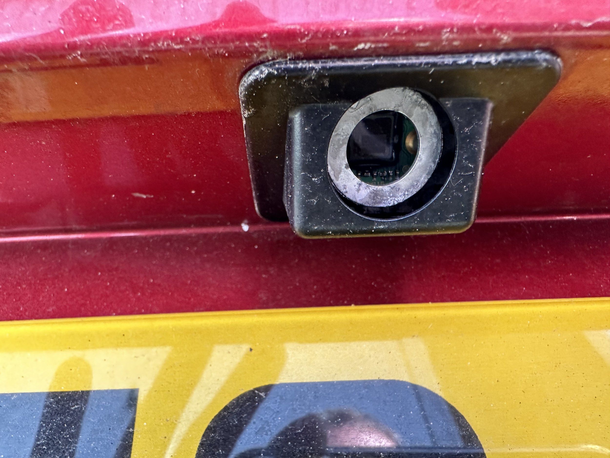

This has now happened to my Seat Leon MK4 First Edition. The camera and lens has just dropped out this week. (Some of the roads round here are atrocious and in need of urgent repair). Just waiting for the dealer to get back to me on whether this is covered by the warranty. At first they said it was not covered and wanted to charge me £600 to fix it. After arguing the case and showing them this forum they are now going to look in to it to see if they can go down the warranty route. Fingers crossed. Can I just confirm this has happen to Leon MK4 owners and not just Cupra owners?

If your car is still within warranty, this should definitely be a warranty case. It's a common issue and Seat is well aware, I have talked to two dealers in Denmark and they were quite open about it.

I recommend to tape the hole as the water could short out complete system causing more damage to other CAN units.
Do this. My parking sensors are now fecked as a result. Intermittently don't work and restarting the car fixes them.
