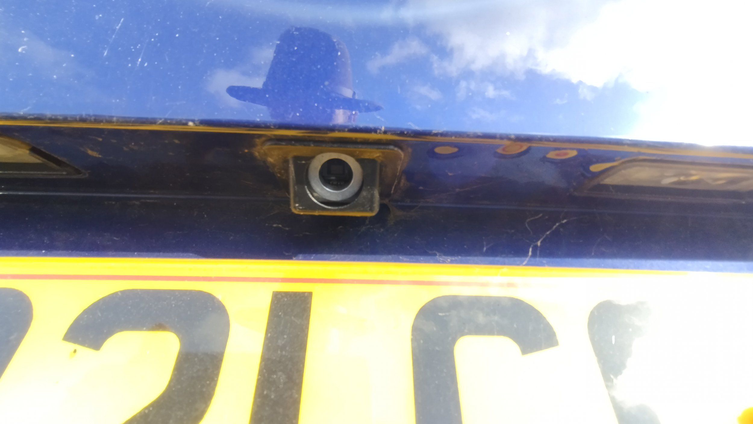

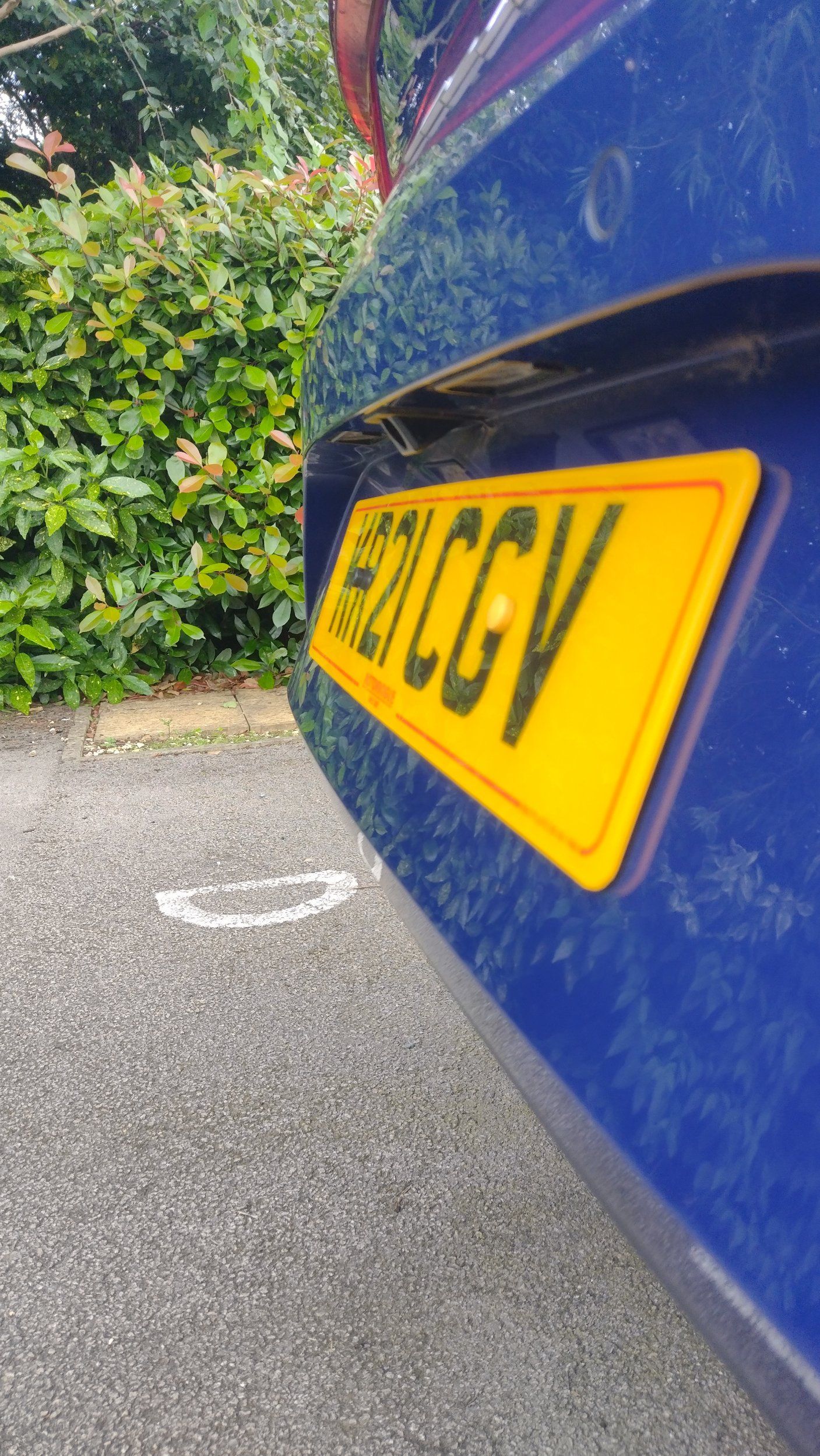

Had my "investigation", the Dealer Motorvogue in Northampton has looked at the missing camera and is claiming that someone must has reversed into th car at some unknown point in time and knocked it off and are refusing to replace under warranty. How was SEAT UK contacted to replace the camera under warranty? This is a motability vehicle so this would be another 9 months until it's due for replacement.
I have pointed out the existence of this thread to the dealer and reports from around the world not just the UK. They cannot explain how the camera was knocked off with no visible damage to any other part of the car or bumper when it's mounted under the damn thing. This is the missing camera
. View attachment 37709

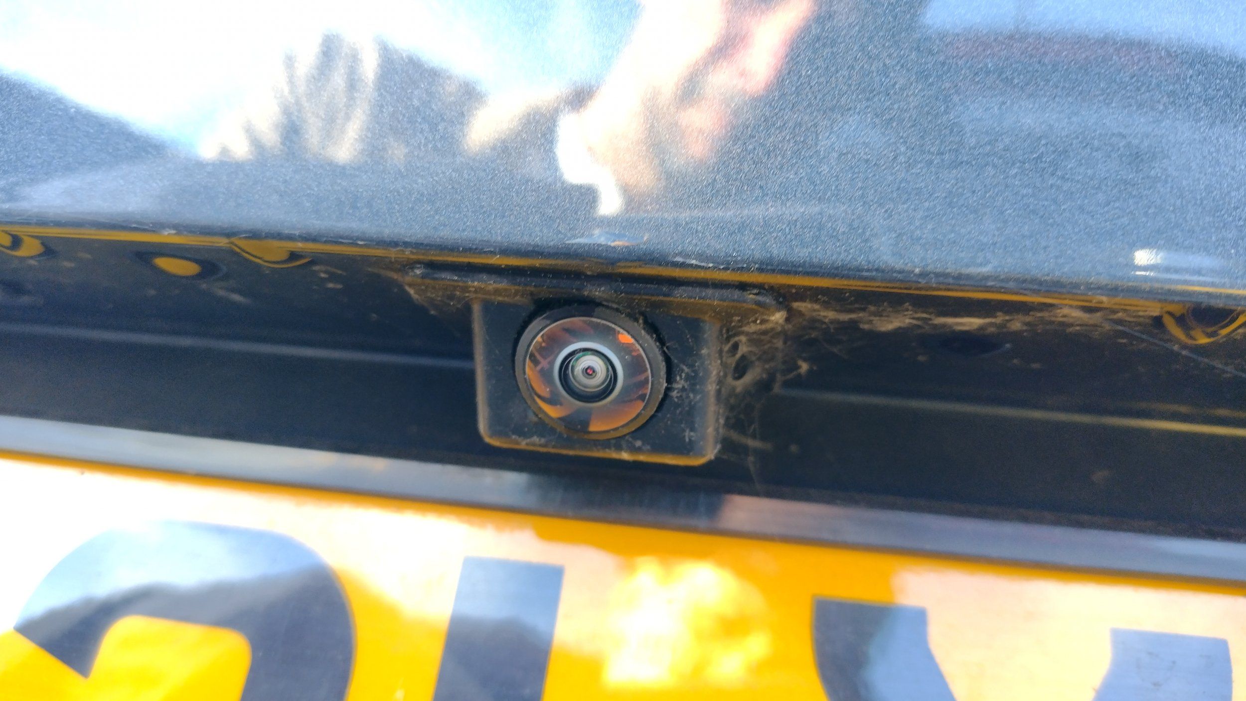

This is an intact camera in the dealer's car park.
I'm sure there is an internal document advising about the part issue from the supplier. Obviously, SEAT just ignores that even if the supplier will reimburse the cost. Pile of nonsense in the UK market especially with the franchise that is running here. o_O

Mine's a 2021 model 12k miles, I believe that whatever they are using to fix the cameras in place is failing after a couple of years, one poster did lose their's when power washing, another person has had a couple fall off so it may be rough roads. I have my leasing agent trying to raise this with SEAT UK because the dealer "someone must have hit it" excuse on a vehicle in a private car park etc... where the rear bumper sticks out further than the camera mount and there's no damage, is rather annoying.
