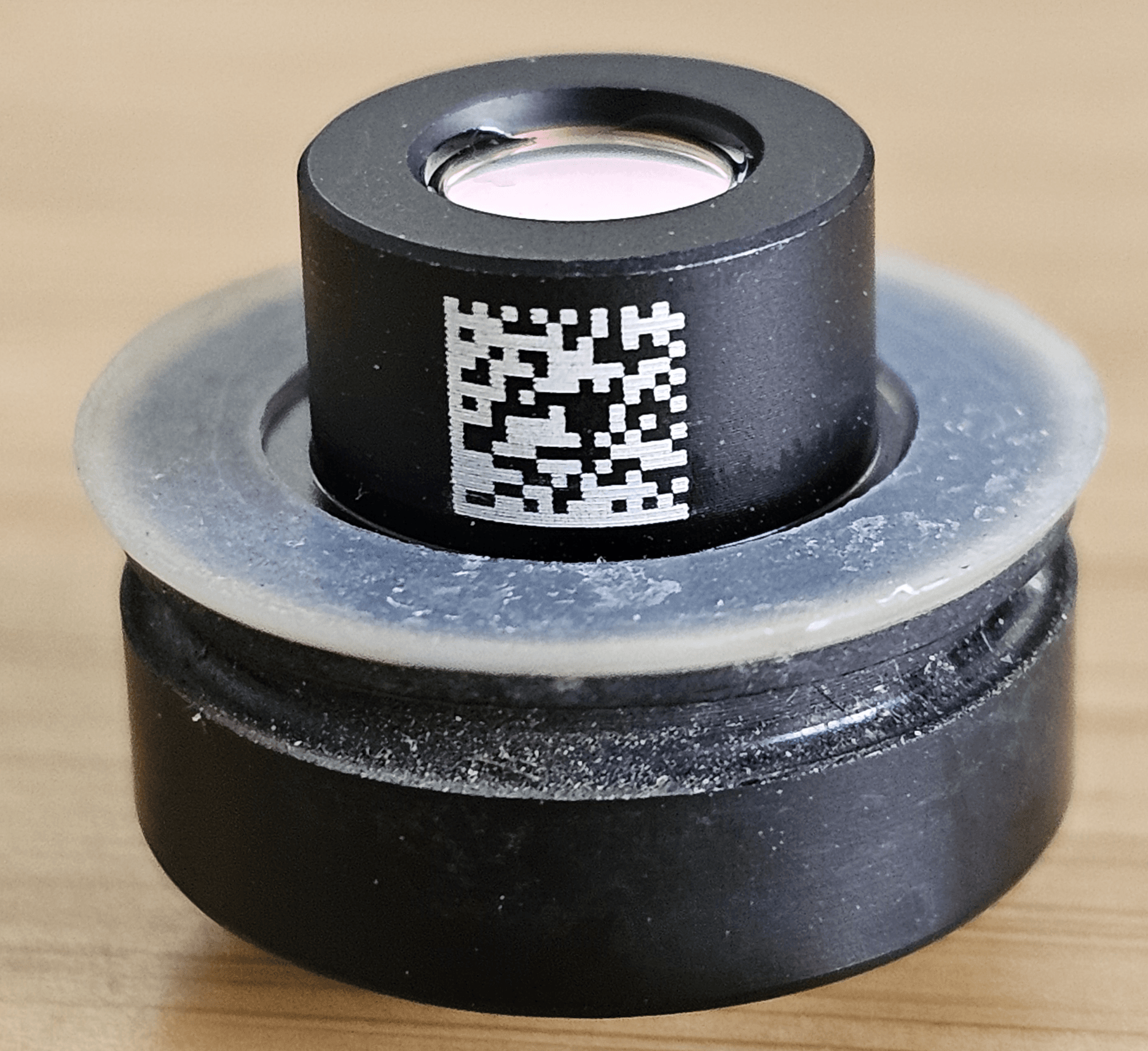

Quick update on my car with the rear camera lense that fell out when I closed my boot. Well yesterday was the day the my car was booked in with the seat dealer and they were really helpful to my surprise. They had a look at the car and then asked me how the camera lense happened to fall out. I told them that I had just shut my car tailgate and it simply fell onto the floor. I also told them that I am a member of this forum and that I now know that it's a common fault. The technician asked if I was jet washing around the area which I told him I had not been doing and he said that's good then because he had known other people to tell them that's how there's had fallen out and that they got refused to have it repaired under warranty in them cases. They offered to clean my car and update the infotainment system for free whilst I waited and then handed me the car back and said to wait a couple of days to see if it would be accepted by warranty. I've just had a phone call back now from Seat and they have said its good news and that they are going to fix it under warranty and that the whole module is going to be replaced because they don't stock just the lense. The lady on the phone actually said she was surprised herself that they was going to do it under warranty as she had had many before that had been refused. Must just be a pot luck thing but hey I'm not complaining. They are meant to be fitting it on April 15th which is not to long of a wait so that's a bonus too I suppose. I'll keep you updated when it's finally fitted.

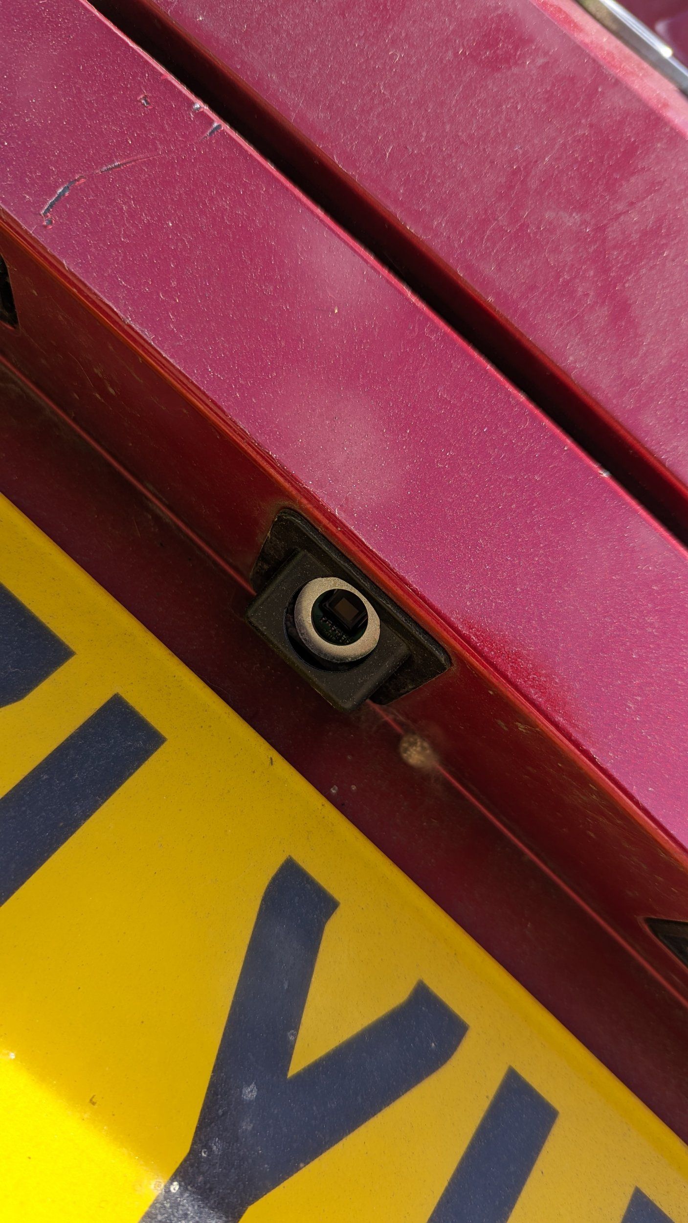

Same problem - camera fell off Seat Leon Estate FR First Edition on Sunday - and my car is only 2.5 years old.
I've been told by my Seat dealer that it won't be covered by the manufacturer's warrantee, and quoted:
* £144 labour to fit new camera
* £250 calibration of new camera (they said they use a local BMW dealer because they don't have the equipment or skills, so charge me to cover their costs!!)
* £??? for parts - they've not told me yet, but I see people on here saying £600 and waiting moths. :(
So I've spoken with SEAT's customer service about things falling off their car.
They said that the dealer MUST see the car in person and run a diagnostic before confirming if it's covered under the manufacturing warrantee, (so maybe it is, unless they can prove otherwise ??), but also said that I'd be charged for the diagnostic if it's not covered. (Computer says computer must be used. Computer asks 'can you see the missing camera?' Computer says 'not covered, £120 please'.)
SEAT Customer Services also couldn't give me a list of what is and isn't covered under warrantee. They directed me to talk to THEIR insurers, as they are the ones who decide on a case by case basis (???).
Sad to say, this car has been riddled with issues since day one - a repeatedly dead battery, a failed rear washer pump, a failing interior light unit (it would instantly turn back on when turned off), lots of software issues the latest of which is android auto refusing to connect, brake and gear issues.
But still a lovely car to drive (when not braking,haha)
