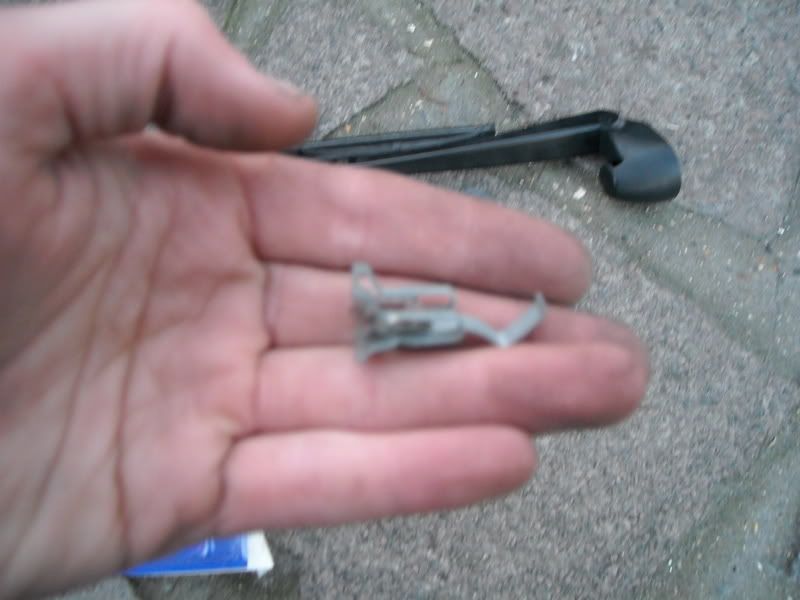

the only problem i had was this pinged off from somwhere when i was takeing the plastic cover off
it wasnt until i put it all back on that i realised it was to hold the screw from under the grab handle.
cant be bothered with taking it back off at the moment but will do if it rattles atall.
