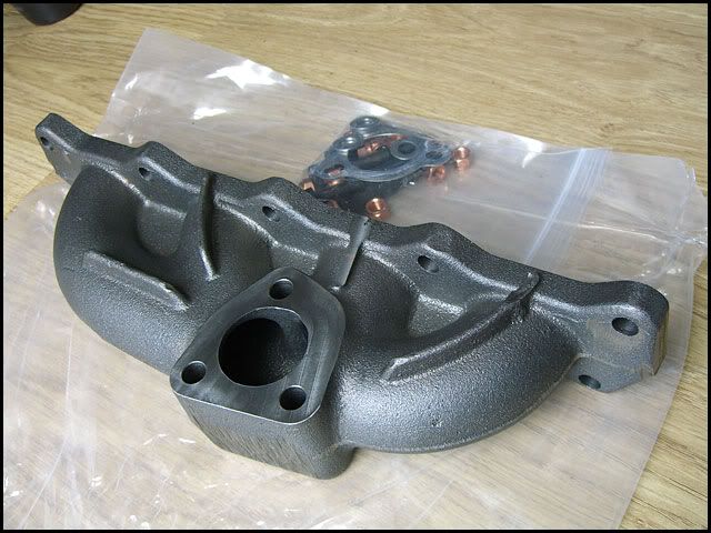

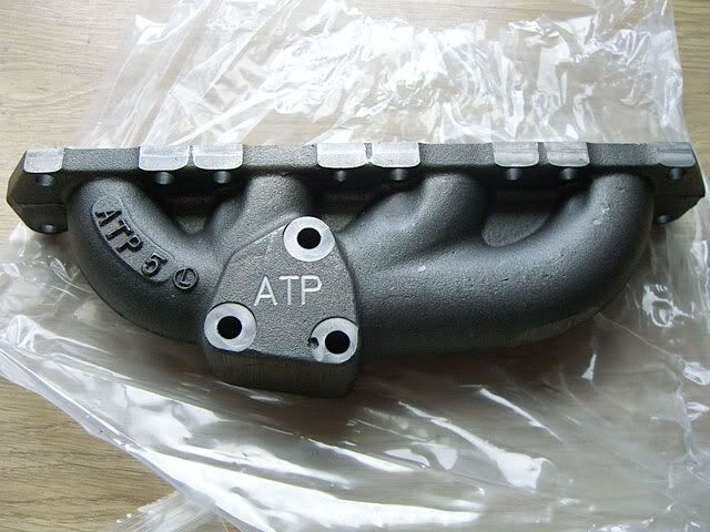

New ATP manifold arrived today as well, pics later.
