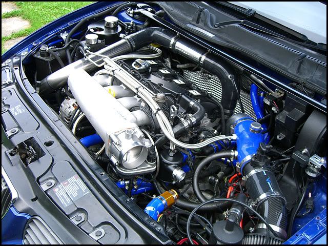

Latest progress pics, things aren't taking too long, luckily I have a few pipes and bends lying around I've been able to use:
http://i312.photobucket.com/albums/ll330/SonicBlueLeon/seminstall3.jpg
http://i312.photobucket.com/albums/ll330/SonicBlueLeon/seminstall4.jpg
Some new silicone hoses turned up today, including the 80-60mm reducer, so tomorrow I'll be removing the front bumper and finishing off the runs down to the intercooler on both sides.
Still not sure whether to use an LCR charge pipe or not, would it look neater?
Possibly, but looking at your pics I struggle to see how...
It might look a bit "wannabe" if you know what I mean. Also, there's a fair bit of bracketry to source/modify as it might not fit straight onto your outlet.
P.S. Your TIP made me smile - it's about half the length of the car!

I think it looks good as it is. Whats the deal with the blue S bend for the inlet?
On another note, gotta love those SEM manifolds.

I see you have the throttle body twisted round. I've heard this can help even out the flow across cylinders.

Apparently it works on standard inlets too I've been told. Won't hurt to try.

Looking great Rob, one thing though... the external diameter of the 80mm throttle body is 88-89mm. I've ordered a 88 - 63mm reducing bend followed by a standard 63mm bend to try and get me to mate up between the map sensor housing and the TB. 300bhp i recon no prob Rob.
