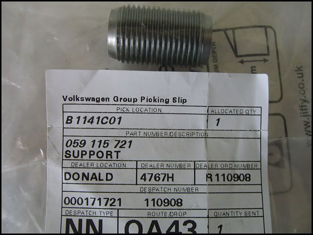

Received this today from Tristan @ Ted Johnston SEAT:
http://i312.photobucket.com/albums/ll330/SonicBlueLeon/oilunion.jpg
It's the short oil filter union that allows me to fit the oil cooler adapter plate, the standard one is way too long because it has to go through the water cooler. Rather than chop up the stock one I got the right one for the job! Got a new timing belt cover too as mine is quite badly marked up.
