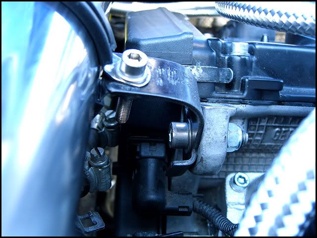

Charge pipe looks good and personally I wouldn't bother with the LCR one, though it may benefit from a support bracket to prevent too much movement - Hooch had this problem, you can see it on the RR video he posted.

Well nearly finished, the pipe runs are both complete, support bracket is done and solid, just got to separate the loom again to bring the MAP sensor wires across to the right then re-wrap (forgot to do this the first time - doh!).

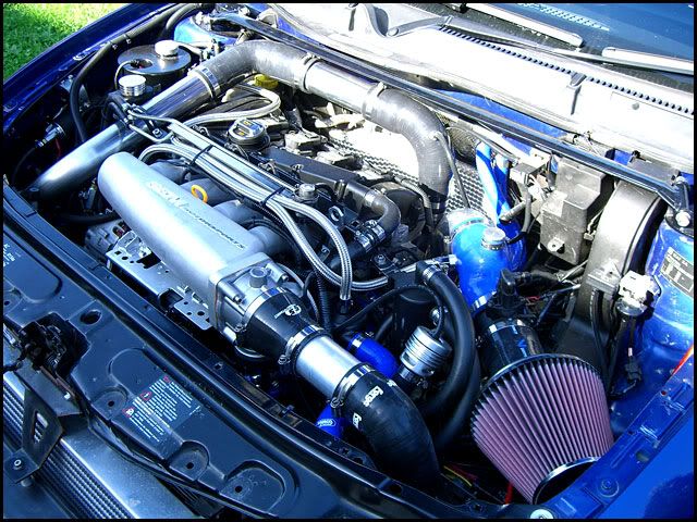

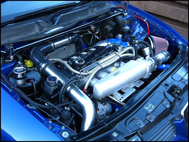

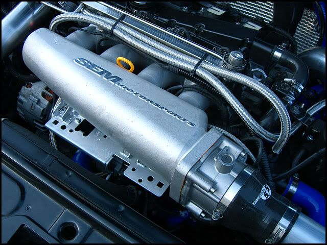

I'm going to leave fitting the oil cooler until the winter, give me something to do before trackdays next spring. Meantime I have finished installing the SEM manifold, here's some pics:
http://i312.photobucket.com/albums/ll330/SonicBlueLeon/seminstall5.jpg
http://i312.photobucket.com/albums/ll330/SonicBlueLeon/seminstall6.jpg
http://i312.photobucket.com/albums/ll330/SonicBlueLeon/seminstall7.jpg
http://i312.photobucket.com/albums/ll330/SonicBlueLeon/seminstall8.jpg
http://i312.photobucket.com/albums/ll330/SonicBlueLeon/seminstall9.jpg
http://i312.photobucket.com/albums/ll330/SonicBlueLeon/seminstall10.jpg
Car is up and running again now, throttle-body adaption went fine, fired up and no leaks anywhere, so it's all good. Driving impressions tomorrow!!! :D

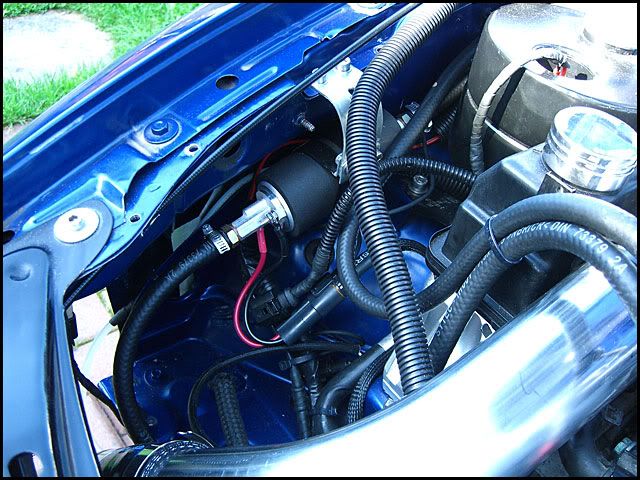

Oh, and one last pic of where I mounted the Walbro fuel pump:
http://i312.photobucket.com/albums/ll330/SonicBlueLeon/walbro1.jpg
I moved the carbon canister further down to where the washer tank used to be.
