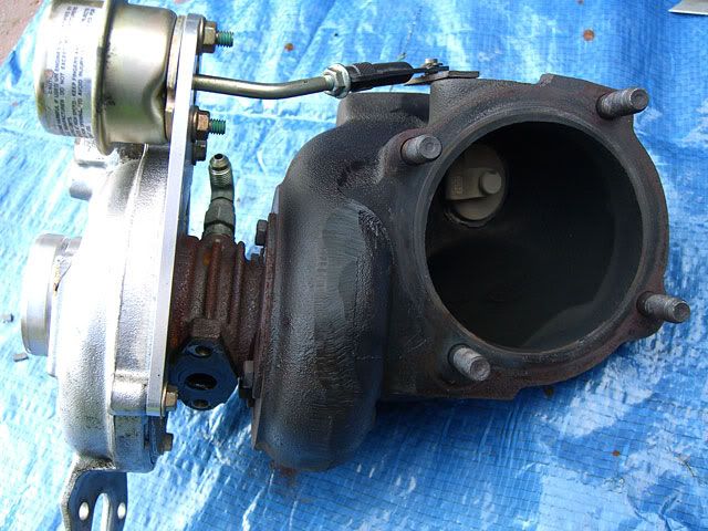

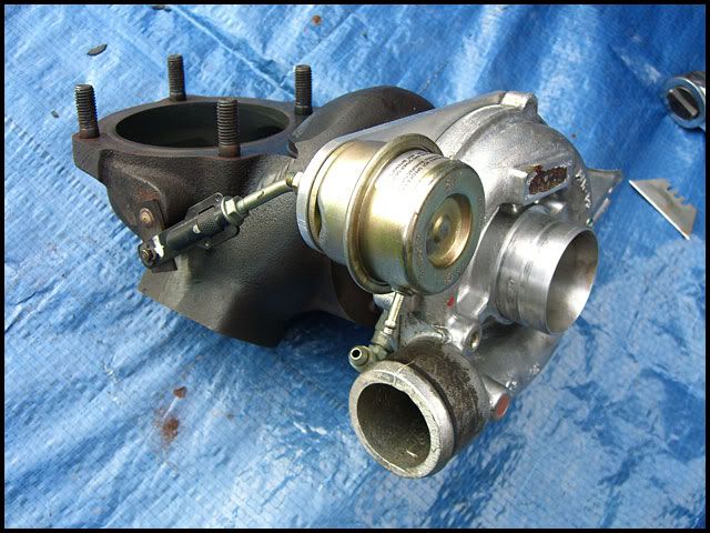

OK I got the turbo off the car tonight, not a major job just a real pain, it could all be done from the top if the manifold bolts weren't such a nightmare to get at, whoever designed the ATP manifold needs shot - can't get any form of spanner into the top middle 3 nuts to undo them!!!!!!!! PlusGas did a great job as not one single nut or bolt was stuck at all.
Sending the turbo off to CR Turbos tomorrow so we'll see what they say, definate signs of damage to the blades and also touching the sides. Looks like a bit of debris may have been ingested.
http://i312.photobucket.com/albums/ll330/SonicBlueLeon/turbo01.jpg
http://i312.photobucket.com/albums/ll330/SonicBlueLeon/turbo02.jpg
http://i312.photobucket.com/albums/ll330/SonicBlueLeon/turbo03.jpg
http://i312.photobucket.com/albums/ll330/SonicBlueLeon/turbo04.jpg

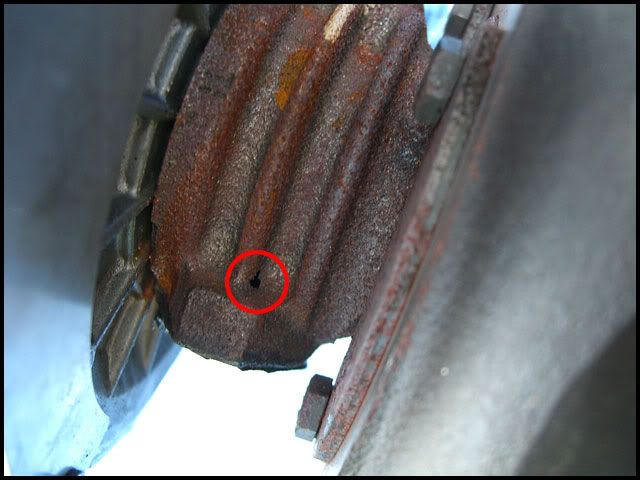

More worryingly is the fact I found 2 holes in the housing behind where the oil return hose bolts fit, don't know if they lead into the bearings or just behind the bolts?
http://i312.photobucket.com/albums/ll330/SonicBlueLeon/turbo05.jpg
http://i312.photobucket.com/albums/ll330/SonicBlueLeon/turbo06.jpg

I think the holes are just casting holes
