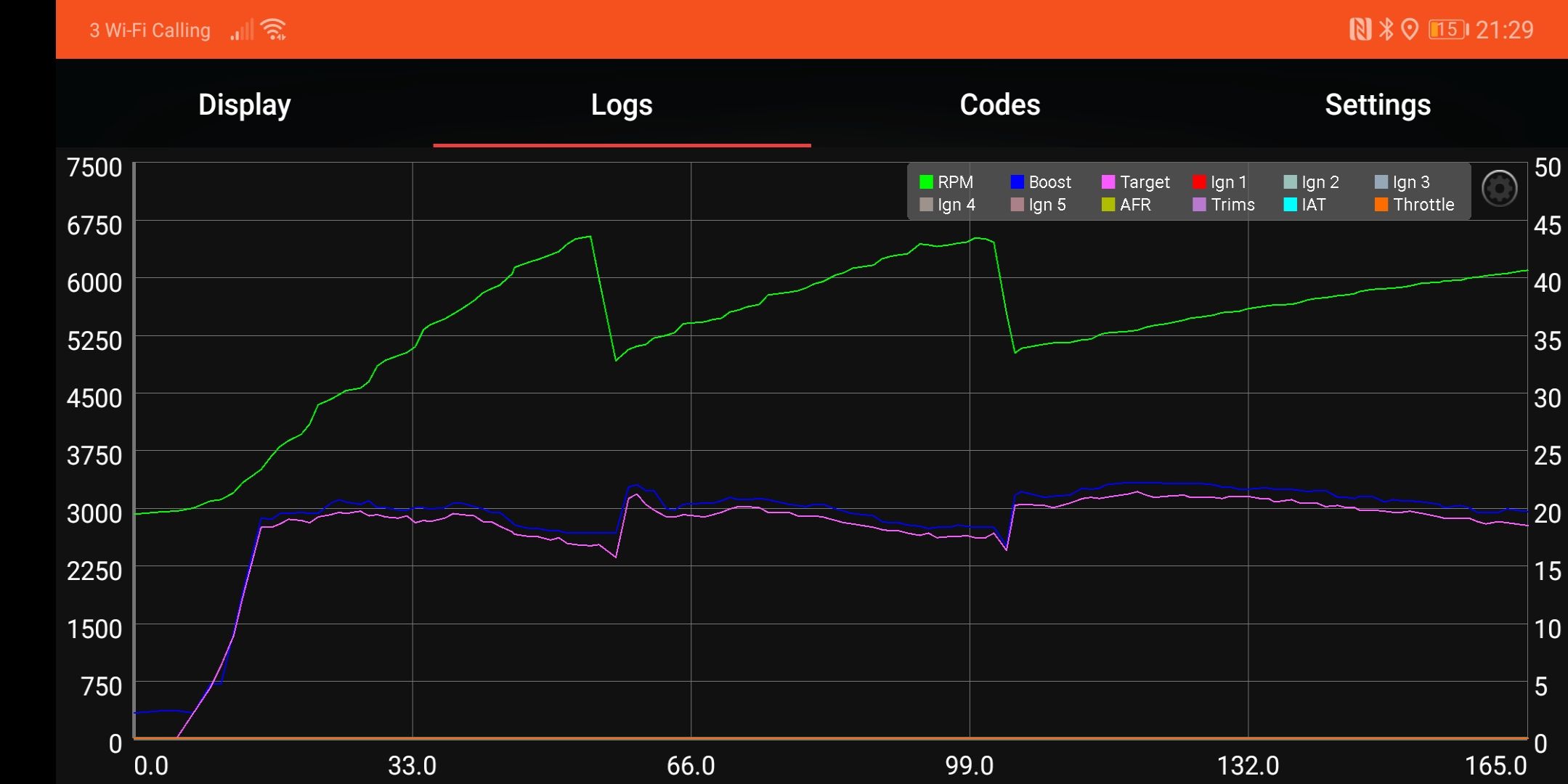

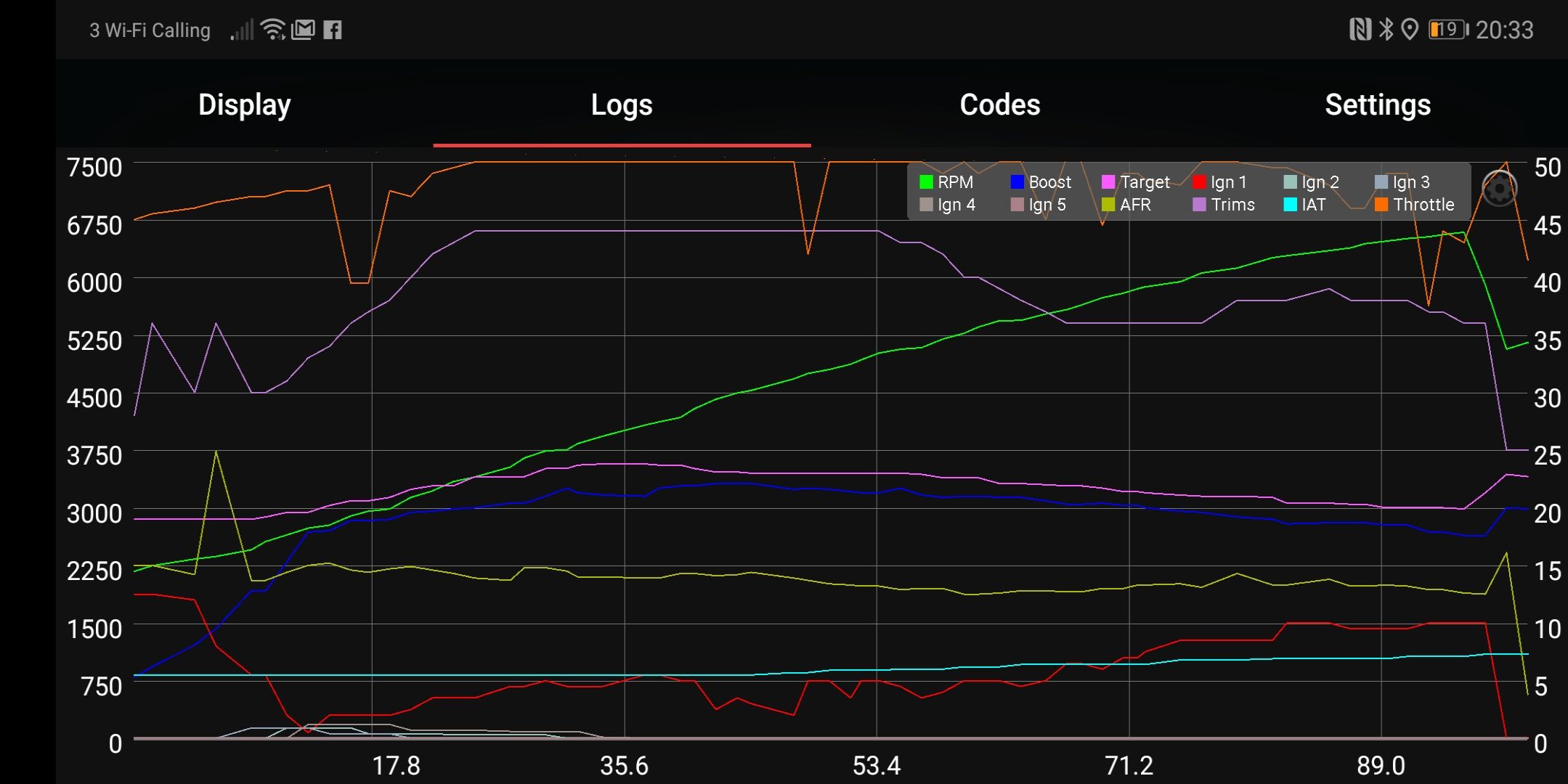

There's 2 methods with map6, additive and absolute! Additive you add on extra boost over stock, absolute your telling it how much actual boost you want regardless of what the ECU woulf want!
I run absolute settings, beneficial this time of the year as I can take full advantage of the colder denser air, as I mentioned earlier, the ECU will request less boost during the winter, so using the additive method will also mean less!
I run stock boost in 1st, then 23psi peak from 2nd onwards! Just haven't had the time to play around with lower boost in 2nd!
The jb4 software will output an excel file as either a spreadsheet of a graph, I converted it to a pdf just for the forum to recognise the file for upload!
I used to run a jb1, had great results from it, the jb4 is much better though, waaaay smoother and makes more power, plus you have full logging capabilities with it!
Heres that spreadsheet in the graph format from the mobile app, for in-depth viewing of the graph, the pc software is better!
