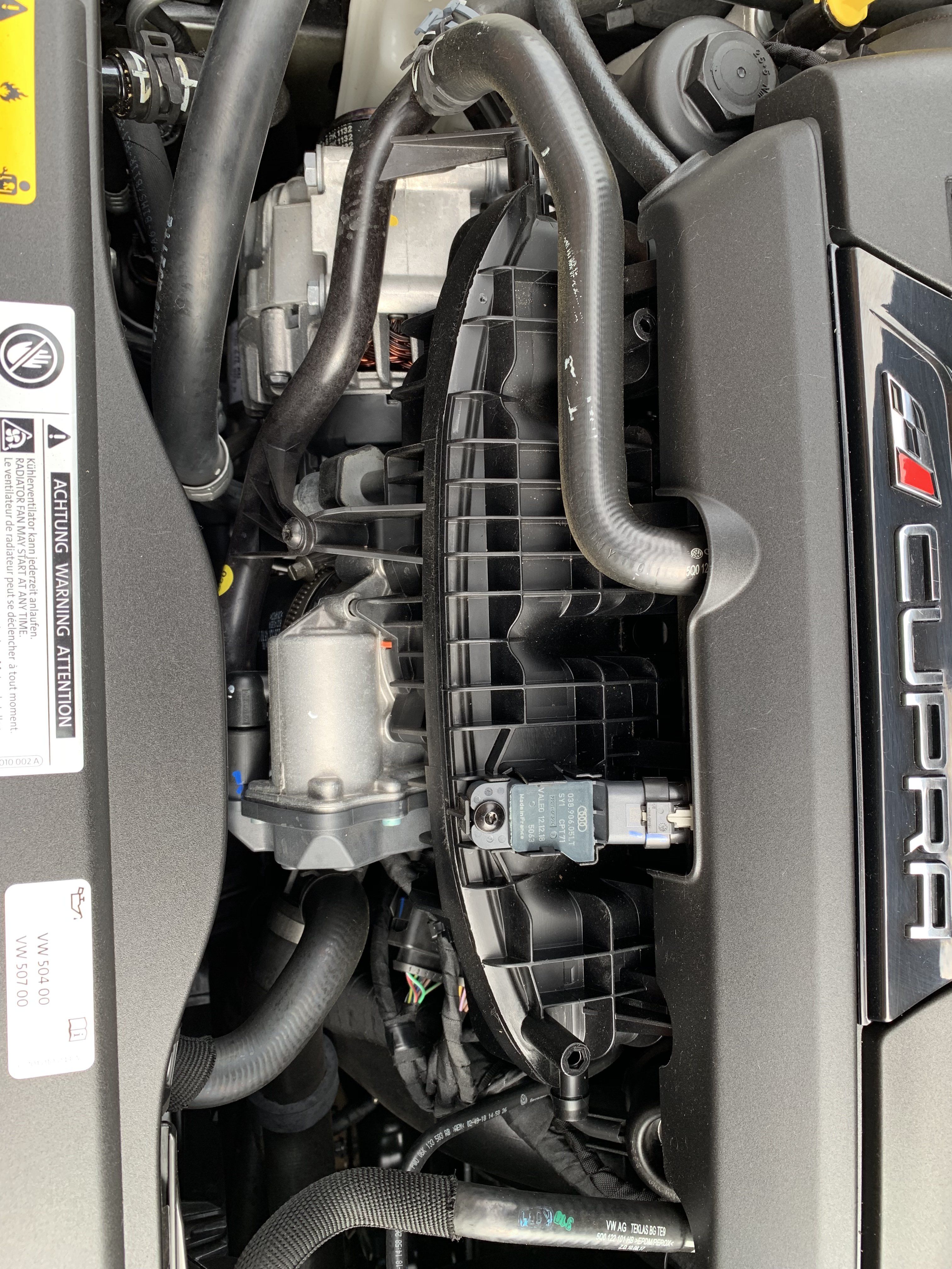

How can you check if you have MPI dual injection or direct injection?
Take a photo of your intake manifold and post it here.
If you have gpf, then you don't have mpi.
I tried attaching a photo of how it looks, but I couldn't...

Snowman
Mar 16, 2014
299
24

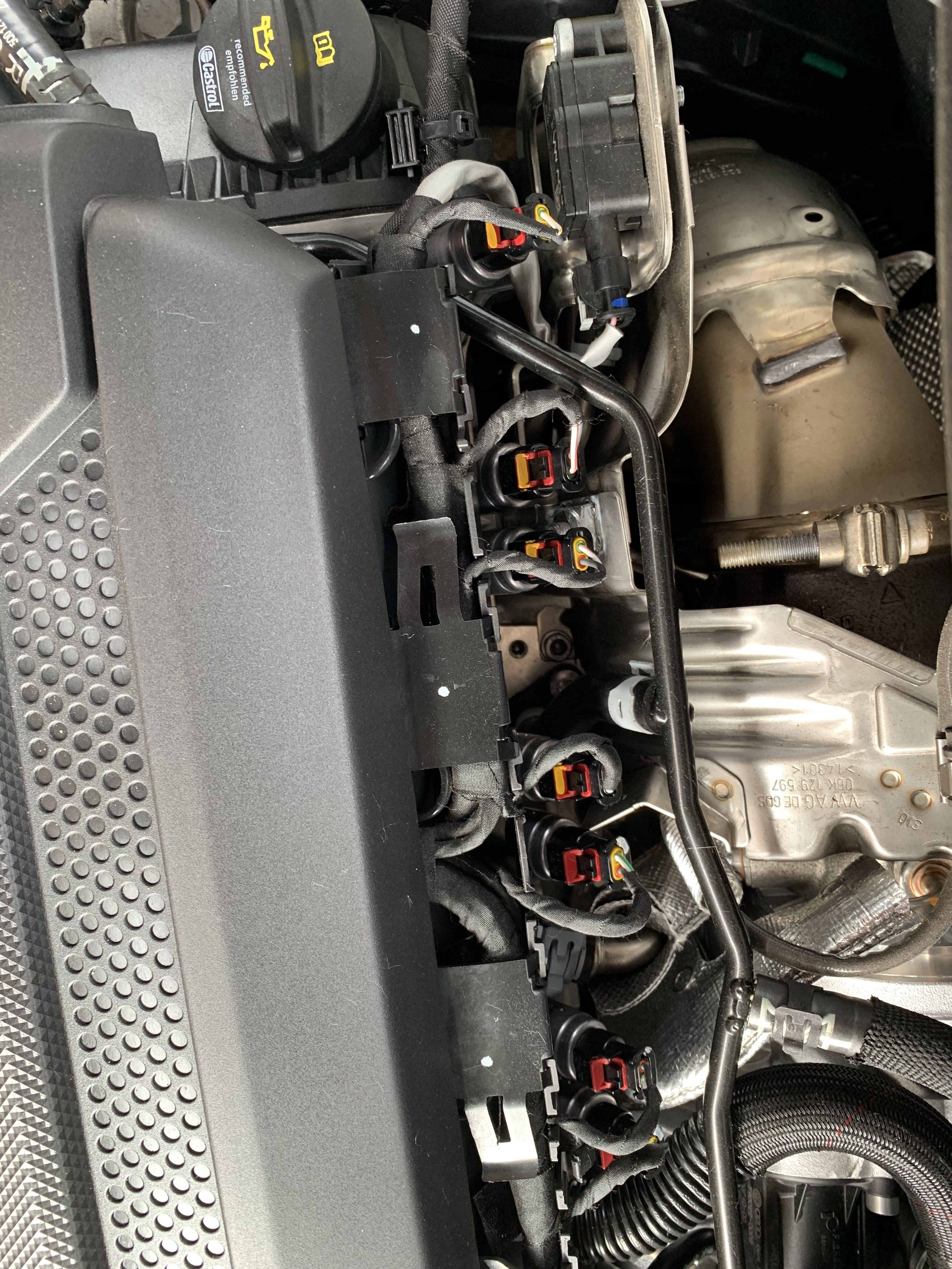

Can you tell from these?
No I'm afraid not.
Either remove the plastic engine cover and take a photo of the intake manifold, towards the valve cover.
Or just take a photo of the high pressure fuel pump, the big "round" lump that sits to the right of the engine cover (when standing and looking into the engine bay).

bunziboy
Jan 17, 2019
39
17
No I'm afraid not.
Cheers
