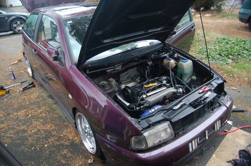

Engine Bay:

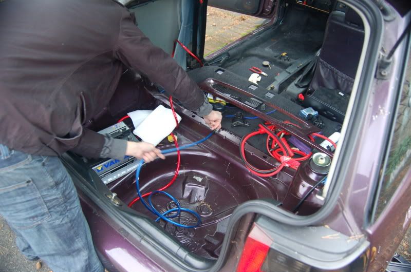

Double Gaskets:

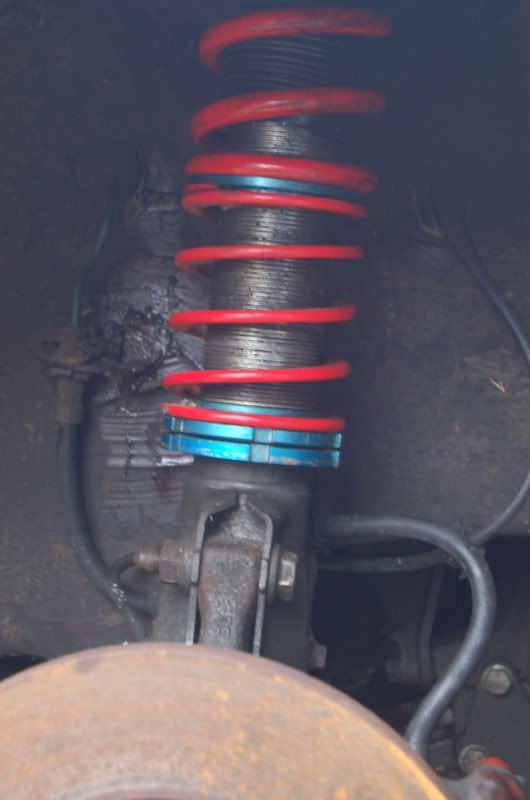

Megasquirt:
