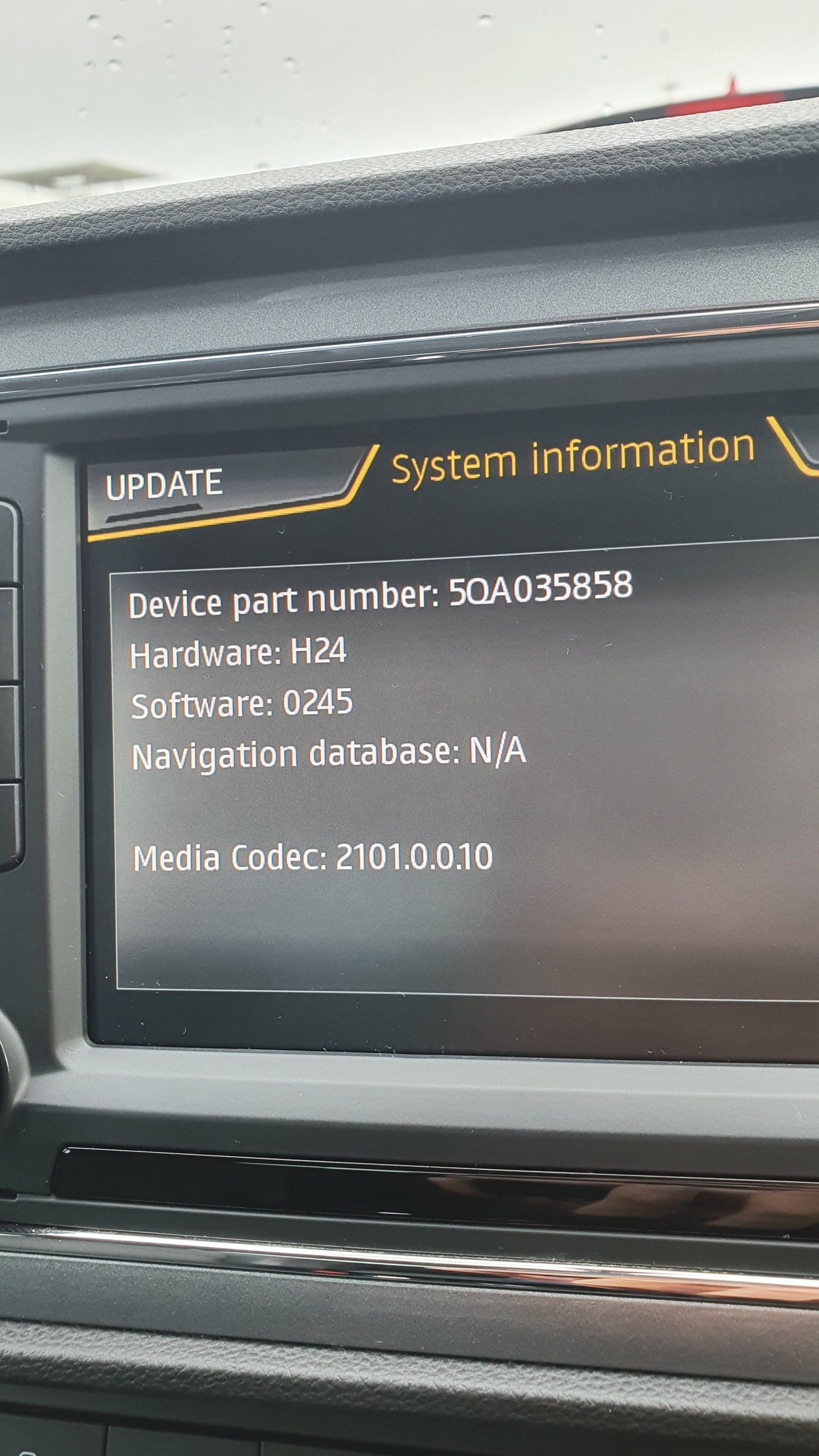

For those that need the files hire it is from the Spanish forum together with some G translate info.
My unis is 5QA035858 HW24 SW245, the update to 346 went well with no problems at all.
330
https://drive.google.com/open?id=1wvEmQkI1eyyWFSxrwje9kap7tSOmXdaf
346
https://drive.google.com/open?id=1n08Fdw3C53futzb3b8sv5dOEwn2wIYv7
Mib2 - 6.5 "screen
Version of the update: 0330 (Beta) Install this and then 0346. The 0330 is a Beta and has known bugs (Do not be afraid if you see strange things) are solved by updating to 0346.
Equipment compatible with these updates: MIB 2GEN 6.5 "HW: 024 FW: 0245

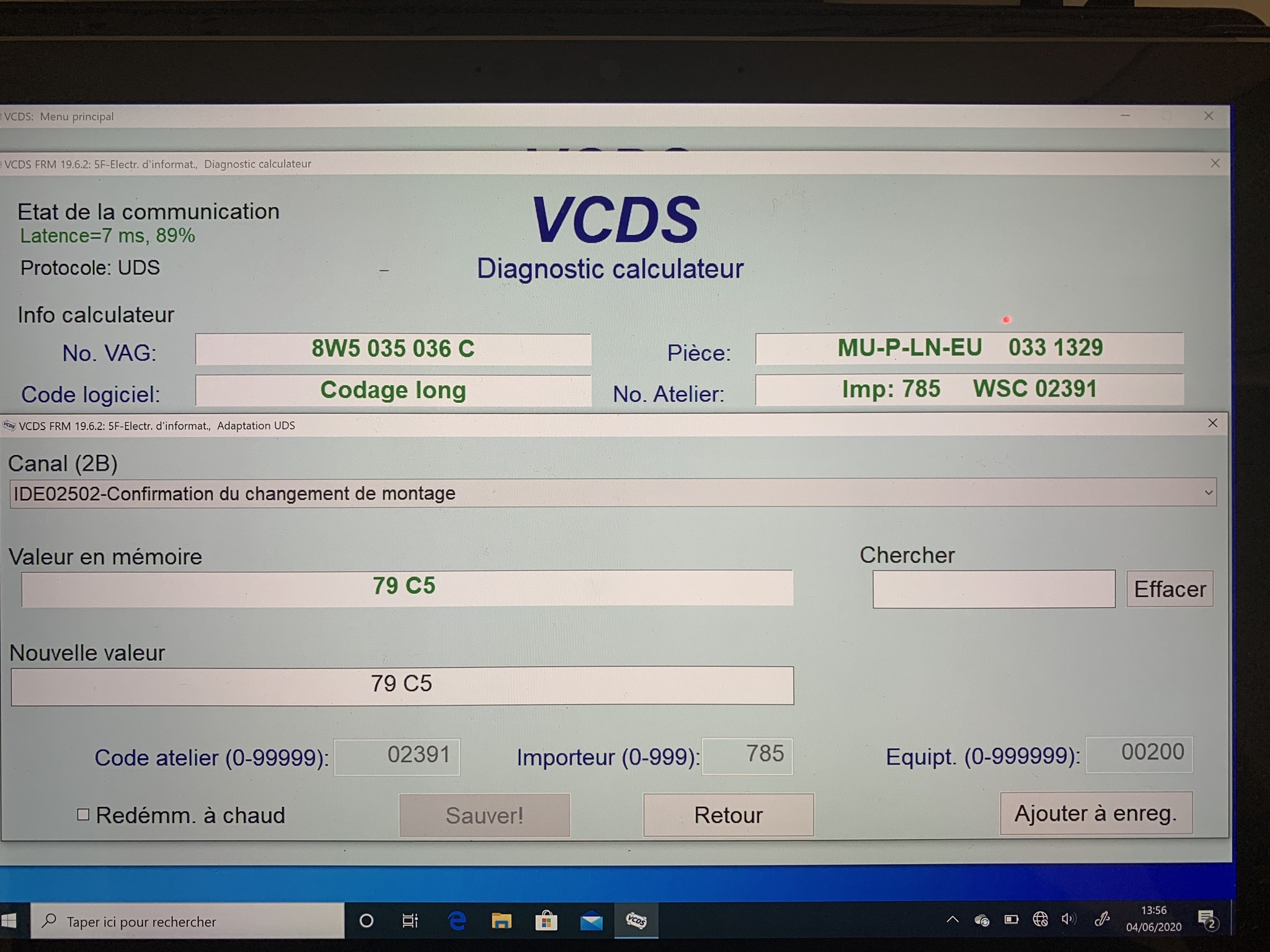

Normally after the updates, the SVM (Software Version Manager) must be validated
The system will throw an error: 1555 - Check Software Version Management that is permanent and is not deleted.
To solve this, follow these steps :
We enter the 5F
Adaptations
Confirmation of installation change
We copy the value it shows us (XXXX)
We use a calculator that has XOR (Bitwise calculator for example)
In hexadecimal we put the value we have.
We give XOR.
We put these C9D2 values and give the = symbol to calculate it.
The value you put us, we put it in Confirmation of the assembly modification and We accept.
After accepting we will see that the value has not changed with respect to what we had at the beginning. IT IS NORMAL.
If you do it with VagCom leave a space in the middle. (XX XX) by putting it in again.
Once done, redo the Scan and erase the fault permanently.

what value should I put in my car?
Jun 6, 2020
I don't understand anything anymore! what should I do in my case
Bitwise calculateur
Number 1: 79 C5
Number 2 ?? ??
Bitwise operator
AND/OR/XOR?
Résultat?
Thanks for your help
Bitwise calculateur
Number 1: 79 C5
Number 2 ?? ??
Bitwise operator
AND/OR/XOR?
Résultat?
I've calculated it for you, 79C5 XOR C9D2 = B017 (B0 17 has to be entered in the new value field) the 0 is a zero.

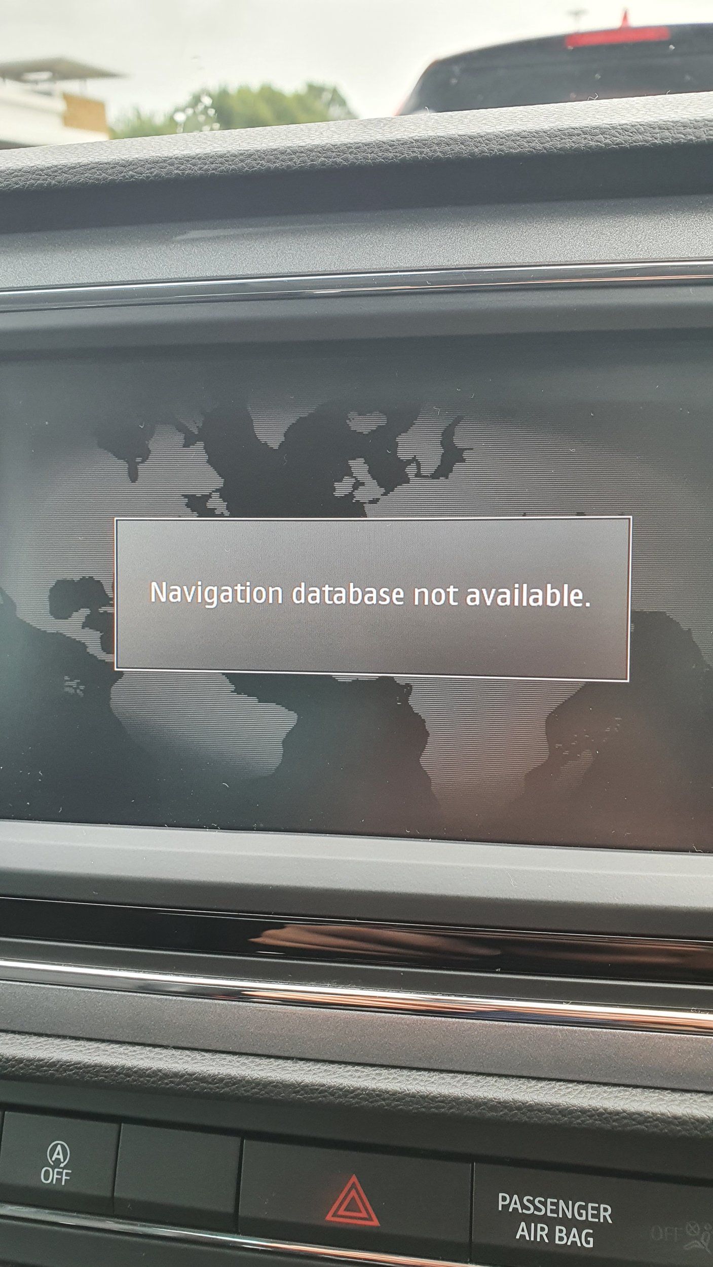

Hi everyone,
Was wondering what unit do I have? Mib1, 2 or higher?
Looking to sort my navigation and try a new sd card before I start digging deeper. The new card that dealer gave me doesn't seem to work, original was lost by previous owner. With my current sd card (Seat Navigation AS Europe V7) I get a message "navigation database not available".
Trying to understand whether navigation needs to be activated by dealer or I should try buying a new card first. System says navigation n/a but surely it's equipped with one from standard.
Any help will be appreciated.
Cheers

Hi everyone,
Cheers
Mib2 low

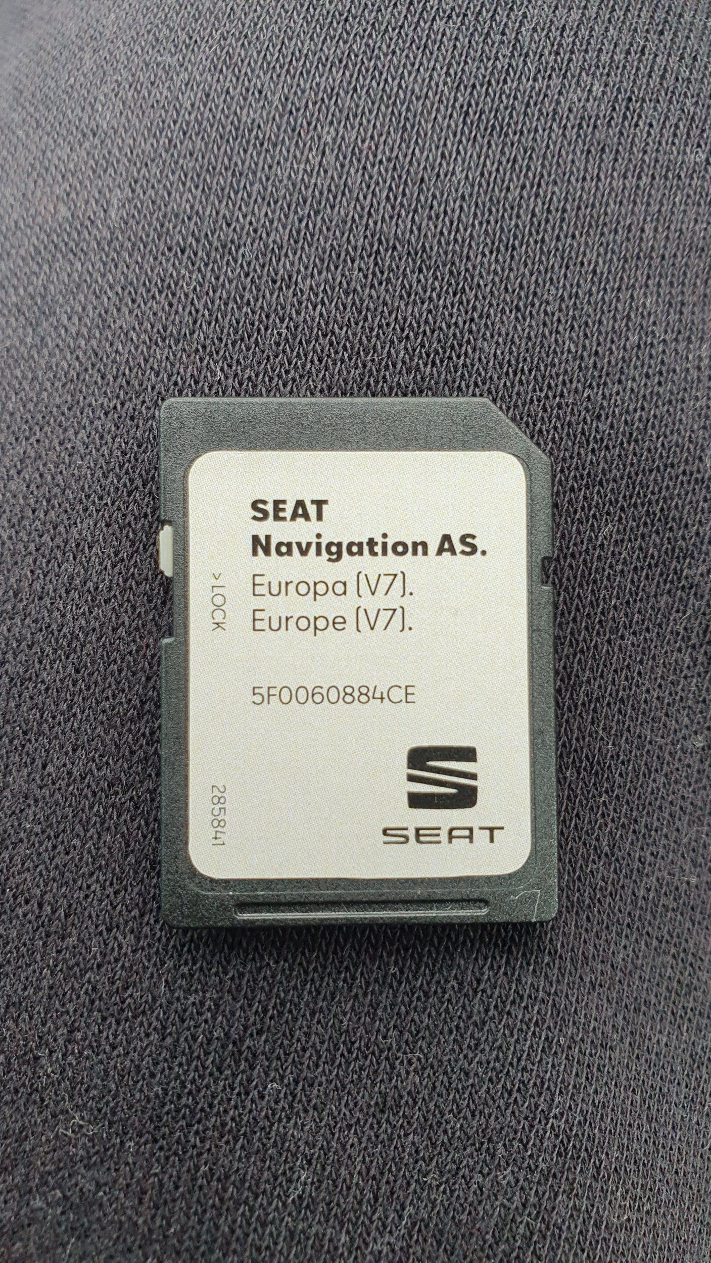

Thanks.
I have attached picture of my current sd card that I was given as a replacement for the missing card. System information says that navi not available. I did think to try buying a new sd card to see whether it will work but not sure which one to get

Thanks.
Maybe the forum experts on this @Tell & @Walone will swing by, just be patient.
Or you could tell the "Stealer" it does not work I guess

Tell
Full Member
That is indeed the latest link since VW has changed their web address but not the solution to the problem since the unit is locked to an overall.nds file so you need that file and the V1 overall.nds file which is good for all releases beyond using the "workaround" method.
There is a post I did on the main navigation thread which covers lost and stolen cards how to get back your system.
See post 2151
Get the V1 version of the Mib2 standard from the Skoda servers. That has your overall.nds file in it which will work with any subsequent release whatever your Mib2 standard unit is on else you will spend a long time on trial and error trying to find the release that matches your car. Use a PC not a MAC or follow the Mac guidance.
Then follow post 2075, key to all mib2 standard map update screw ups. See under Lost, Stolen and Missing Cards from a Mib2 Standard Unit
https://forums.seatcupra.net/index.php?threads/navigation-system-updates.388586/page-104
Enjoy.
Replied above :). Just use the card you were given but follow the instructions to action the workaround or alternatively as you say get the dealer to put it on their system and re-register the card but if Blue Frost wants to be able to do the map updates themselves then they need to master the process or cough up £120 or something every six months or when they want a map update. This has just got the first extra step of getting an overall.nds file that works with all subsequent releases which is the Seat year one of Mib2. Normally you have that as we all know :cool:... unless you are one of the people that deletes everything on the card without backing it up, or loosing the back up. Then you either find the release that tallied with what you had or use the universal solution above of downloading the Seat V1 card which is then good to go with the workaround.
