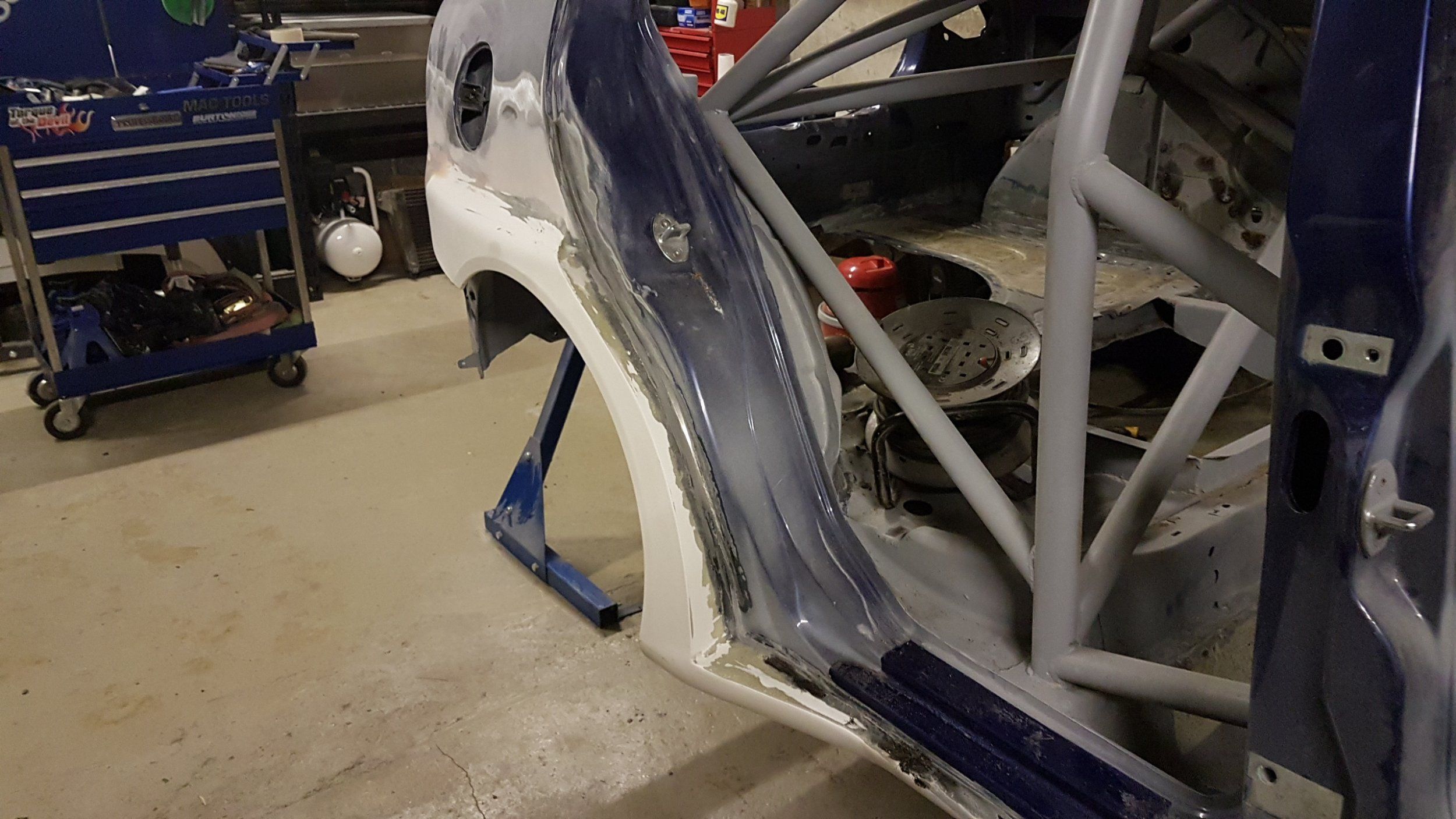

Nothing wrong with toledos. Not when they are btcc or there spare bits
Toledo btcc rear arches
