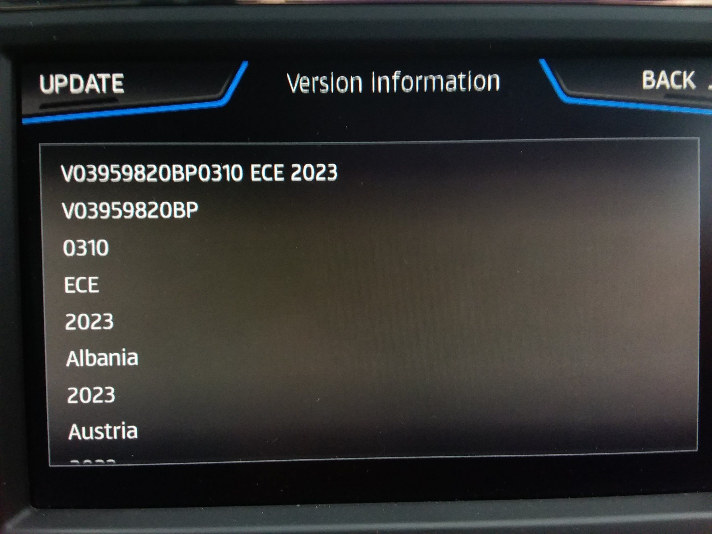

Normal success screen:

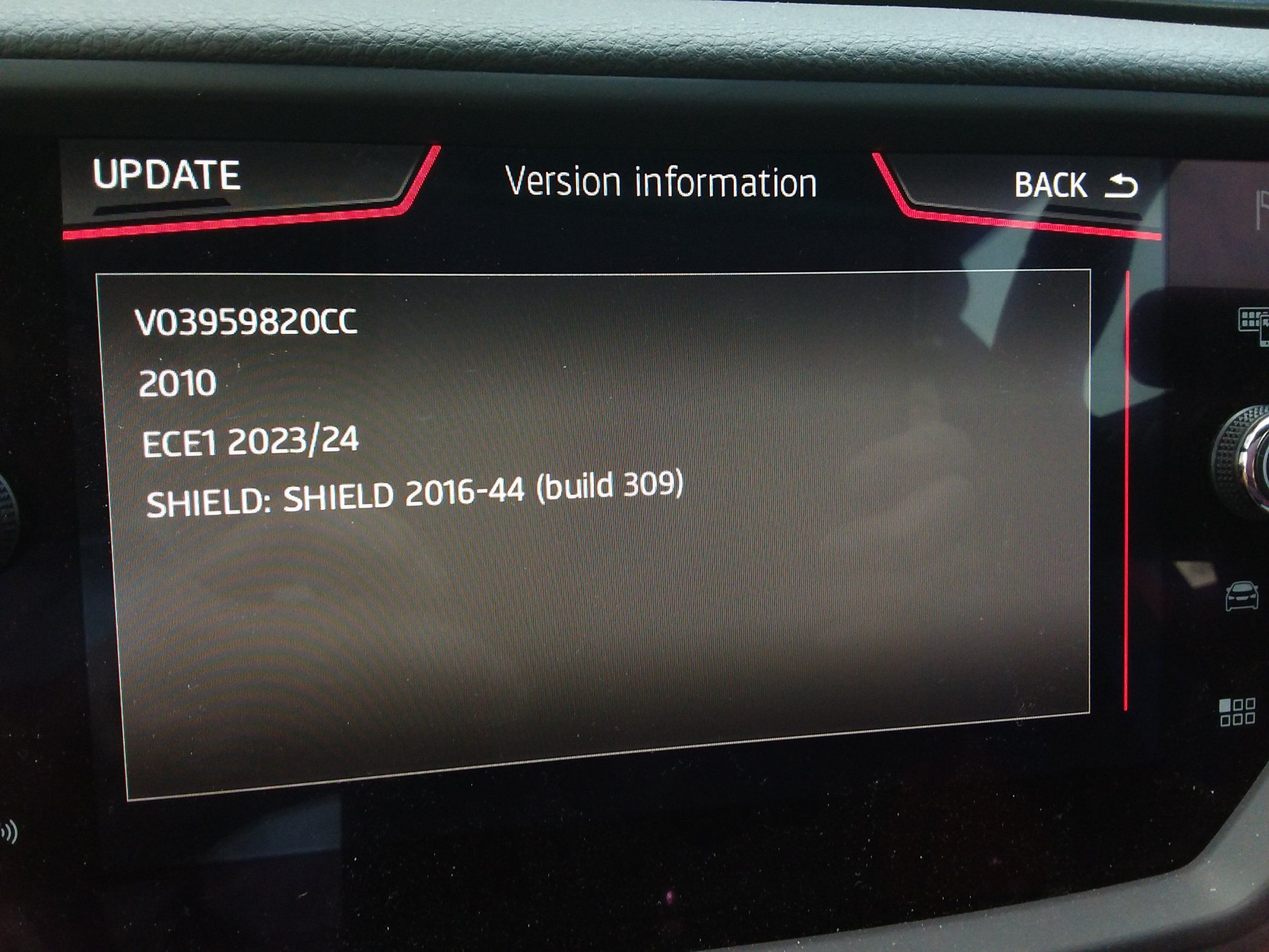

Normal success screen, ECE1 in this case:

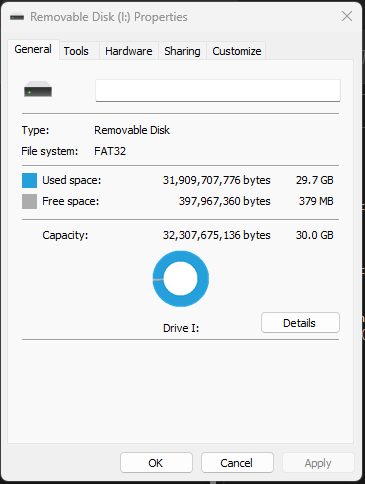

Today I managed to update my navi maps, using the second link. Downloading and unzipping went fine. However, problems came when trying to copy the files to a 32 Gb card: all files didn't fit, 10Mb shortage. Second 32 Gb card: same problem, but larger shortage. Both cards were used for previous updates.
What to do? Buying a new card seemed a gamble, so I took a larger card, a 64 Gb microSD card. It was formatted to exFAT before and contained a large video file in it's own folder. I kept it this way and just copied the navi files to the root. And this worked!
It only took about twice as long to update as previous updates. Could this be because of the exFAT file system?
Anyway: Thanks again Tell!!!

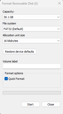

It could be.... I answered a similar question on the Briskoda board since they are experts (well some of them) at messing stuff up. ? They go off piste and take the high road.
The 32gb card should / can be formatted with a cluster size of 16 kilobytes in Fat32, that gave me 398 nearly mb free.
If the allocation size is too great the indexing of Fat32 eats the space. NTFS you can't do on the 32gb cards for the same reason. Also there may be variation on what you can get out of these cards. I did also notice that formatting in Windows 10 / 11 could default to a silly size unless you altered it. This might be a bug that Microsoft have now fixed.
Class 10 cards takes about 40 minutes or so.
Note this conversation of formatting cards is only for Seat Plus / Mib2 High.... never reformat a Mib2 standard navigatiin card - that's been known to kill the card. Don't fiddle with the allocation size in those cards... likely to end in tears. 4096 is that allocation size for those cards and should be put at that if it gets altered by accident.
Ah, I see. I will try this formatting settings on one of the 32 Gb cards with the next update, that will probably be somewhere mid 2023. Thanks for the advice Tell.
I had the same problem when I updated my maps last Sunday, had to use a new 32gb card (which I already had), 2 of my old 32gb cards did not have enough space. I checked them for errors but non found.
