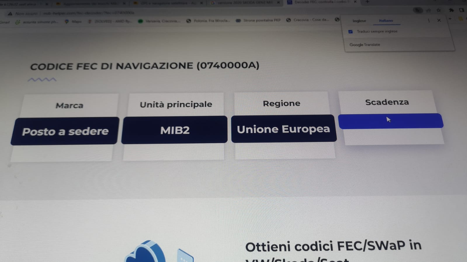

ciao a tutti la mia non ha scadenza?
Yours is a mib2 standard, you follow the workaround instructions.
Follow workaround below.
