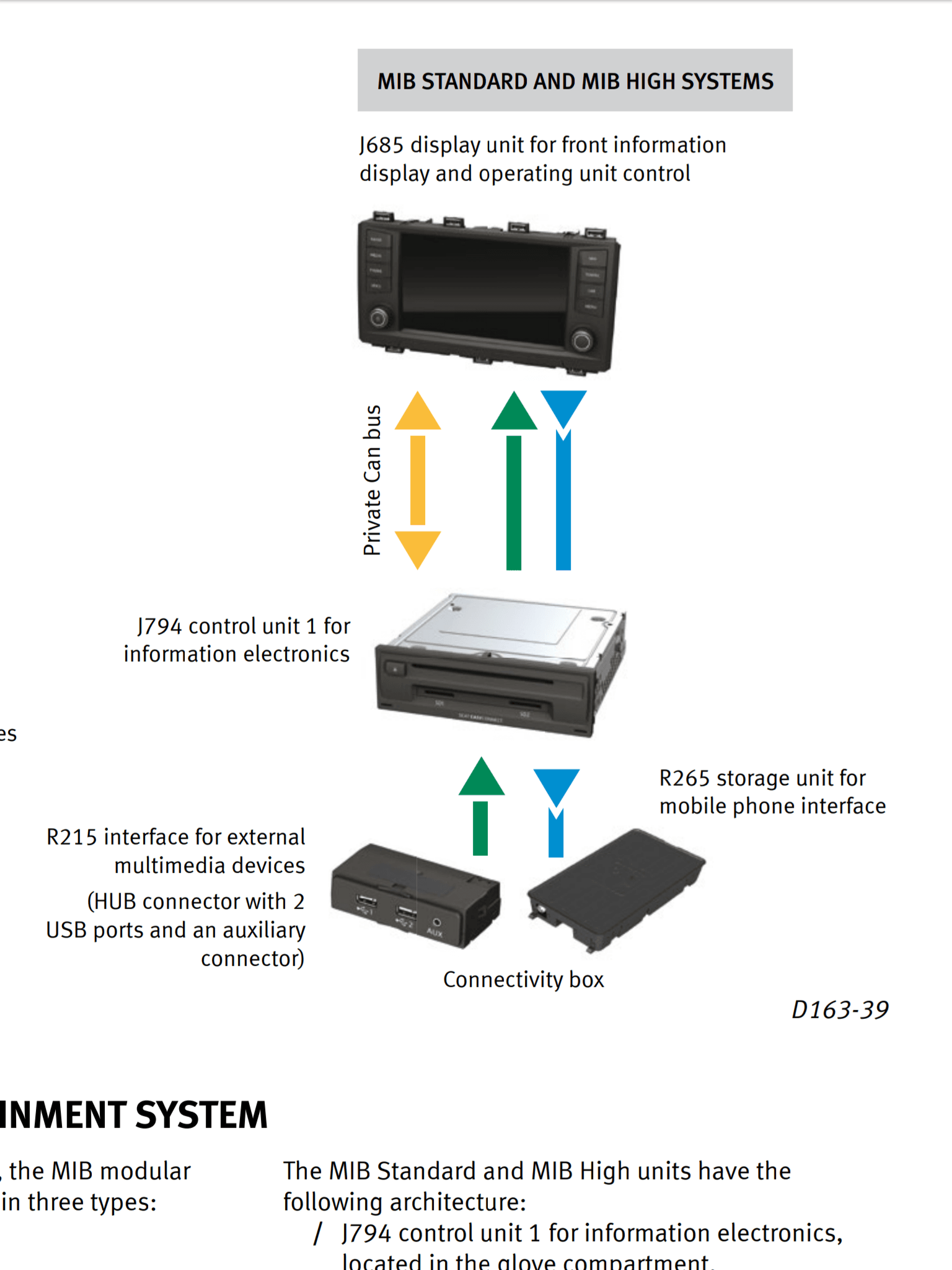

You could check the connections at the back of the mib2 unit to see whether they are loose, the link to the original guy where I was talking about the key device to release the unit to get behind it. Also the screen. Recent Ateca thread where someone had a smashed screen and changed it themselves.
The touch and buttons on that pass the commands to the mib2 box. Any defective parts in that will also I guess lead to issues you see. Toledo may have a "connection" box. Diagram from the Mib2 Ateca suspect a defect in the USB connection box wouldn't give you the problems.

Please explain what MiB and FeC stands for an what they are. I think MiB is the so to speak operating system of the onboard computer, right? All that shows up in the car screen is the operating system and it's called MiB, is that it? What about FeC?
FeC is the feature enablement code. It's like a 4k television being sold as 1080, but if you had the FeC for it you could turn it into a 4k. They don't make Tv's like that but VW make their Mib units like that. Way of licencing features.
This link shows you how to access the FeC menu... I've tabled the mib2 high navigation ones there, yours are standard ones. There are FeCs that enable AA / Car Play most cars come with all FeCs turned on these days for other than Mapcare.
That link was really for people with mib2 high who had bought Mapcare / or where a retrofitter professed to have changed the FeCs but hadn't. Early issue with retrofitters and mib2 highs. So we can check up on their work.
MIB are German initials for modular infotainment unit. That's the series of the unit. They get revised on a 5 year cycle. RNS before. MIB1 went to 2015, MIB2 to 2020. MIB3 2020 on. Guess MIB4 for 2025 models.
