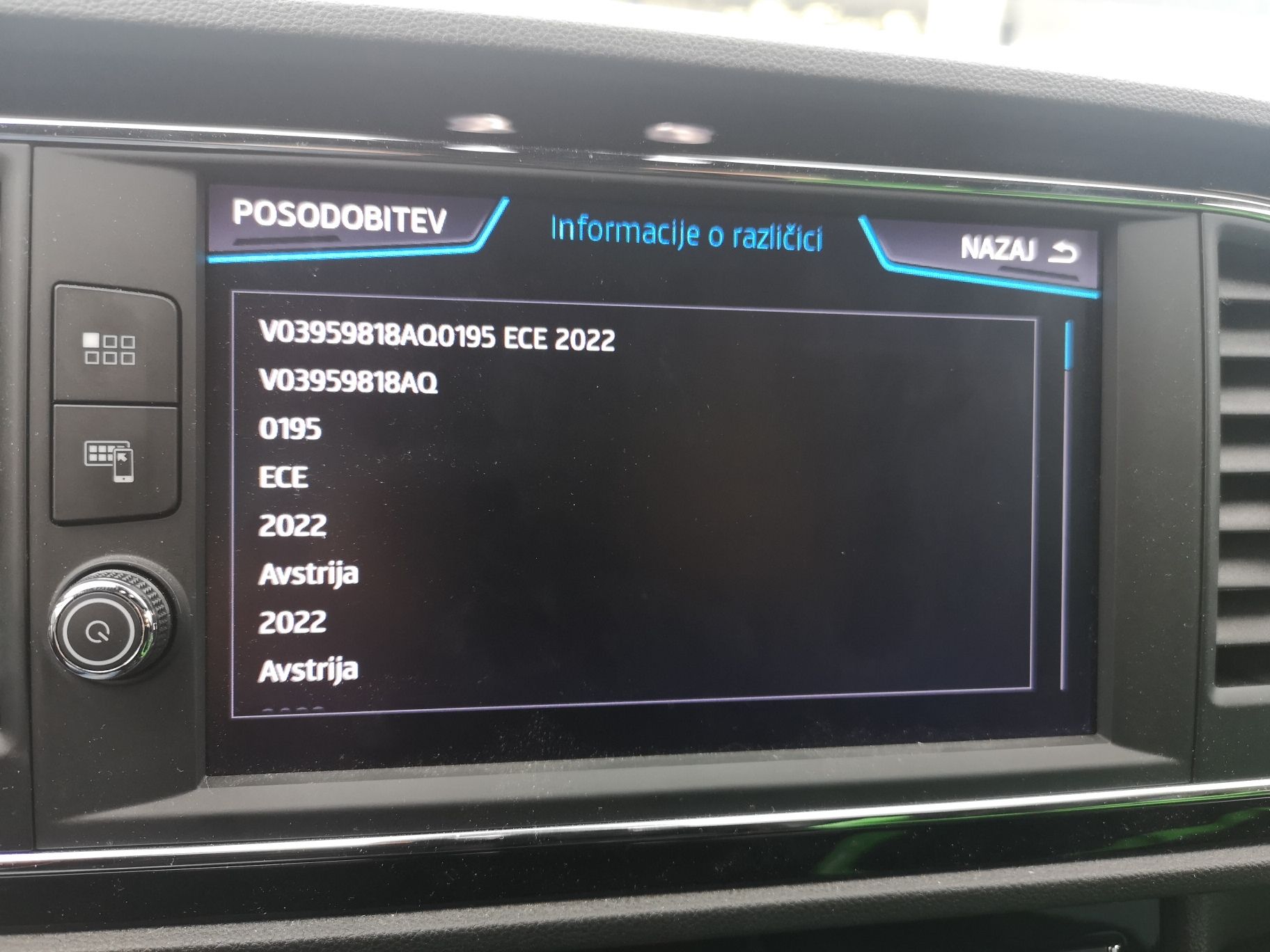

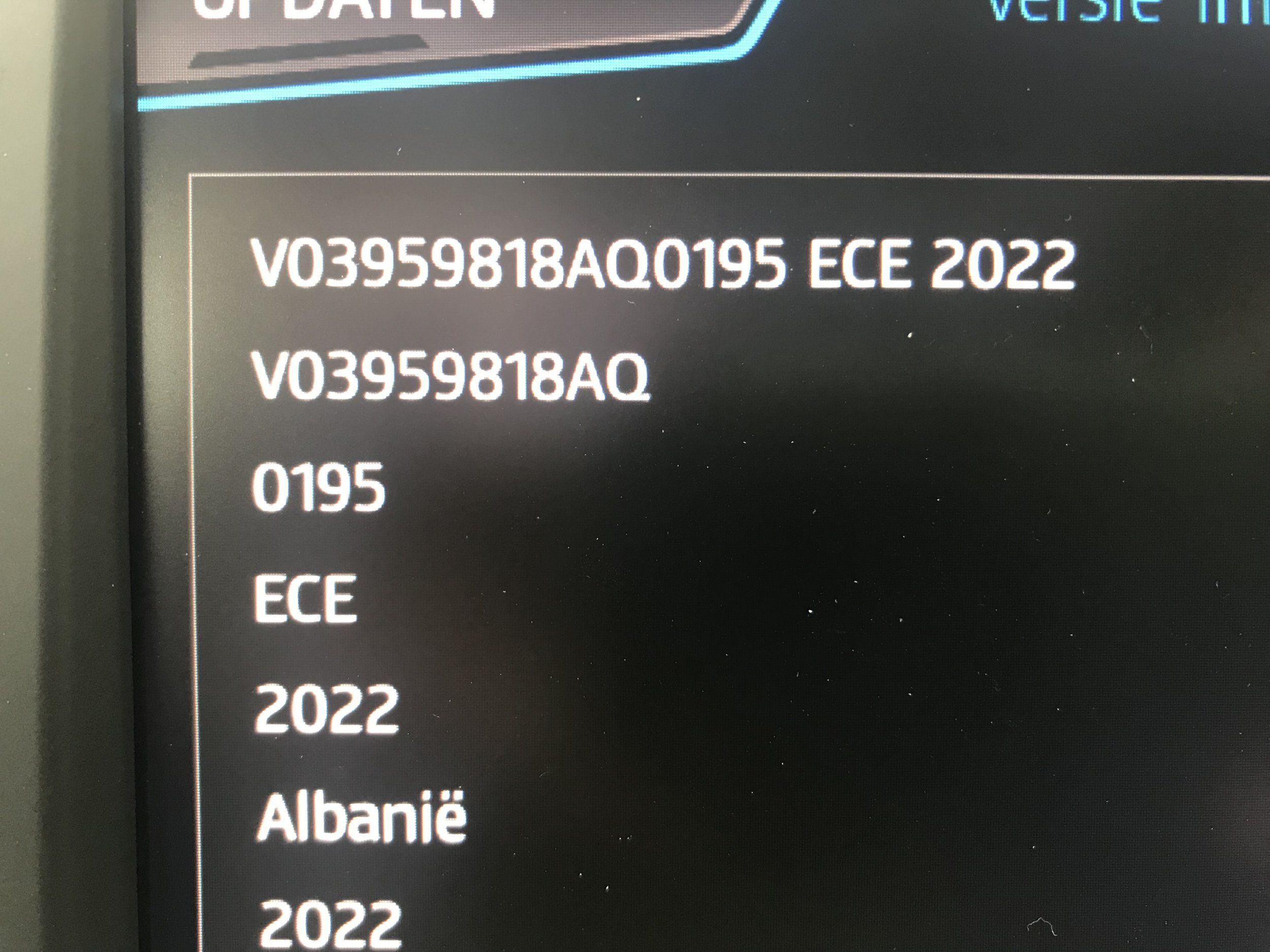

Today Im try update maps to 195 but looks like something is wrong... It update from 0% to 100% in around 15-25 minutes but then stuck at 100% for more than 20 minutes and then I need to leave car... I use same card as allways(SanDisk 128GB Extreme PRO 95MB/s) Will see what will happen when I will came back after work(I know that normal update continue from where it has been stopped)...
Fingers crossed. I always update mine via the developers SWDL menu so I've never seen that screen. The SWDL you see what is going on although it must have continues power to the unit else you are back at square one. The normal method as you say pickup from where it got to except it unwinds back a bit. Yours may have unwound a fair bit. Normally it completes in about 50 mins. It could be that with the unwinding bit after stopping the car it will get there...
I recall that mib tool which you now have unlocks the developers menu normally this is done via Odbeleven / VCDS etc. You keep pressing the hold button till two screens open up. First is the normal one with the FeC details keep holding then a second one opens with the SWDL menu on it if that's been enabled. You can use that one but you must open the door every 15 minutes else if it loose power in the next 5 minutes, you have to repeat the whole process. Advantage is you get to see the progress and you get use to reading what it's doing.
Mib2 high units fully validate the contents of the card via the SLA1 signature so will not import into the car a corrupt card so it is unlikely to be that. You do still have those interesting FeC issues as you reported on the software thread. Might be back over on that thread you need to go where the experts are on the unit. It is troubling that they somehow got into the unit via your dealer / workshop then replicate into additional once mib tool did it's work. One for @jpmedia over on the software thread or any of the others, on the other hand it could be your unit needs a little longer to run on the update and may well run happily. I've never come across invalid FeCs, they on the other thread will have done. It's something very odd that has happened.
Reactions: _Dejan_
There has been strange issue with update when it stuck at 100% and next time I start car and check version it show me that I have 2022 maps installed but after scrolling over country versions unit reboot itself. Then when I again scroll over versions it automaticly start upgrading maps which I need to interrupt with turning off car and go to work... After work I had 2h trip and Im first try if navigation work and it normally navigate. Then Im update maps again to be sure that they are really updated in one piece and it need around 40-50 minutes to go to 100% and then after 1 minute show update sucess dialog...
After that I think that maps are updated...
Most of time I use Android Auto(Wireless) for navigation because it have good traffic informations but somtime my phone battery is not charged enought(Phone power usage is more than wireless charger can provide) to run it and inbuild navigation is very usefull :)
Thanks for all help and time to solve upgrading maps issue...
Reactions: Tell
Yes it is updated :)

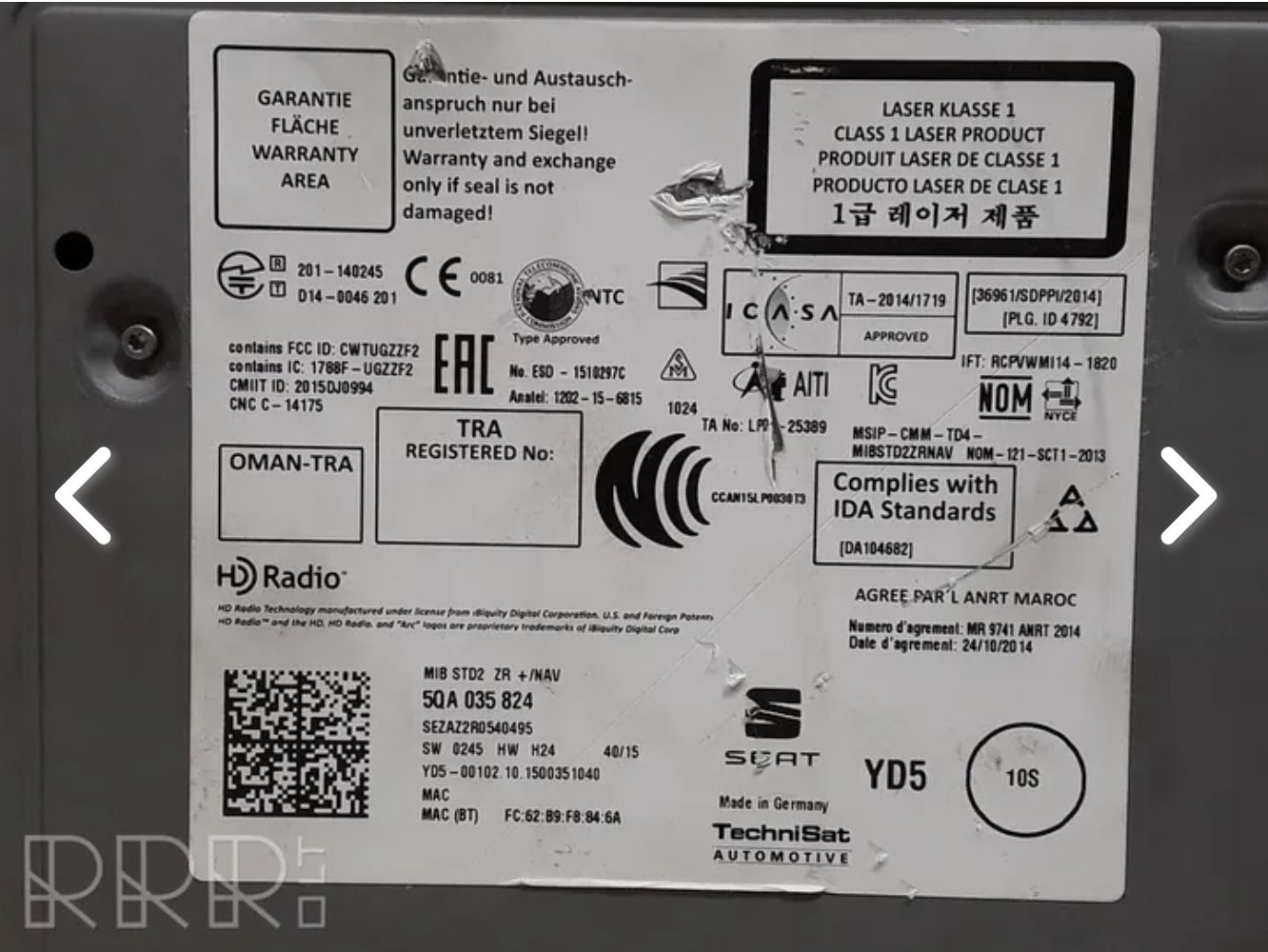

Hello, anyone know if I would be able to update maps on this one if I swapped this control unit instead of mine? Thank you
Two things going on here, it's a mib2 standard so yes if you managed to get it installed you would be able to until about 2025 when it's thought VAG will stop putting out navigation updates. The main issue is those unit picked up off a scrap yard or whatever need to have their consumer protection taken off, navigation re licensed and you'll need the leads if it's a mib1 in at the minute plus any control panel to replace what you have. This is where decent retrofitters make it easy by prepping the unit. The other is a DIY project with pit falls there are plenty of threads on the net on that.
Thank you for the answer. It costs 80 euro and its from 2016 make. So I am considering buying it. I wonder what else I could unlock with it

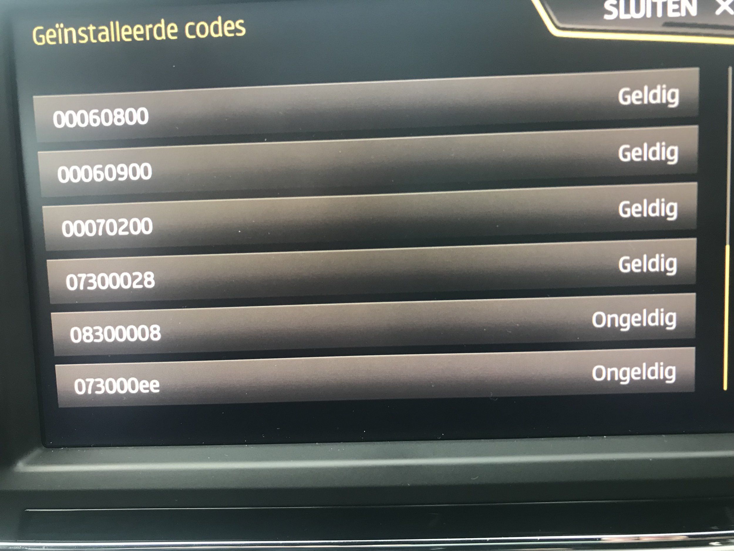

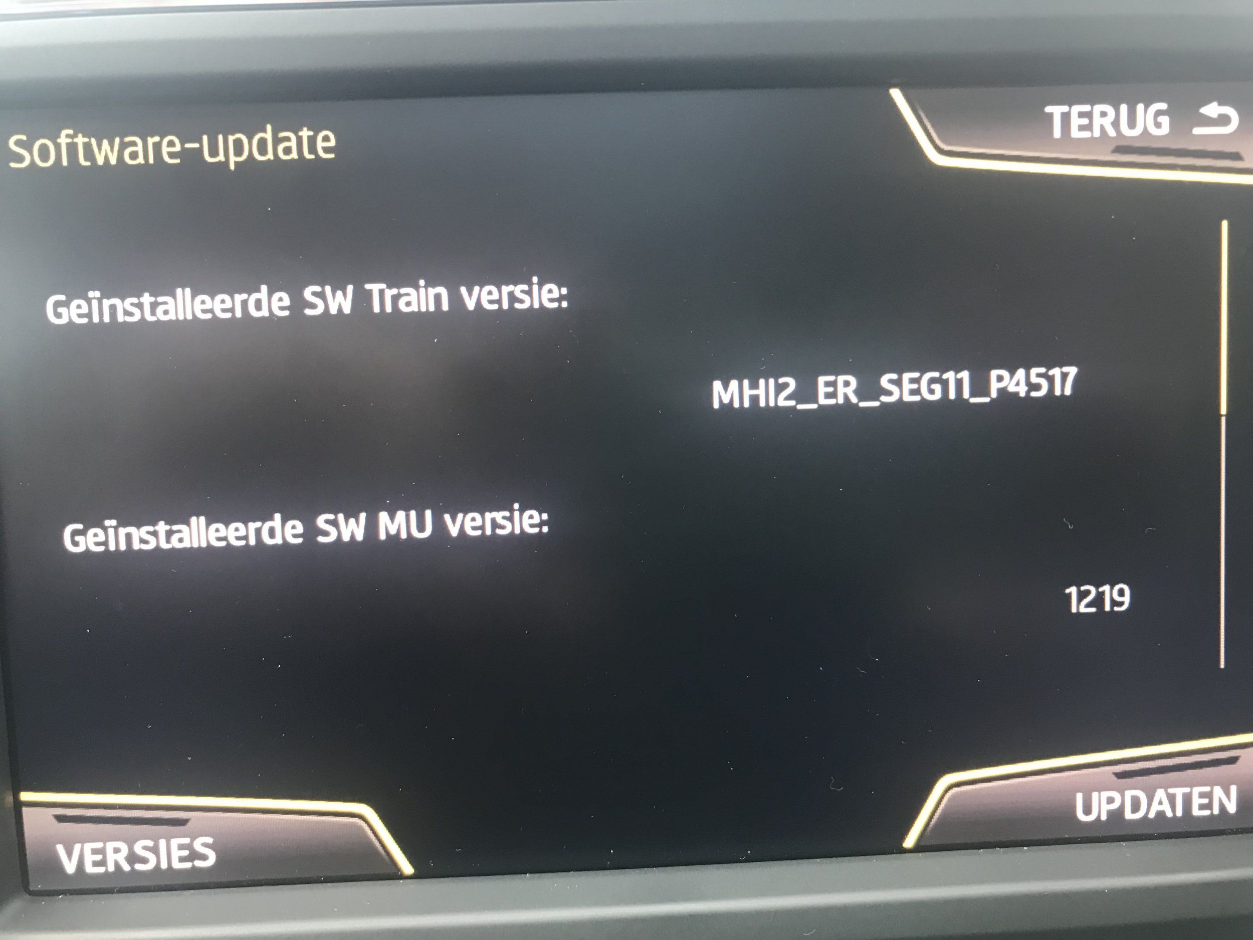

Dear all, as fresh board member I need some last final advise to update my firmware. I have take the different steps with MIB tool in order to install the new 195 map on my 6PO nav in the Seat Ateca 2018. The system recognizes the new map but after a few minutes it says it is not a valid map. Apparently the FEC code is still invalid and I'm still using the old software. See attached screen shots.
1) how can installed the latest software?
2) how can I upcate the FEC codes?
I already followed the steps with the MIB tool which worked without updating the software FM2-H-N-EU-SE-MQB, FM2-H-ND-EU-SE-MQB
Reckon that one for @jpmedia
Thanks! I have OBDeleven following the video I watched on Youtube. That will be a first step to solve the issues.
Did it work ?. Perhaps better look at that for future reference.
Mib Tool should be plug and play on the firmware release its supported for, so if it didn't work it needs the experts in it. It substitutes one piece of code for another and then should just work once the instructions are followed. If however a retrofitter has had their fingers on it so not stock firmware in that module, it may not. That's where it needs having a look at. Where @jpmedia comes in to study the backup you made. That will show the sins of a retrofitter and how it can be fixed. That's how the last one was fixed on the thread which had a FeC mess in it.
