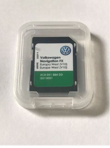

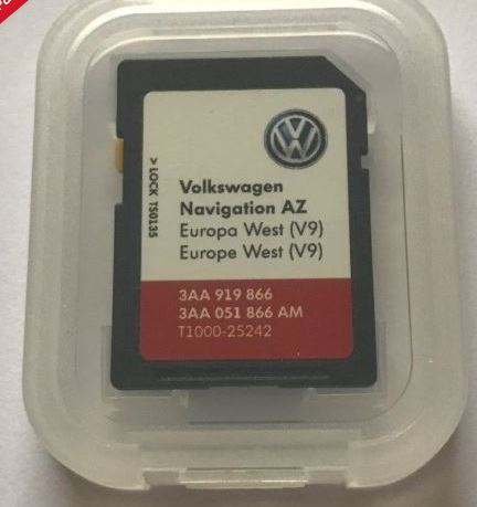

OK I will read through again.... Just been looking on ebay again and I found these below
Would they just slot in ?

Let someone else answer since I have the Navi Plus. Whenever people try cards they get adverse results. There are upgrade cards which allow you to upgrade then only cards which are only meant for dealer installation via ODIS. People are happy to sell you those as well. Mapcare which isn't currently available on Seat UK sourced cars allows you to upgrade yourself which is far more sensible with a token initial price, like £120 which is now waved by VW and Skoda, but here in the UK Seat haven't budged an inch even thou they are selling cars with digital dashes with maps out of date... or will be.
If you already have a working SD nav card in your system then you do not need a card from eBay!
Just follow the procedure as mentioned by Tell. Just make sure you do a full backup of the original card!
Also I think you need to use a PC not a MAC.

Yeah I was just thinking if might be less risky and more straight forward than messing with the original card. I don't mind paying £30 just not £140 or whatever it was
Also just wondered when I looked at the box the card came in from the garage its 2009 - my car is 2016 - Is that normal or have I been duped somehow
