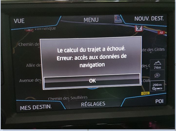

Hi, regarding this version 1030 (Version Tiguan 2016). With my Leon 2015, i have the message "control of navigation data error" and i cannot start a destination, when i define a location, i have this message. Is anyone also have this message ? Maybe, if I download a v1030 Tiguan 2015 for example, could it be change something ? Do you think, there is a difference between v1030 Tiguan, or Golf or other type and year of VW car ..?
