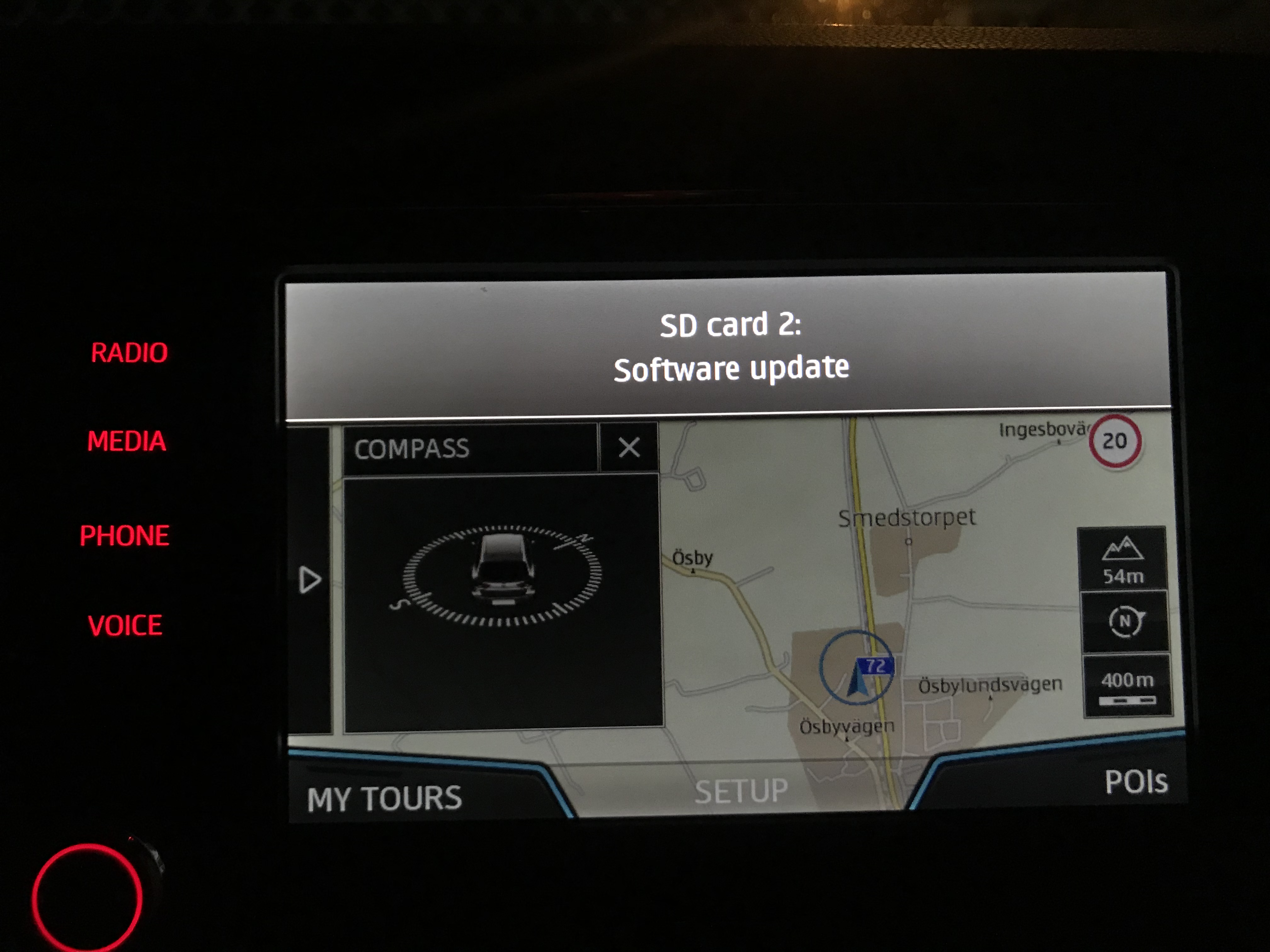

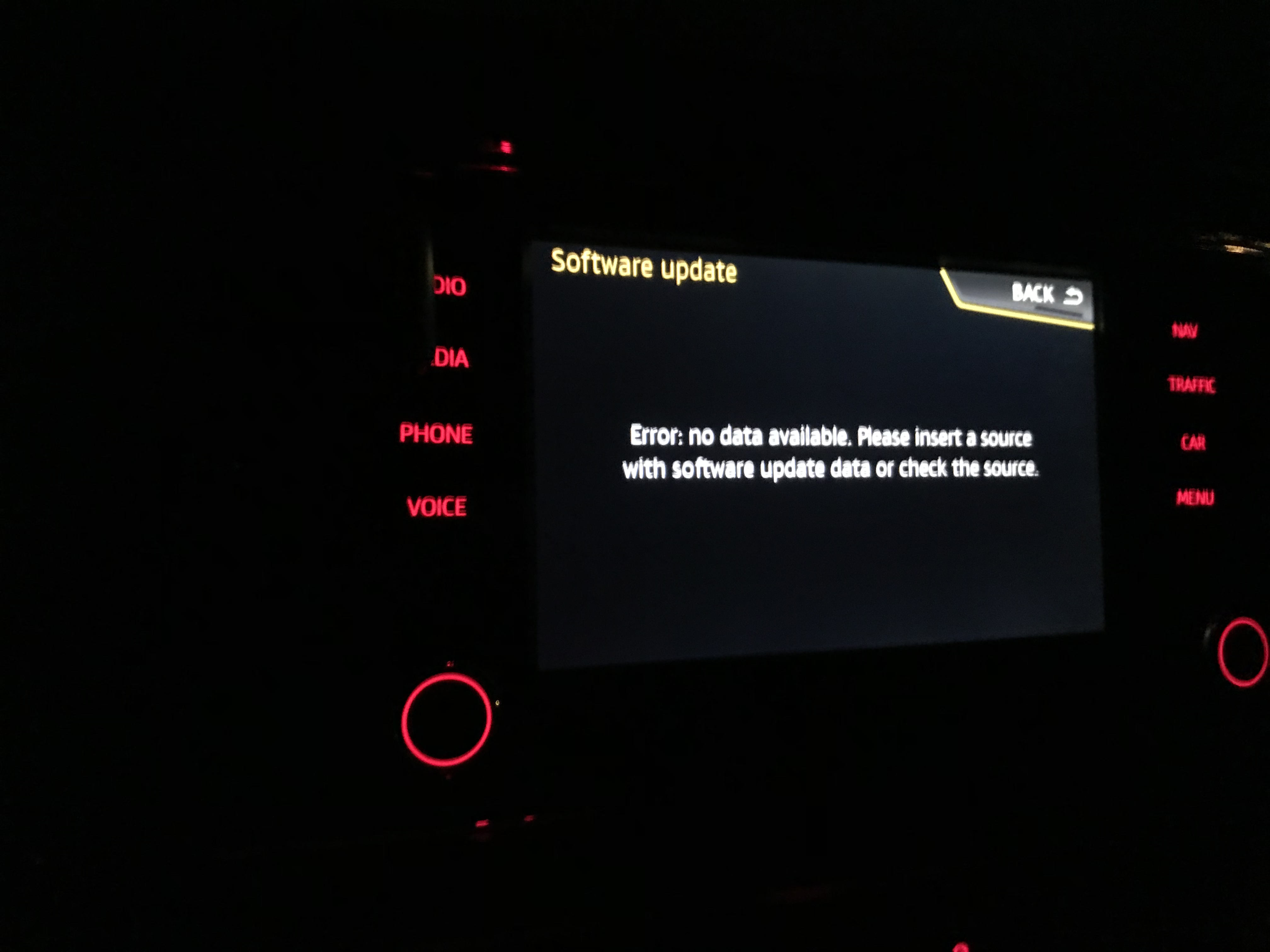

Hi guys. Why am I getting this error message? It clearly finds “software update” on the card.
I have a 2016 Leon Cupra with sat nav media plus and never updated it before.
I suspect you don't have Mapcare and you have done a download and popped the card in ?. You said 2016 Leon is close to 2015 when models could have the Mib1 in. Worth checking the unit installed by pressing a few buttons as described on this site:

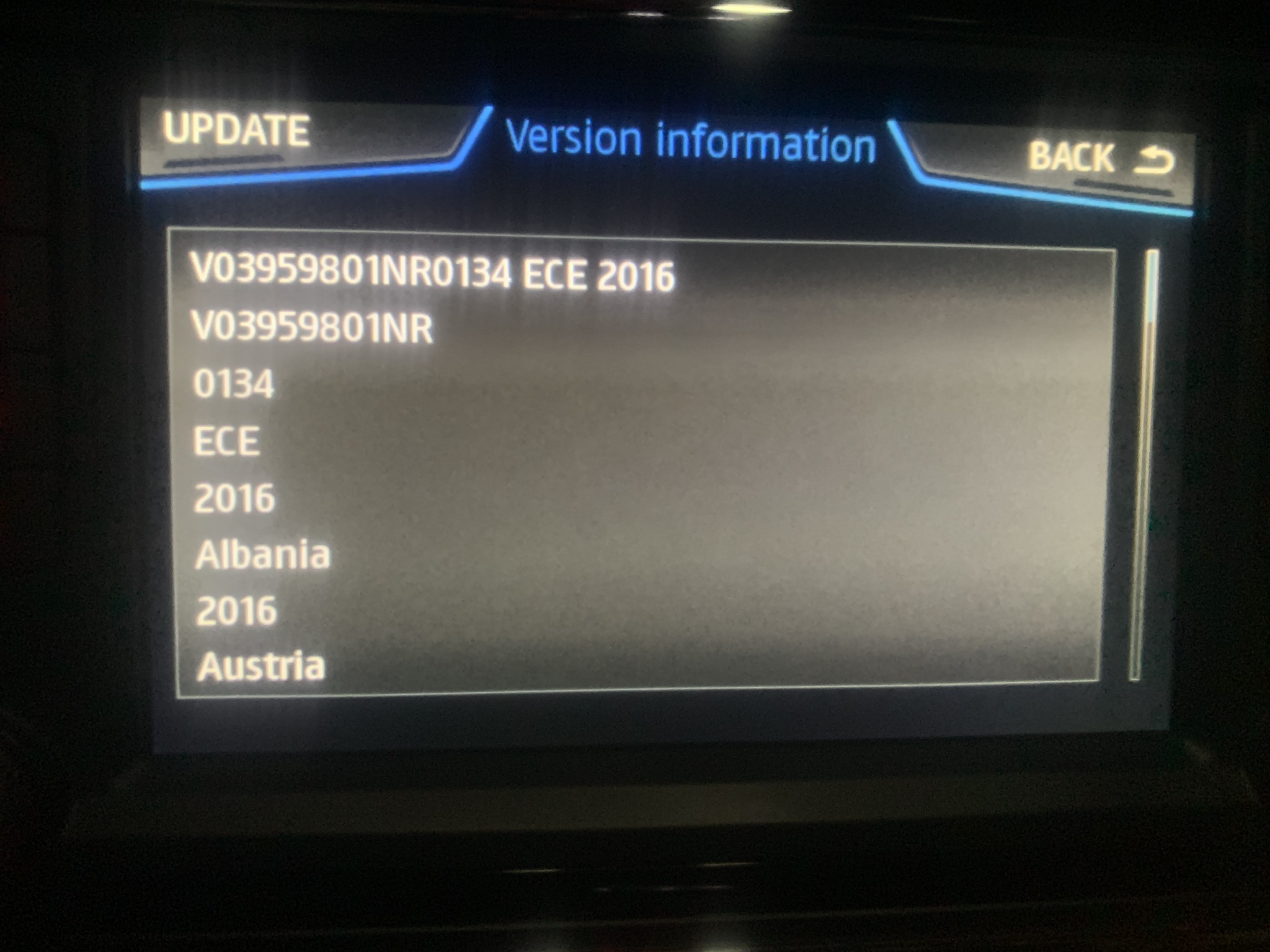

Thanks for replying. Car is a 2016 (May 2016).
I do have map car and the unit is the one with the built in hard drive (Navi System plus).

That's like mine but I didn't have Mapcare. Wonder if the three years is up ?. Did you ever do the update before.
They are fussy in the file has to be in exactly the right level in the directory. Then you have the Mac issue of those extra characters getting placed in the file which then fails in the read since the file is signed and fails the check. Not using a Mac ?. I don't how this one presents itself via the front screen since that was never available to me.
You see a lot of discussion on VW boards about MACs. That's why they released the DiscoverCare package. Worth trying that. There are utilities you can use with a MAC to clear out / byepass these characters.
Not using 7Zip but the internal Windows one can cause errors if you are using Windows. That's why VAG recommends 7zip.
There should be nothing else on the SD card except the upload. Not getting the directory structure right you see as an issue.

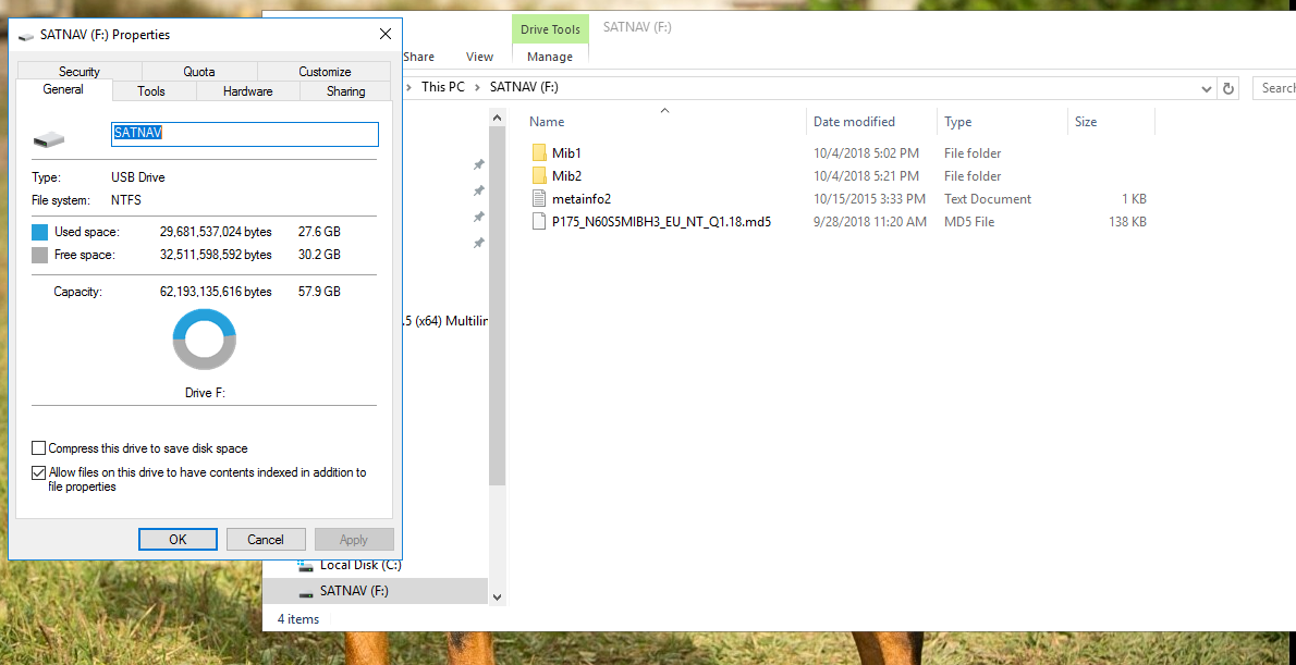

Further to Mib2 High question above, the root of the SD card should show:
Mib1
Mib2
metainfo2.txt
optionally an MD5 file
(they sit on the root)
The latest P175 if you highlight those first three items on properties in Windows has a file size of 29,580,416,063 bytes and size on disk 29,582,782,464 bytes. If these numbers don't tally then something will have gone wrong in the download and unzipping process.

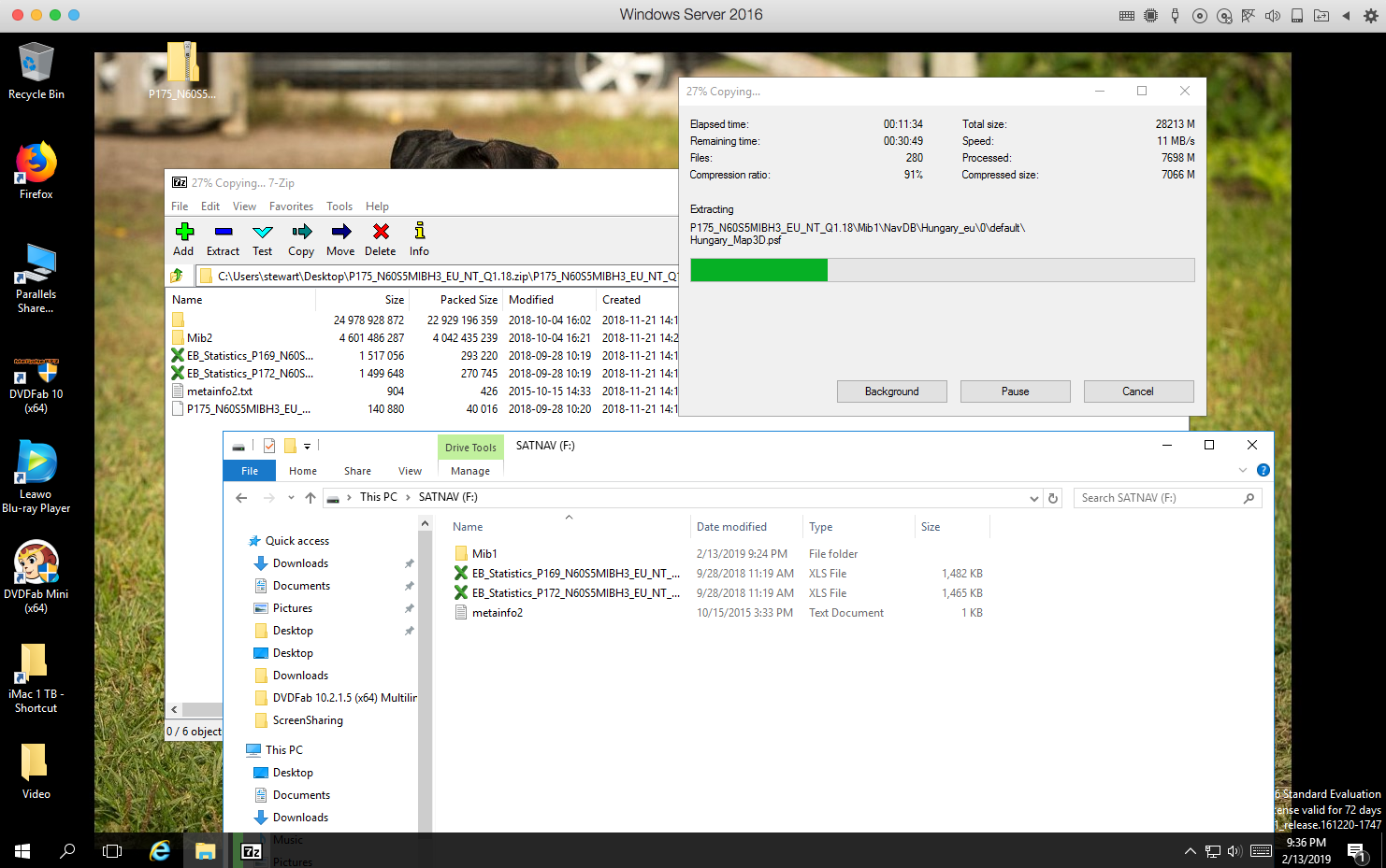

Yes files on the card are where they are supposed to be (see attached picture).
I do use a Mac, is this a problem? 3 years are up in May. I never updated before, thought id do it now before May.

Yes MAC's can introduce extra characters that the import will abort on. There are MAC ways of dealing with this.
Some stuff here, mentions only do it in the Windows box, 1st Sept 2018. Assume that's within the Mac.
https://www.briskoda.net/forums/topic/454928-columbus-nav-update-woes/
Some Mac users turn to a Windows PC for it. Think it's the inbuilt zip program in the Mac that messes it up. Feeling some people then run a clean program but the resultant file must be exact to the original else it will fail.
There are MAC users around here noting that the Mib2 high is more fussy but they will be able to tell you how to get a good Windows emulation. I'd say it's the MAC.
The other way is DiscoverCare that has its set of issues or the Skoda download, that as I recall is a self extracting Exe file.

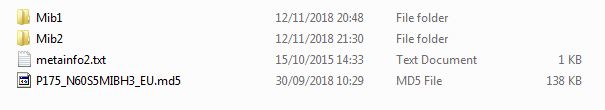

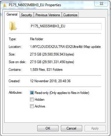

I think Mac is causing the problem, there appears to be 2 extra files in your picture, should be as shown in this pic
with these properties for the complete folder.
They are only excel files with information of changes. I can delete them, though my friend has these files and updates fine. Extracting the files now using Parallels desktop and Windows Server

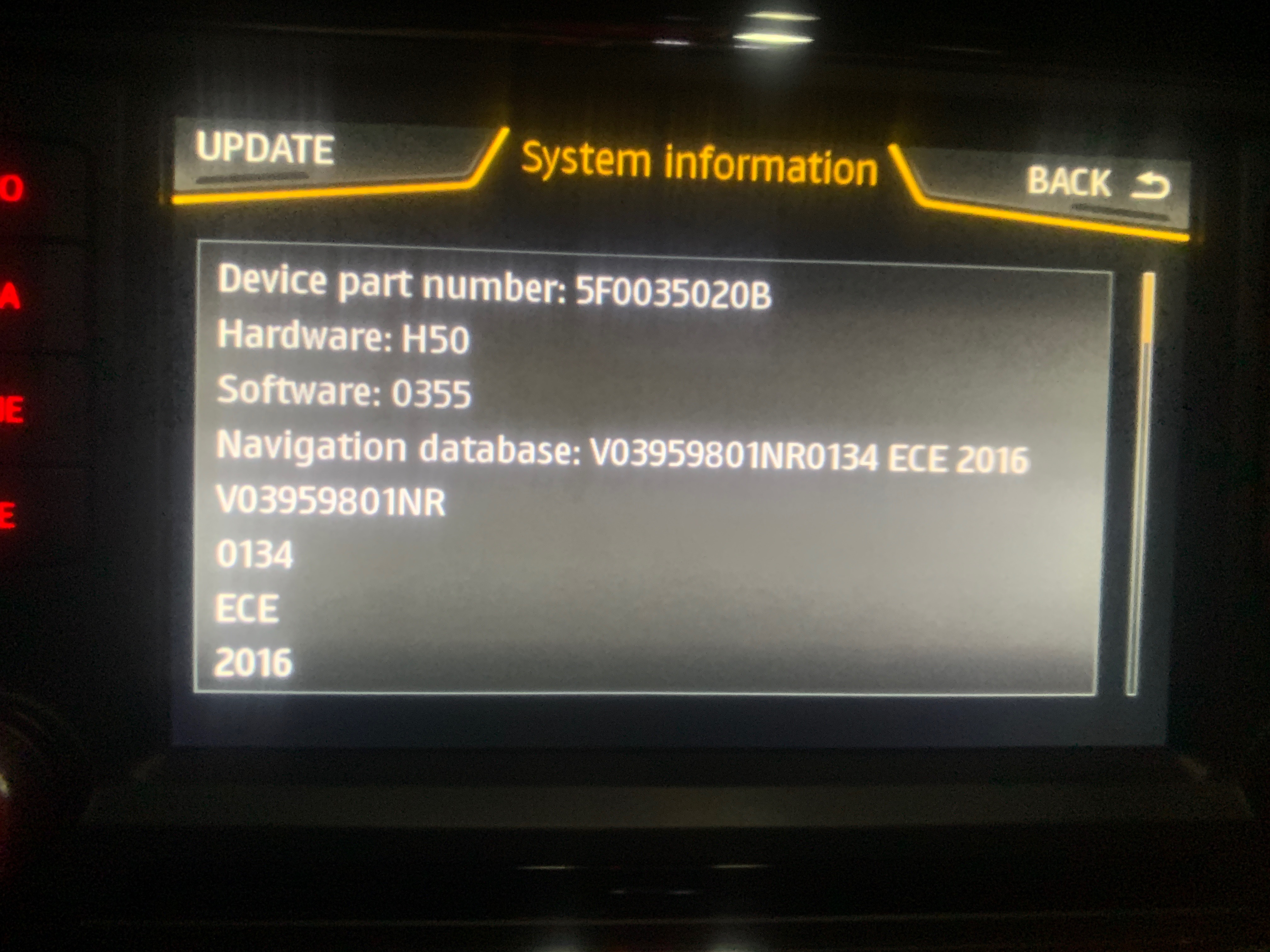

Here's my sat nav info
This is what I ended up with using Windows, I'll try it out tomorrowView attachment 4627
I didn't see the XLS files although that may not be it. Could be. The check I gave above on the file size is for mib1, mib2 and meta file. If there is any gibberish in the mib1 and mib2 directories it will just fail the file size and signature checks. I don't think it looks beyond those three files although you are told not to have anything else in there, Md5 is allowed thou. I spent months looking at these files and certainly they are locked down from edits. Thats why if the zip program adds random stuff it fails why VAG only recommends only 7zip for unzipping.
Ok just did a check with the four file in... still seem bigger than I have. But I'm using FAT32.... That's the other thing they recommend FAT32.
Still you may well be getting there. I'd try writing out as FAT32 next. PC, 7Zip and Fat32, clean SD are the recommendations.
