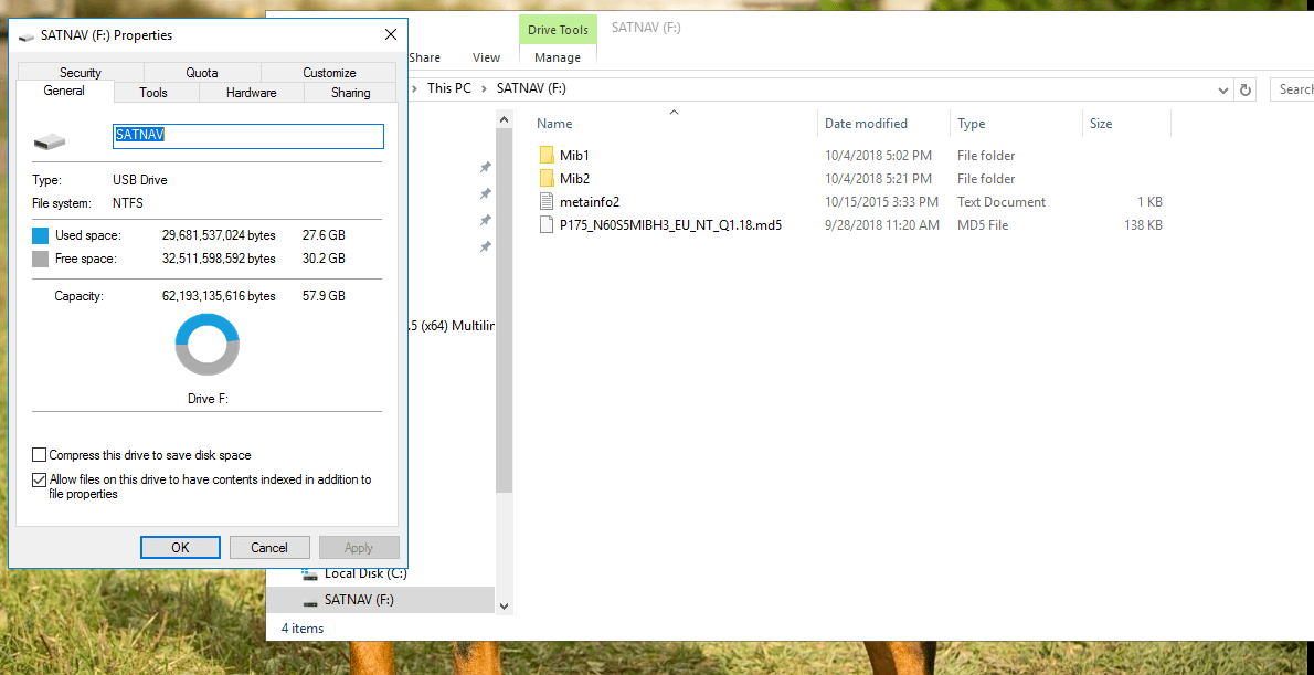

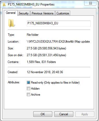

This is what I ended up with using Windows, I'll try it out tomorrow View attachment 4627

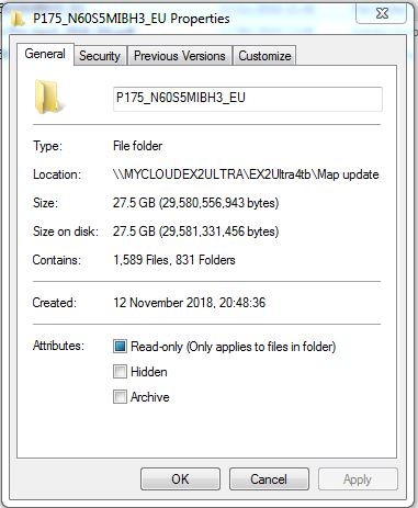

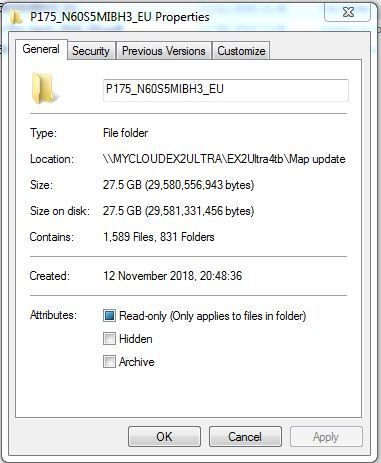

Not sure, but are you using a USB drive to try to update the maps? You must use a 32gb SD class 10 card formatted to FAT32.
Also your file size is quite a bit different to that shown in my picture, and you must have the same number of Files and Folders as this picture shows.
Hurrah. I see you have now done it, posts crossed. Will leave my techie reply still below.

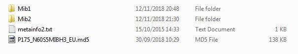

Oh yes and class 10. The byte size of just the Mib1, Mib2 and the meta files is
The latest P175 if you highlight those first three items on properties in Windows has a file size of 29,580,416,063 bytes and size on disk 29,582,782,464 bytes.
As I posted further up and Fat32. The md5 file doesn't have to be present. Some downloads have it on, some don't. So I'd take that off if it doesnt work with it on. You do need the mib1 directory there as well since it it's a combined release for mib1 and mib2 high, it dives into the mib1 directory to copy stuff out as well as the mib2.
If you get the byte size of those three directory files to those I gave above then it should work if they havent released against the 175 release with something else in it if you have Mapcare. Walone and myself were using the same release as I gave in November, should think he's on the same release although we both have modded units and use the backend menu.
I'll post the Fat32 cluster size I'm using after I get up. Its just that map import for the high is very sensitive. Could be at the end of the day your unit hasn't got Mapcare on it.
Walone and myself are using the one I post on 1281 in November.
http://vw-mapscdn.tdd.adacorcdn.com/P175_N60S5MIBH3_EU.7z
I'll check that still tallies with what I have and we aren't talking about a different release which would have a different file size.

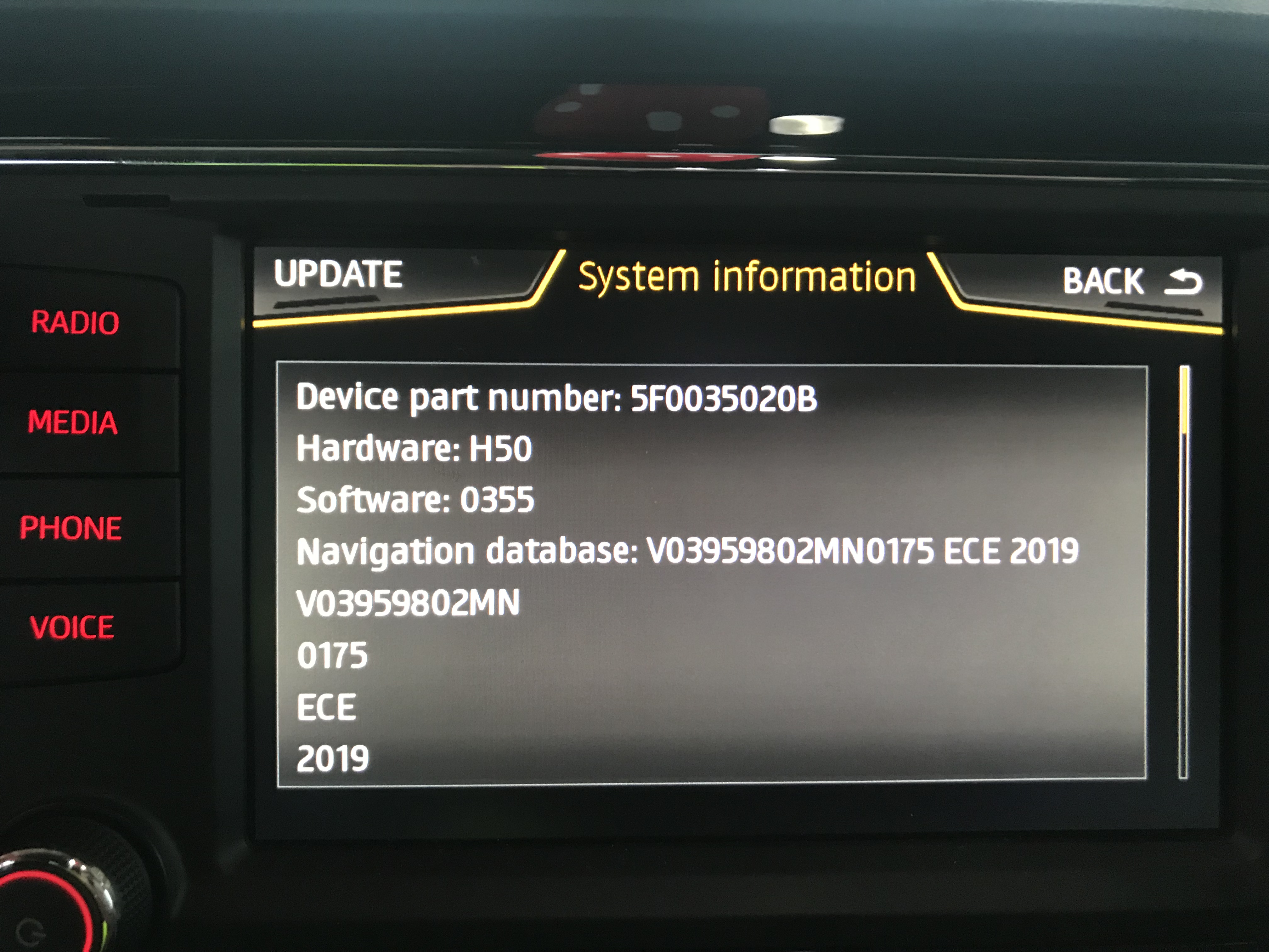

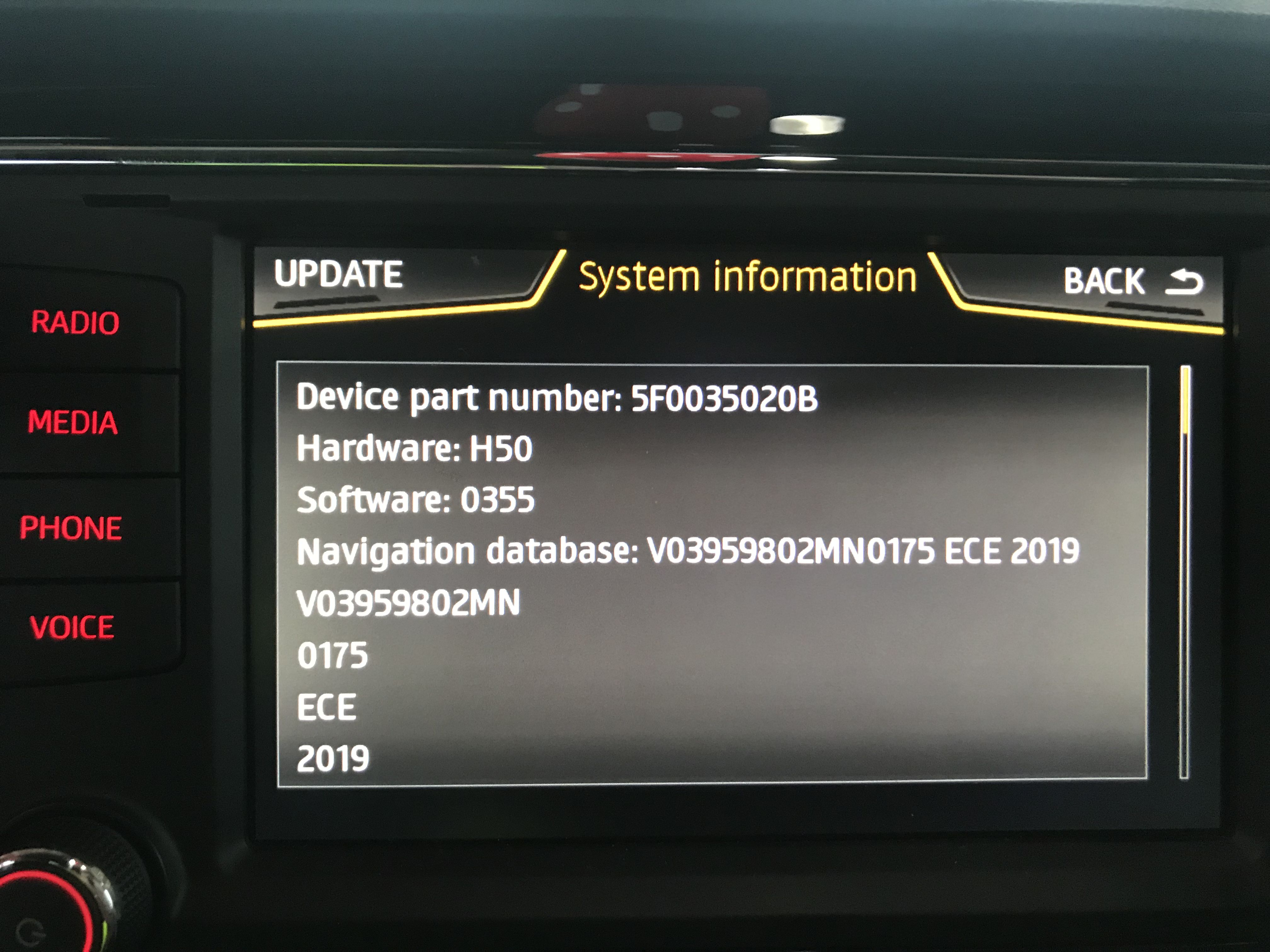

I used NTFS with the md5 file and a Kingston 64 go class 10. Now next question, how do I update software 0355 as seen in this picture?
Some people do say NTFS works. I reckon a USB works as well but didn't want to contradict Walone. I do my speed camera updates on USB as well as SD. USB is fine, I reckon I've read people doing it that way although given can drive about during the update, SD should give you better contact than a pen drive.
Walone is your man for firmware updates. He updated his prior to getting it modded although I don't think he has an H50 unit. Mine is H50, was software 0674, Ateca 2016. So we both used the same small company to get are Mib2 Highs turned into retrofits but had different units.
Mine was:
5F0035020C
0674
After the mod it went onto
5F0035020G
1338
There is a thread on the board
https://forums.seatcupra.net/index.php?threads/sw-update-for-mib2-infotainment-system.427280/page-20
They use the Spanish site mentioned in that thread but they aren't modded ones just the standard release. Your current part number 5F0035020B was the one before mine. So 5F0035020G will be fitted to some Seats. When I looked in December I couldn't find the release that I'd been put on. I was just trying to track down whether that original release was in the public domain. I never found it. You have to go threw the Spanish thread looking for H50... Well that's what I reckon. The company we used turned me away the year before but could do it a year latter, that I believe was due to them being able to source the H50 firmware. So that was my check, you might have better luck, failing that you'll be looking for a specialist.
I pass on the rest over to Walone who did do a firmware update but not on an H50.
