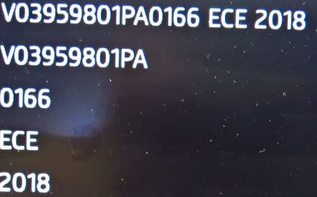

[Mine says:- Map UK Southern England 2018 and picture below.
SD card case EUROPE 1 [V7]
made by TOMTOM
not even sure out of ALL the systems and codes on here what navigation I have on my new 2018 CUPRA R
What is a tech unfriendly guy supposed to do
[Yeah ok buy a TOM TOM my windows phone will not link to my media system]
SORRY I am CONFUSED of KEYNSHAM ha ha

Well the mib2 high which you have based on 0166 shown on the screen, so you have to shell out on that. No workaround as there is on a mib2 standard. Two routes, ask your dealer to update the maps for a couple of hundred pounds if it's available or you pay a retrofitter to convert your unit into a retrofit. There seems only one outfit in the UK that can do this that operates out of South London.
You can't kill a mib2 high very easy yourself unless you put it into developers menu via VCDS and try to bypass Mapcare, you can't so it will stop you from using navigation until you restore the map version that it came with or any one before.
Only two people on this thread has done this, me and someone else. I've seen someone else do it on a European thread. It's the mode of updating the maps on retrofit mib2 highs but won't work if it's not a retrofit. That menu can only be accessed by the developers menu which is locked down until it's unlocked via VCDS commands.
You can't kill a standard mib2 that's been proven by tinkering with the card since you can always download the file that came with the vehicle and reset. Playing with firmware is something different to map updates. There is a thread on that on this board. That apparently only gives mib2 standard solutions.
https://forums.seatcupra.net/index.php?threads/sw-update-for-mib2-infotainment-system.427280/page-20
If you are not technically competent then best to shell out. As repeated a number of times on the thread Skoda and VW have abandoned Mapcare allowing owners to update the maps themselves. In the rest of Europe most Seat owners if they wish can buy at the time of getting their car Mapcare for £100 or so which gives them three years of updates. Buying mapcare after can cost £600 or so abroad for a mib2 high or a single map upgrade about half that price. Since few Seat mib2 high unit are bought in the UK my experience has been dealers aren't up to speed with them. Now Cupras are getting mib2 high units only in the UK, there will be alot of people growling about the situation in the future with expensive top of the range cars.
Even where Mapcare is available alot of people do have technical issues which you read around the use of Mac's and VW / Skoda software not working. Clearly if you are not technically minded then you need to get a dealer to update the maps. VW and Skoda offer this route even where Mapcare is available. Seat in the UK not supporting Mapcare defaults to this single route unless you have a mib2 standard using the workaround or a mib2 high retrofit then you can do it yourself. Mib1 standard / high no solution apart from the dealer unless it's a retrofit or getting it made into a retrofit.
Hope that help :).
PS on the dealer comment 166 isn't bang up to date but I guess they don't have the bang up to date card to update it with. 175 is bang up to date.
