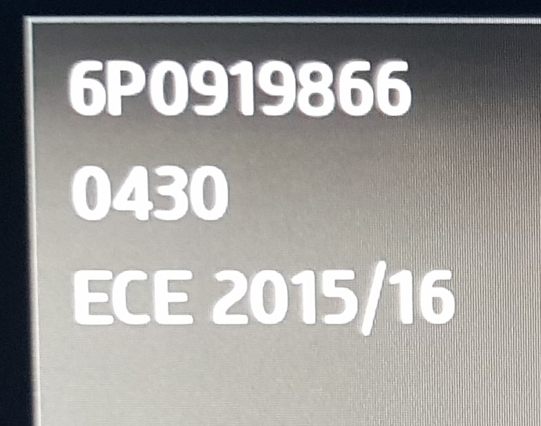

This is mine...
I take it that is very out of date.
Can anyone point me in the direction of a guide to update please it would be much appreciated

Three years. That's a mib2 standard.
It's all above how to do it. Wine calls.

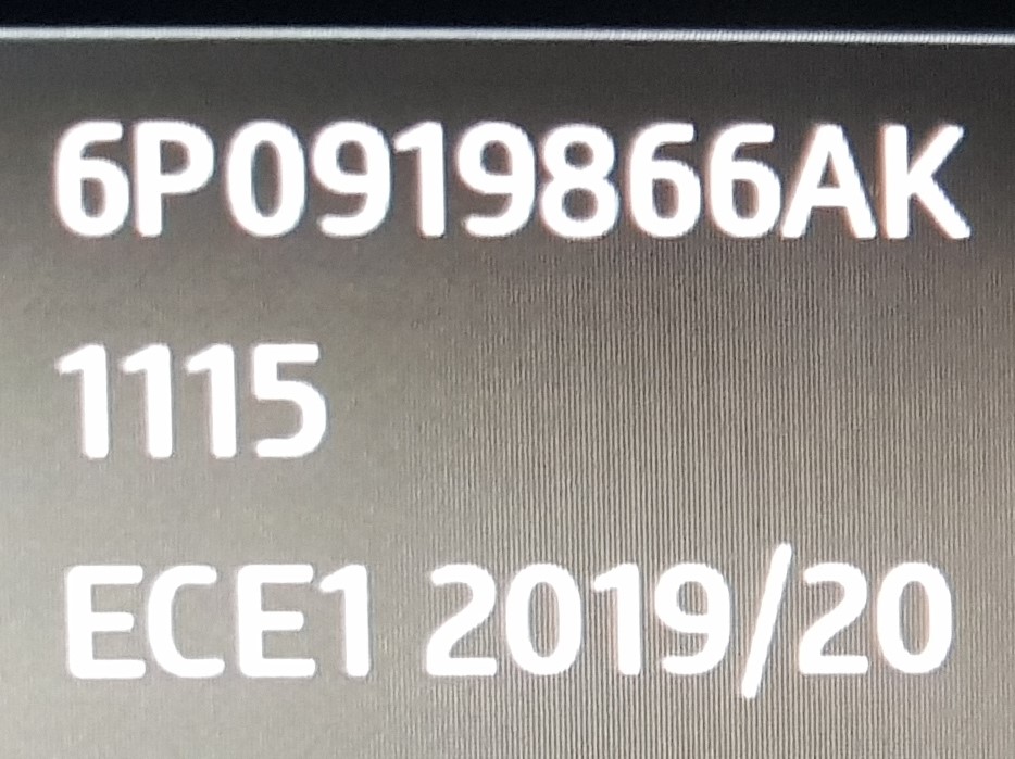

All Done!
See attached..
Been out and about for 45 mins and all is fine.. my new 5 a side venue is on there now aswell, which wasnt the previous version :)
