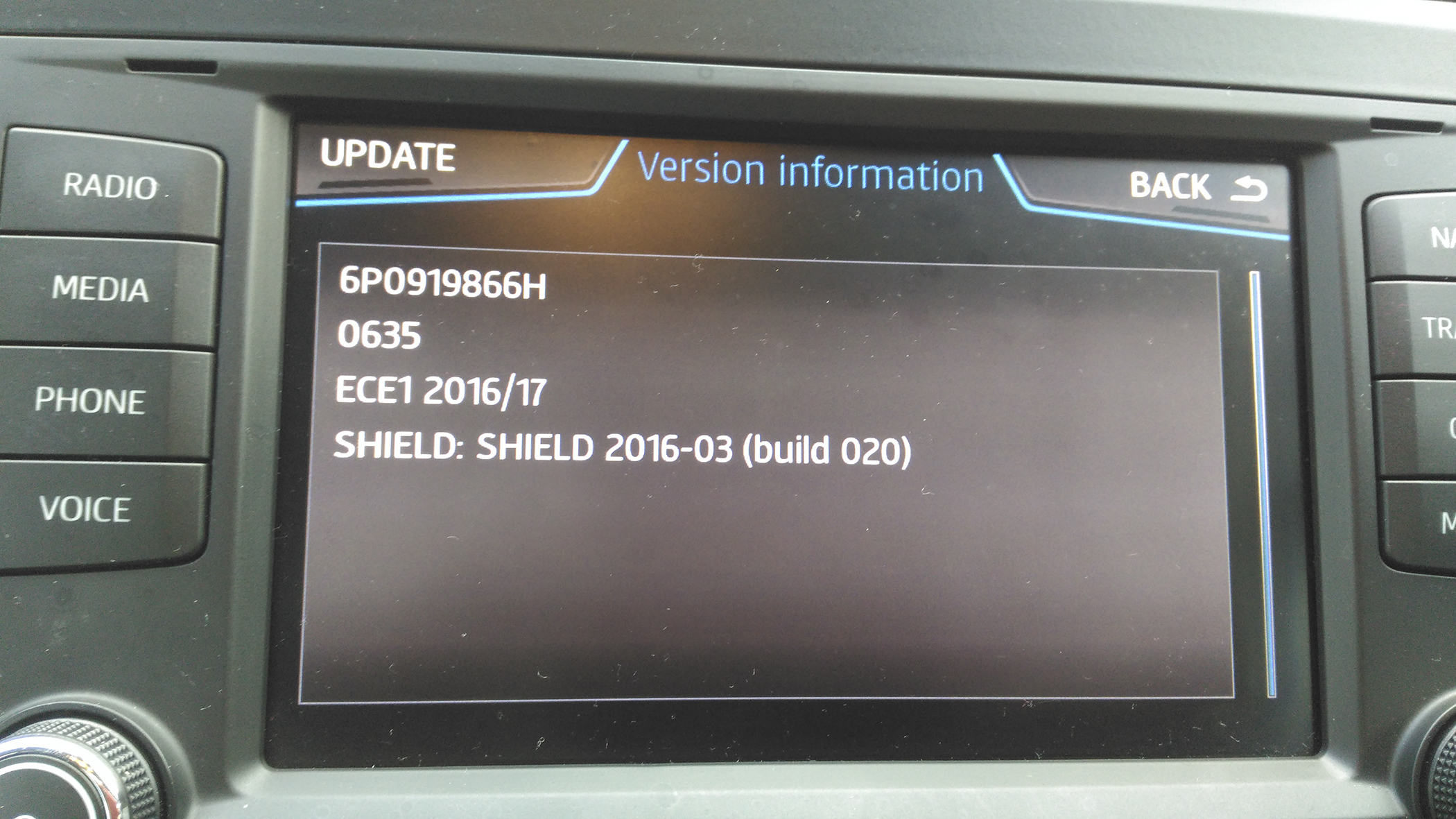

It is straight forward if it's a mib2 standard, (the 6P type revealed by the advanced menu) with the "workaround" method. If mib1 standard or mib1/2 high you have to shell out in one way or another.
Here is my screen

Here is my screen
@John Young I had some issues updating, but as normal it was the thing between the keyboard and chair at fault not following instructions .
First off I bought a second hand SD card of eBay for twenty odd quid, they will normally take offers. I them cloned my original card using AOMEI Backup software so I had a fall back up plan. Then downloaded the link that @Tell so kindly supplied. Unzipped with 7zip as instructed, copied the overall.nds file as described from ORIGINAL sd card. Switched audio system on, long press power until it restarts, inserted SD card and it just worked. Awesome support by the guys and gals here .
Edit: Don't forget to use slot 2 on the nav unit. I kept swapping mine around and got into a right mess.
Sent from my SM-G950F using Tapatalk
Buying a second card isn't required unless you think that at some stage in the future your existing SD card will become unwriteable or unreadable. The normal Vag method you just use the existing card, the work around has that file twiddle in it that's all. So you don't need to invest in a second card to do map updates.
You can always copy back your old release if you don't like the update. All historic updates are online so you can swap back to them and if you loose the critical overall.nds file that matches you physical original card you can also install from that.
ParadoxB as I recall I think you triggered a card update by using two cards which is why your new card worked but not the old. The unit went on to marry up the new CID on the new card with the unit. Least as I remember it. Thus I advise against using a second bought ebay card.
Windows back up can't back up and copy the CID - CID part of the card storage remains outside of the Windows operating system even with Windows utilities. You can buy "gold cards" where the CID can be written but you have to use a Mac or Unix operating system for that. Exciter did do that as an experiment. As I understand it each official card has a unique CID which is locked to the unit, not that each release of an official card series all have the same CID. The lock is via a CID. Anybody who has two Seats on the same release card can swap and test between cars, but I reckon the CID is unique to each card... might be proved wrong on this one thou. This one came up in a conversation where a person had a unit without the SD card.
