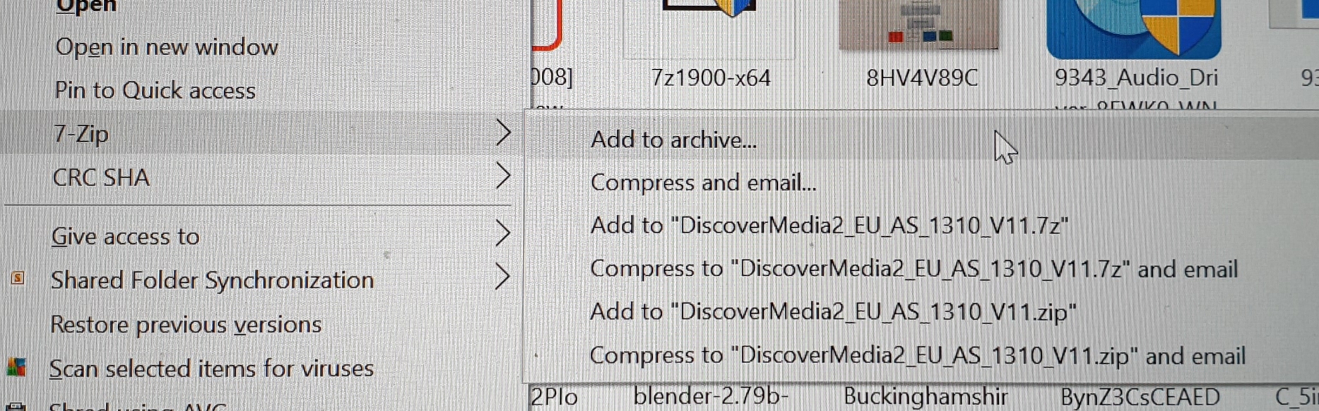

PC Tell. Just checking when I'm zipping or unzipping which one I'm doing?
Unzipping. It comes as a zip file. If it's a PC you download the free 7zip, sit on the file in the file manager, right click 7-zip, open archive, drag and drop to a created directory on your HD for it.
7-Zip
https://www.7-zip.org/
Install it if using a PC.
Having taken a copy of the original card onto your HD in its own directory. Create a directory on the HD where the new Map data unzipped is to go. Delete what's on the SD card, drag and drop the new files from where you put them on your HD unzipped, with Map obviously in the same location on the SD (on the root). Now replace the new overall.nds file on the SD with the original.
It sits in the
Map\EEC\EEC_WLD
directory, copy on top of that your original overall.nds
Lock the SD card and all done.
Let someone else tell you the Mac method but mentioned it above. Cleanmydrive etc.

Thanks for the detailed replies I will have a bash at this tomorrow.
Stupid question but do I just use the SDCard that is provided by Seat or do I need to buy a new one ?
Also does this mean back up the orginal SDCard ?
In all instances of the workaround do copy the SD card off
Thanks again :)
