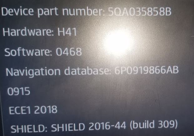

I would be grateful for some advice about updating my maps and which instructions to follow. Here's my current versions. Sorry about the flash from the camera.
I'd prefer a method that doesn't introduce any errors or changes the part number.
Can I go from 0915 to the latest or do i have to go through the intermediate steps ?
Follow post #1786 should do it as you want. (Albeit there may be errors which are not seen unless checked with OBDEleven etc- Dealer will not even bother about these)
And yes you can go from 0915 to the current maps in one update.
