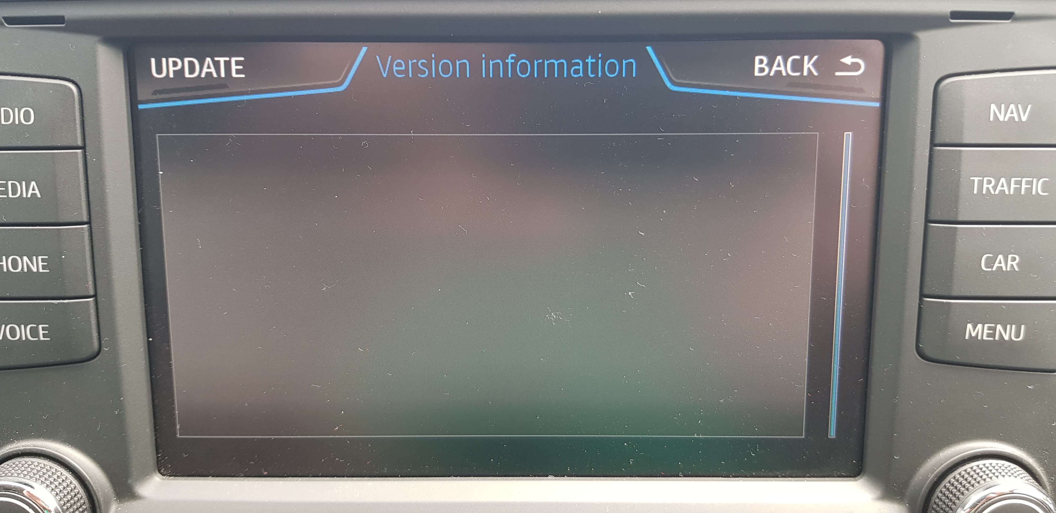

Hi all , after i update my mib 2 to last maps 1310 i can not see what version i have but maps are working . When i format the sd card i chose NTFS not FAT32 . Any idea why i can not see what version of maps i have ? Thank you
Should be formatted in Fat32 although not sure it would be that, but it should be in Fat32.
The general info screen I would think would give you something:
● Press the Infotainment MENU button and
then select Setup .
● In the System settings menu, press the
System information function button.
Mind you he would have rebooted if he followed the instructions ;). I have seen the standard screen in navigation displaced where a reboot fixed it.
The infotainment system is running QNX a form of Unix, expects Fat32 on what it reads on the SD card, part of the systems spec etc... why you are suppose to stick to Fat32. 7zip and Fat32, a PC and you can't go wrong. Mac's you have to run the programs and utilities that delete the rubbish that gets put in by the Mac file structure.
Where people get issues is reformatting the card changing the sector size in fat32 so they cant get all of the maps on the card. So you don't change what it's set at or file system. Just do a reformat if you can't wait for it to delete all. Don't change the file scheme.
