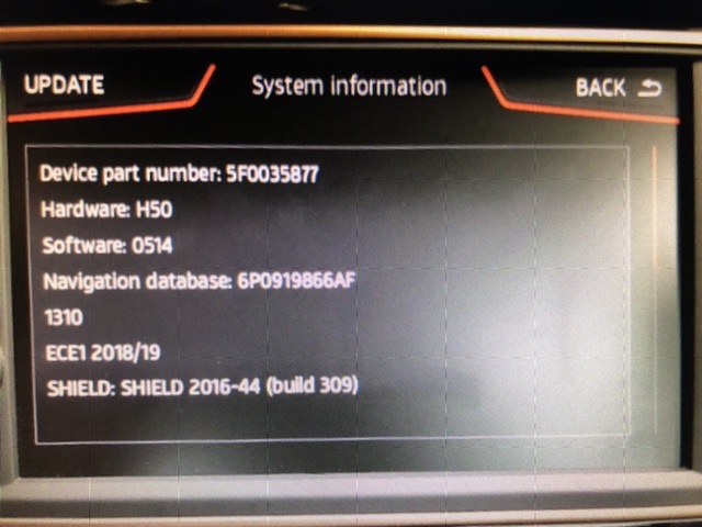

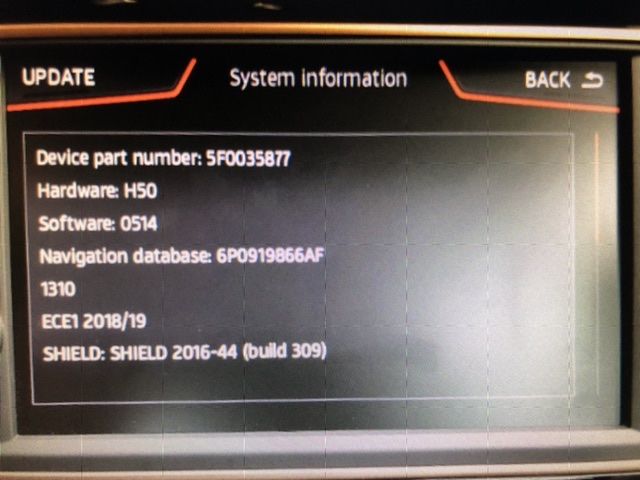

Thanks for the comprehensive replies. Is the infotainment software updated as part of the map pack too, or should this have been updated at the dealer during service?
My car delivered June 20th has software 0514.
The rest the same as yours (apart from ‘1030’ mine says ‘1310’ - but I think that’s ‘cos I updated the maps myself)
The nuances are that you can’t load POI’s on it eg no speed cameras
It’s the same for MY2020 WiFi units as well according to the Spanish thread.
