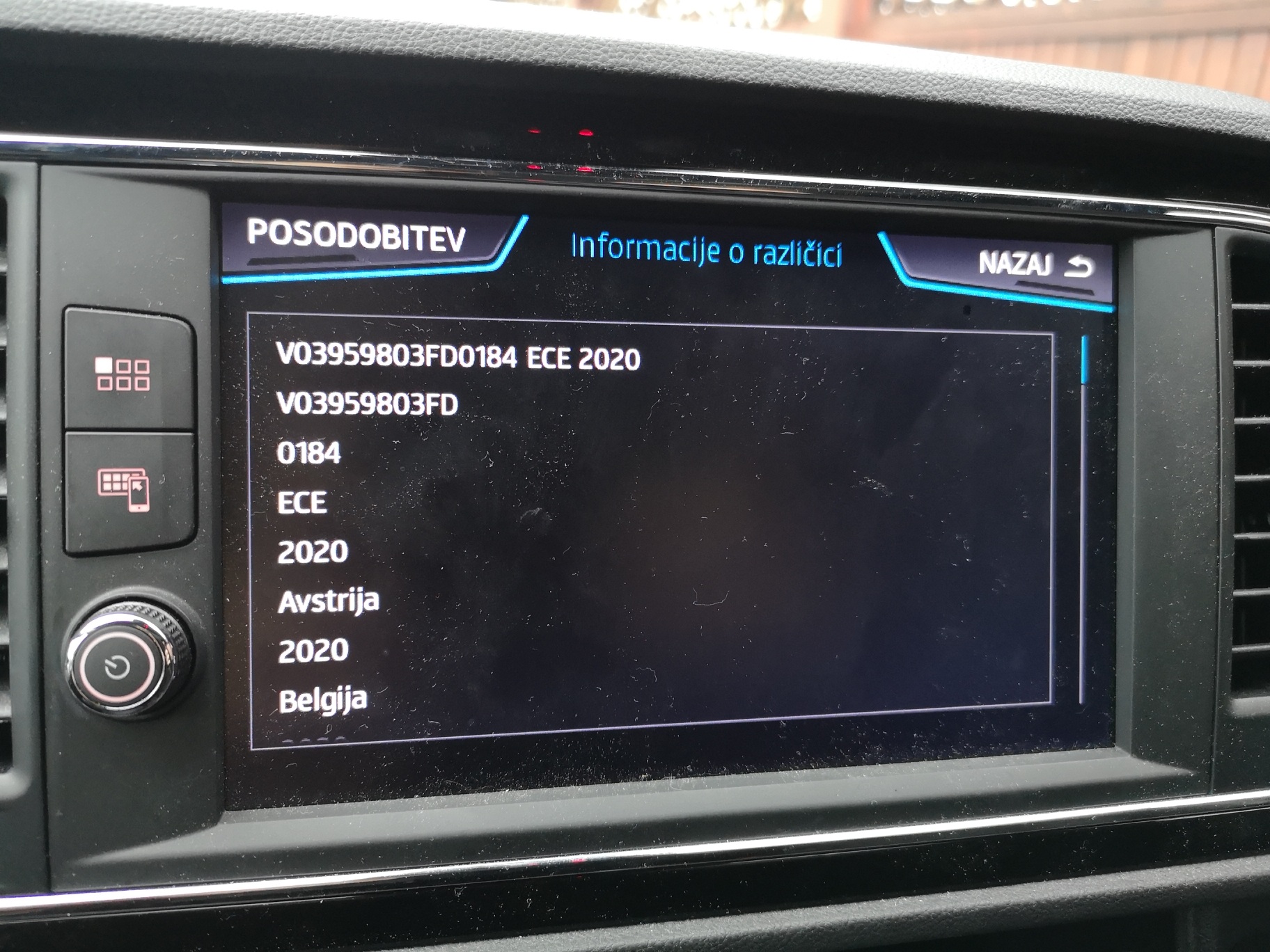

I confirm that P184 update downloaded from link on previous page work normaly(I have Map Care)...

Thanks my retrofit firmware is playing up on 184 so I didn't report back (our Walone & myself private conversation on the matter, not so unlimited, matters in hand). I noted that on the German Skoda board and the Russian link they had it installed fine.
Ah so you bought post car purchased Mapcare as I gave you the serial number, that which we can't buy in the UK. Wasn't so sure whether you had a one off map upgrade or bought Mapcare. Evident Mapcare.

Yes Im buy MapCare by dealer with your provided part number :) From activation of MapCare at dealer Im already 3 times upgrade maps without issues(This 184 is third time)...

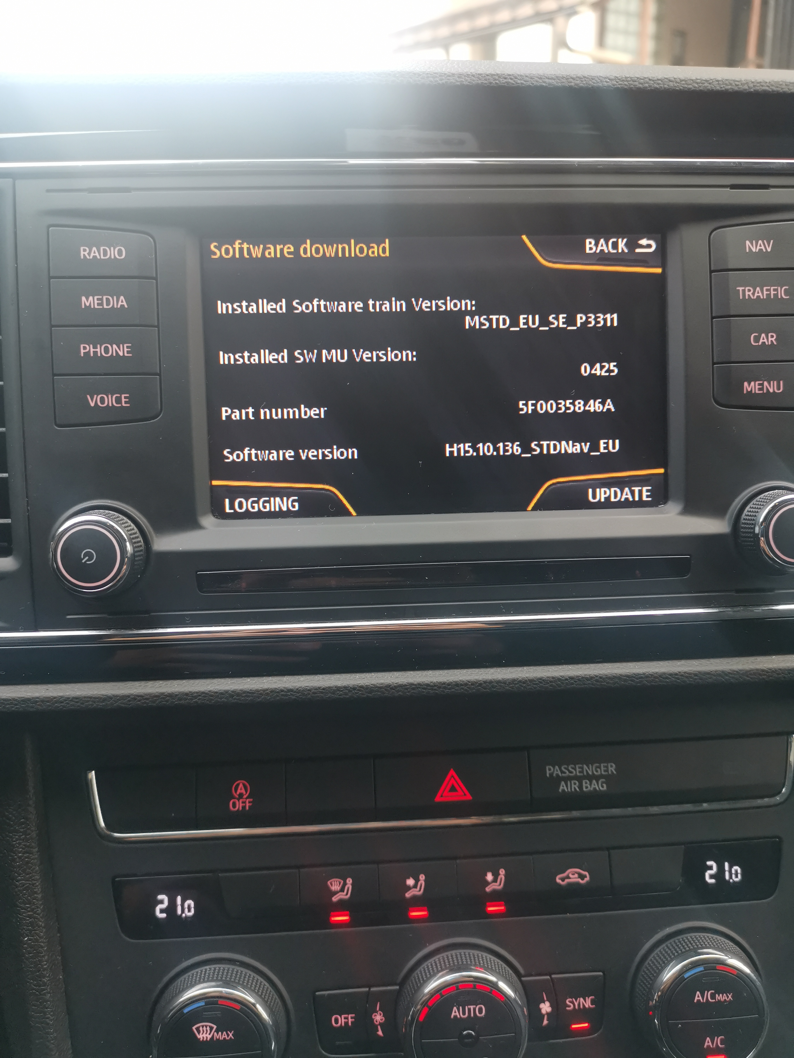

Hello, can you please tell me if i have the latest update.My car is 2015 1.6 leon Thanks/Hvala
For updates you follow this link:
https://www.seat.com/owners/my-seat/navigation/map-updates.html
I think you have a mib1 from the date and 5F code that is bring shown. If you haven't got Mapcare on that or some form of retrofit you are hard pressed to update it.
If it's like the mib2 screen you go navigation, advanced and information or words to that effect and it should show you the map year and release serial number. I've never had mib1 so can't be clear. I'm assuming it's a mib1 standard with the map on the SD card.

Thank you, yeah i have mib1, but does it matter from wich year it is? Because on the link you gave me its only for the models from 2016-, and my is 2015?

They were only showing mib2 on that link. 6P is standard. 5F is mib1 which puts it at pre 2016 as you say. We don't know of any DIY map upgrades for mib1 standard. I was going to ask the retrofit specialists today about mib1 standard but had enough issues getting my mib2 Plus / High sorted out for the latest map update so it fell off the back as numerous attempts were made to sort out the firmware. False farewells down the road and returning when traffic sign recognition failed. Now sorted :).
