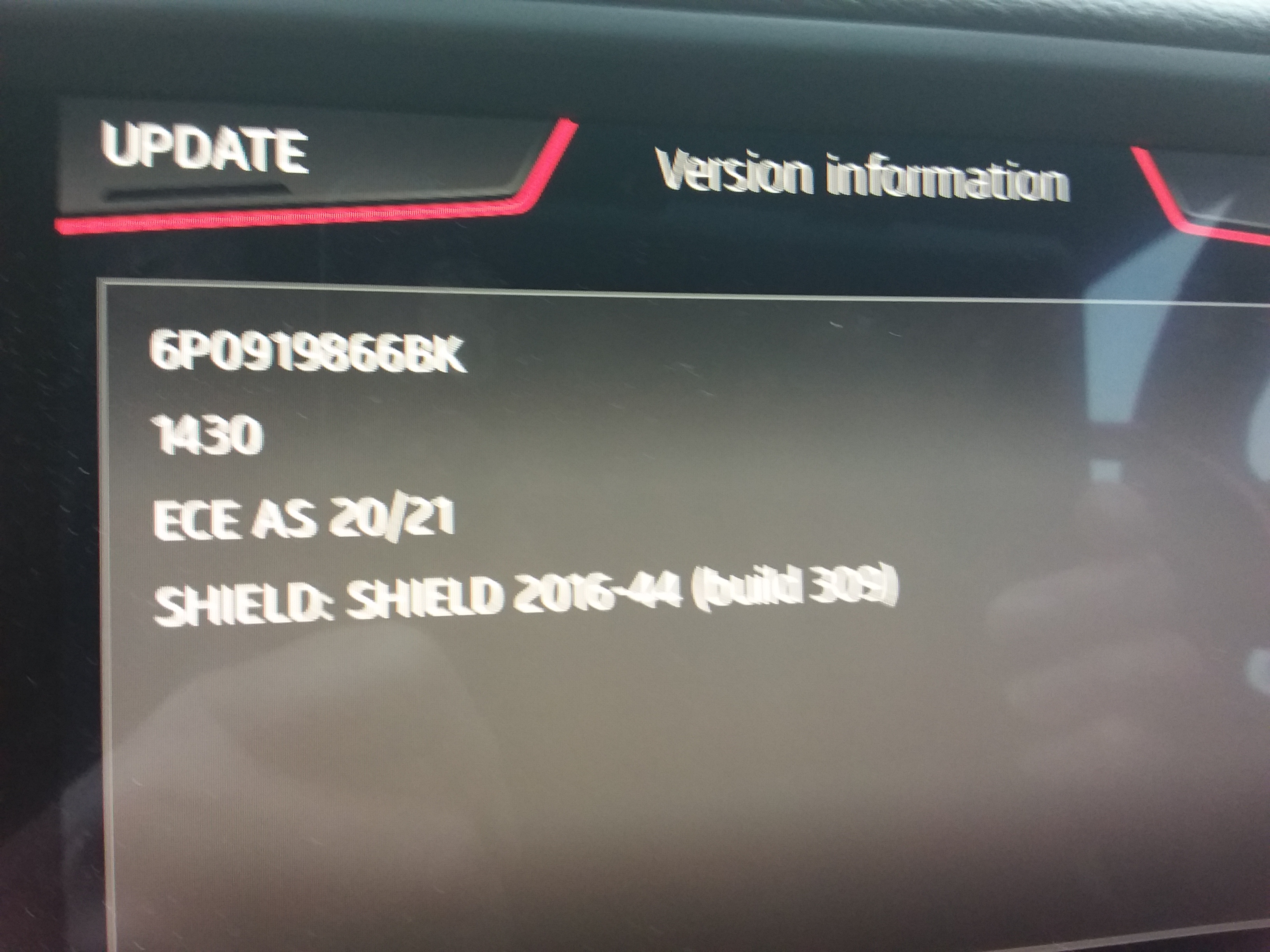

Installed SDcard into car, rebooted and all seems well so far. Will be going out for a test drive this evening to confirm.
Reactions: Tell
Yes installed fine with the workaround and also comes with the Seat 6P part number as well. Can be ticked off as done (1430).

Yup all seems good so far after a little drive last night. I’d say it’s safe to do the update
Had a longer drive today.
No issues at all, still contains the same quirks as the old maps did.

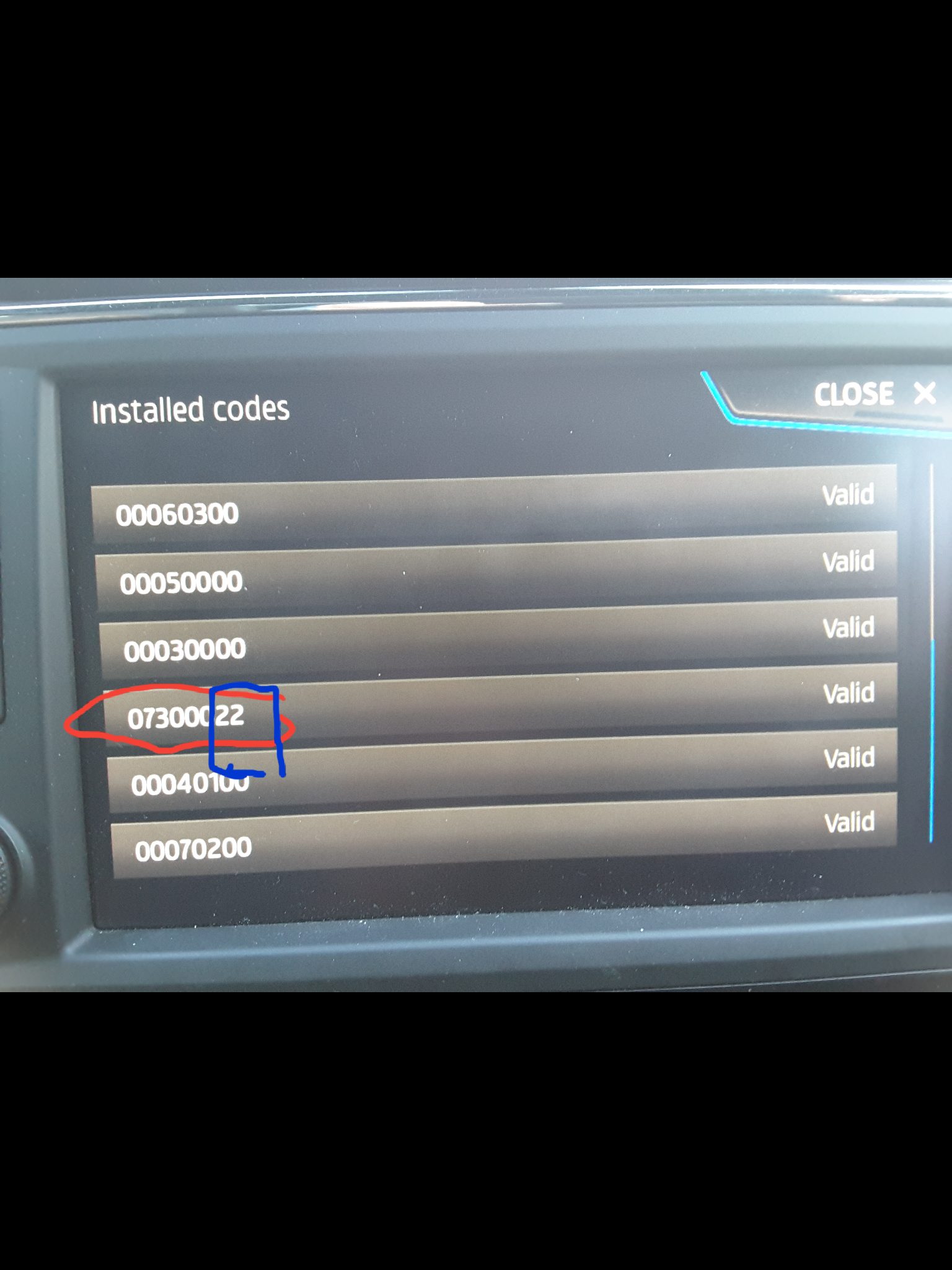

Ok we can play the Mib2 high Mapcare FEC game of understanding the codes... I think I've got it now after having my unit refreshed. Looking at a Russian link and Obdeleven forum post.
We use the first for which button to press if we don't know how to do it.
http://forum.obdeleven.com/thread/6082/fec-swap-codes-list-mib
1. Hold Menu button until service mode shows.
2. Press "Function enabling codes (FEC, SWaP)"
3. Press "Installed codes"
We are looking for a code begining 073....
Now we need the last two characters.
Yours will be 22 (telepathy:))... Thats the period the 184 update won't work against on my reckoning.

Interested to have Dejana's two last characters who has Mapcare to see whether it makes sense against when he got it enabled. Walone I reckon will be the same as mine was before I got it set to unlimited which is off the bottom of the Hex table on the Russian board which makes sense.
I compared this FEC with the ones I had on delivery and the two retrofit software updates to work this out against that Russian site. I'm assuming all Seat models with mib2 high have the 073 Mapcare code.
