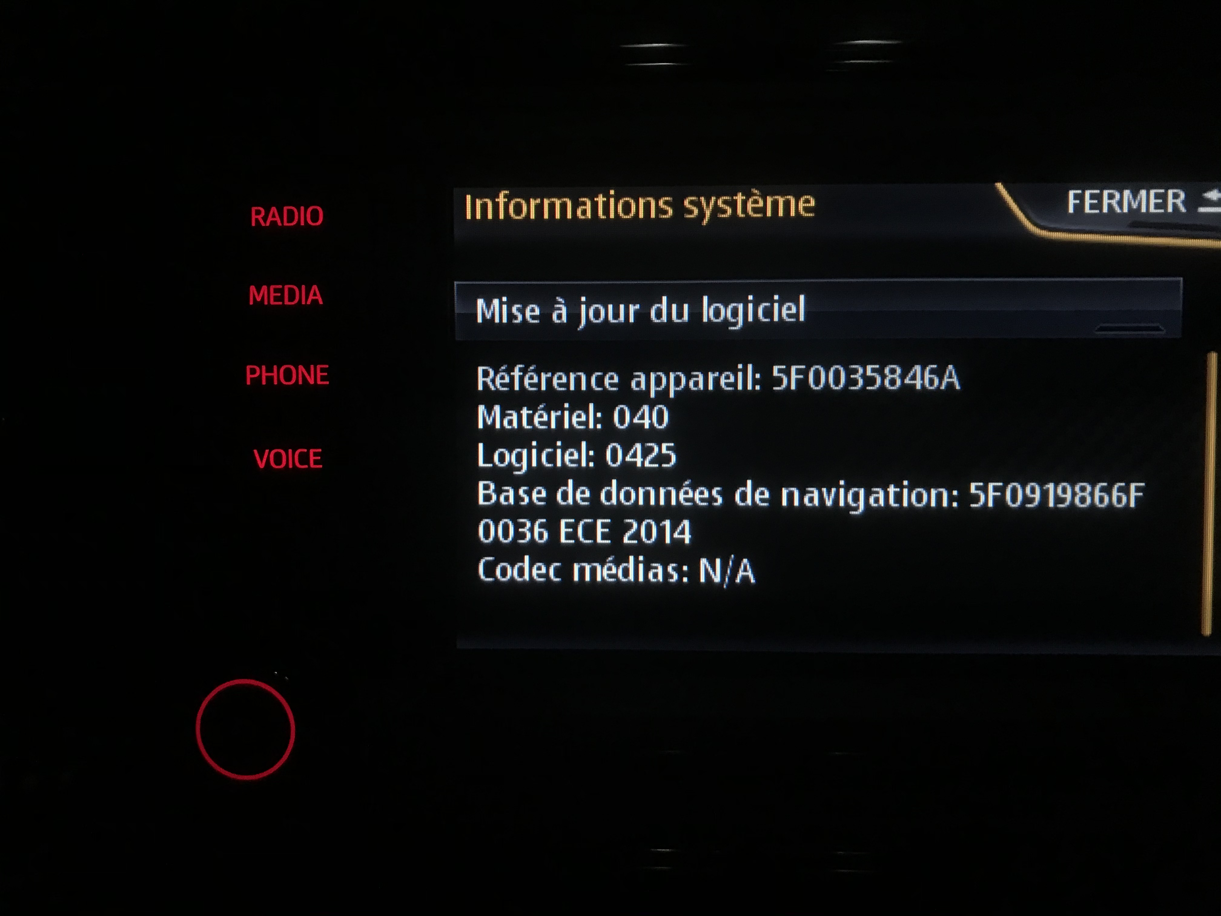

Hello,
new here, so I did try to read some pages, but 97 is a lot :D
I did download about 40 Gb of different files linked here, can someone refer me to a post out of all of them, that I can safely follow to update my navigation please ? (any version with France will do)
I think you are out of luck that's a Mib1 standard. There are no known DIY (do it yourself) reliable solutions for that.
Mib2 standard there is the "workaround" if you don't have Mapcare. Mib2 Plus / High you get the unit turned into a retrofit which adjusts the Swap / FEC code so maps can be uploaded to the limit of the code.
Only DIY is Mib2 standard. Others you have to seek help from a dealer or an equipped retrofitter. Mib1 standard there was a guy in East Europe who was trying to drum up business a few years back. Find a suitable retrofitter in your country and they may be able to sort out Mib1 but I guess they would prefer to sell you a mib2 retrofit.
BTW 6P means it's mib2 standard 5F mib1 standard. Yours 5F.

All right ! Thanks for your answer @Tell
Not gonna lie, didn't understand everything you said, but if I sum up :
I am out of luck (looks like you figured me out already) and I can't easily update it. My best chance would be to discuss with my local Seat store about it
Cheers
