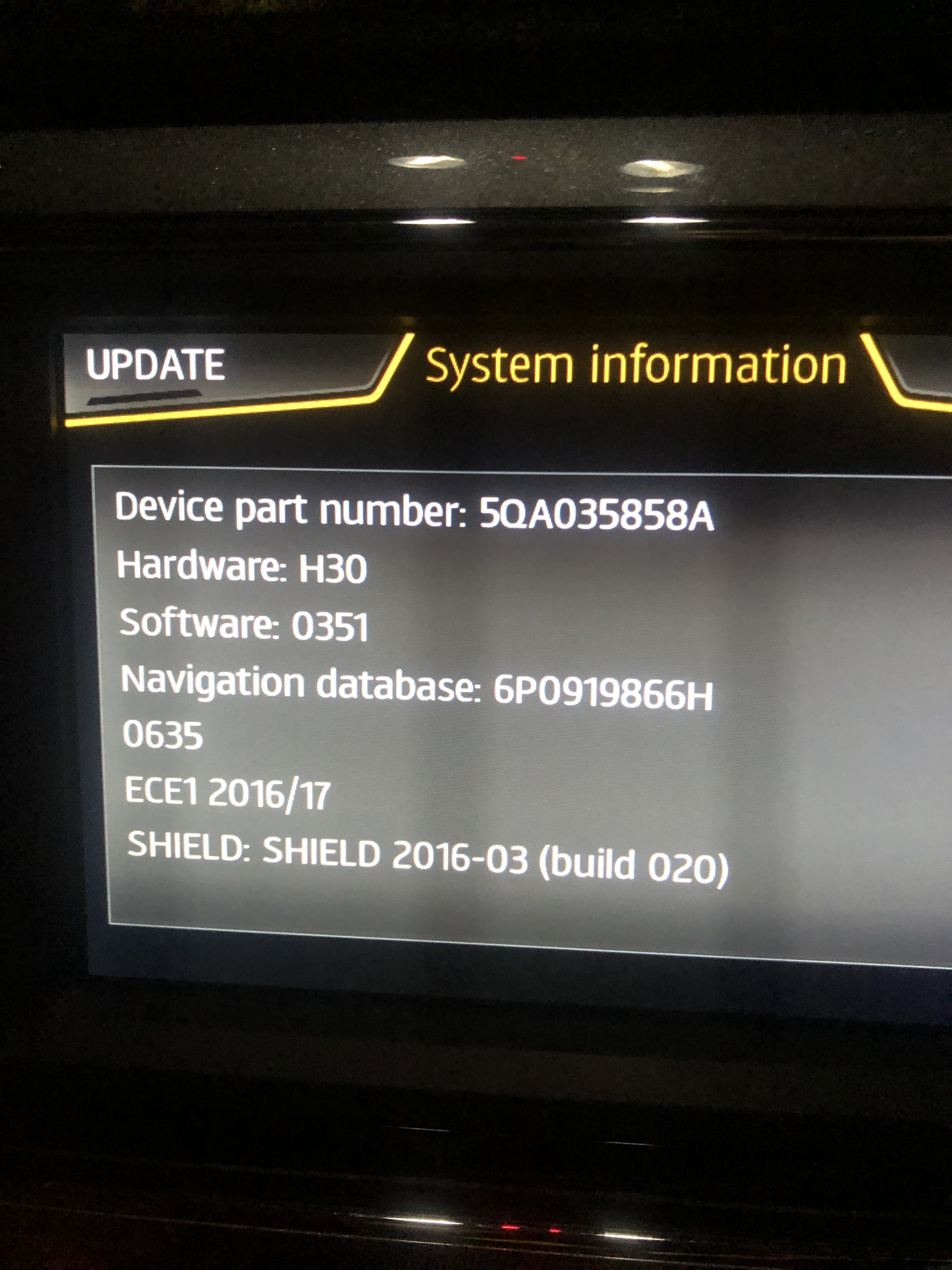

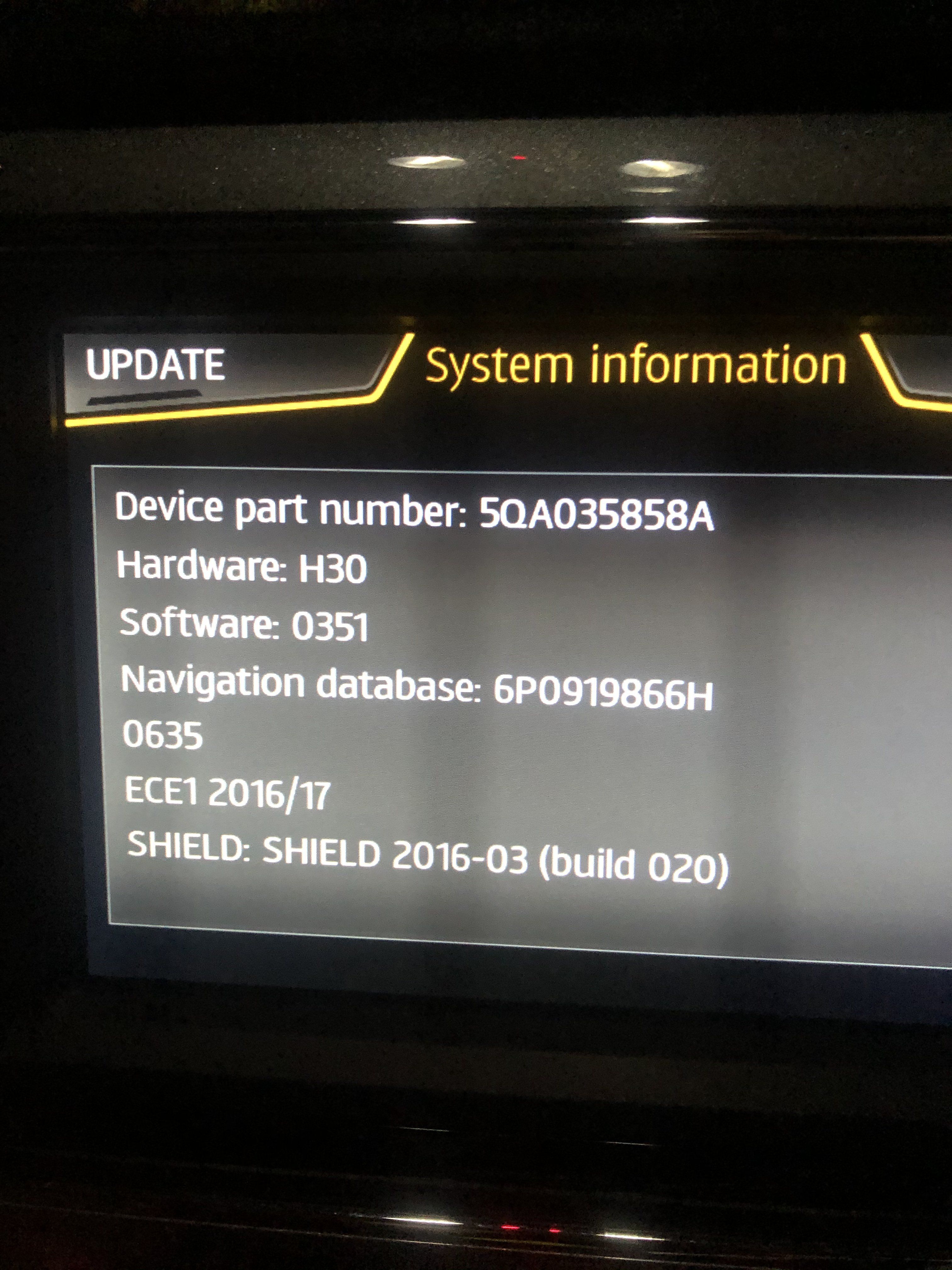

This all good? Seems to be 6P
your second post was a better description on where to find the number

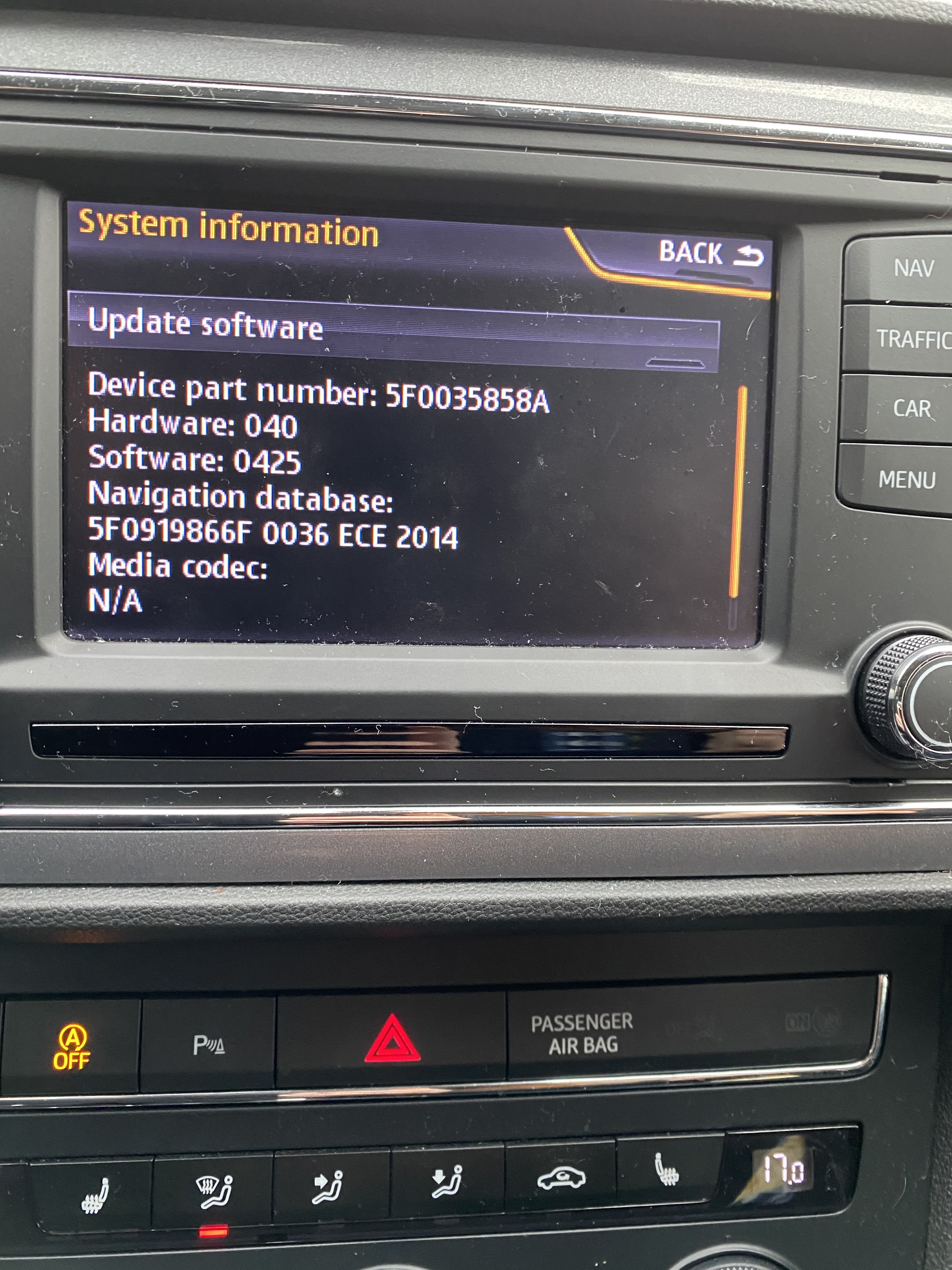

Hi all,
i have a MIB1 5F0. Is there any chance to update navigation for free ? Or do i kick this MIB1 out ?
Thanks
