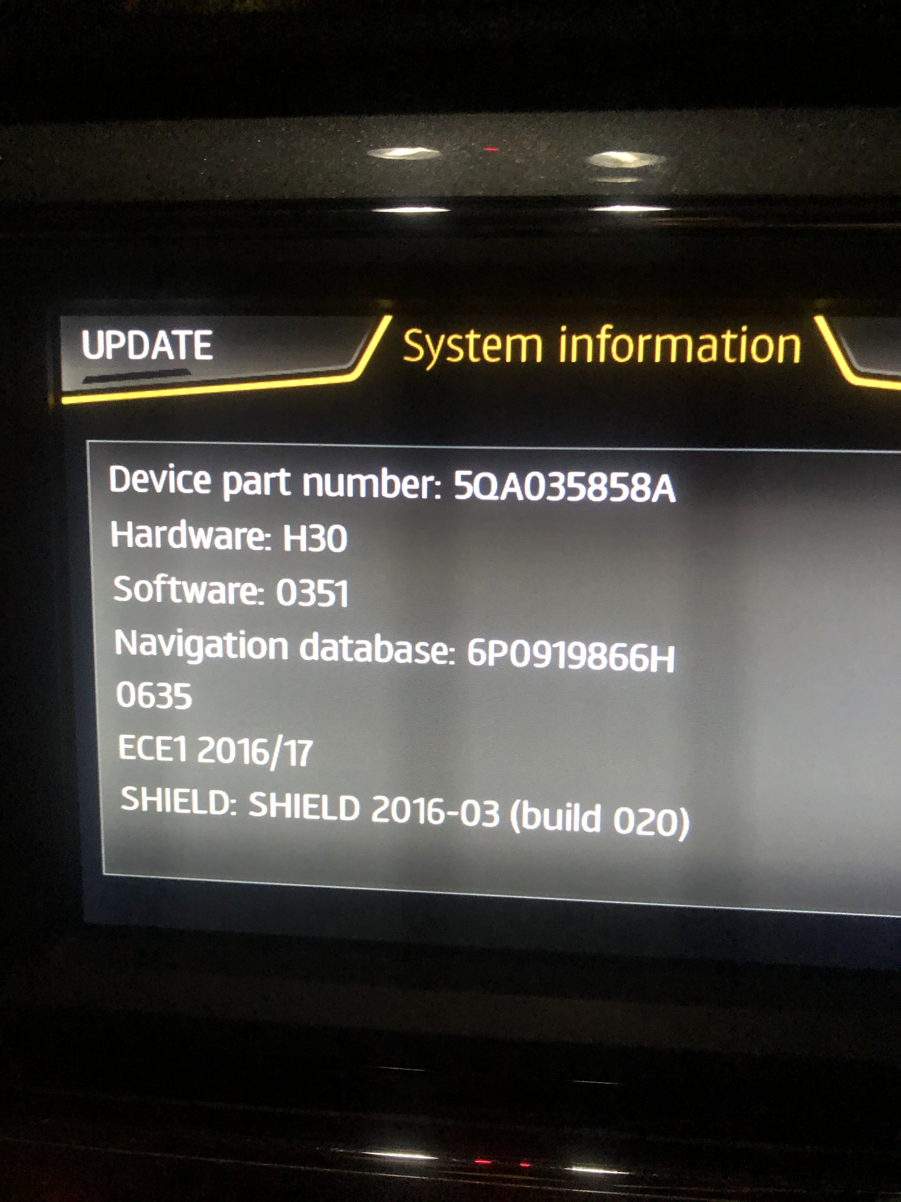

Hi what’s the difference between the high 184 and standard 1430? I have a seat Leon 2016 is this can answer anything, making the update is right for my car? I am going to have a crack at updating my MIB which is 6P over the weekend.
I would be using a MacBook too if there’s any further implications

Are you sure that your unit is not a Nav High unit which does not use a SD card for the maps, what does it say when you press the Nav button?
If your card in the unit says 6P on it or the standard test has 6P on it, its a mib2 standard and 1430 is the update. The test from the Seat site:
Press the “NAV” Button > Confirm the “Setup” > “Version information” selection on the display.
Check the first text line in "Version information". If the first three digits are 6P0, your system version is the "Navi System - 6P0". If not, your system is the "Navi System Plus".
& if it has 5F it's a mib1 standard.
Post 1810 covers MacBook things you have to do which is the VW text plus some Skoda user site info. I dont use Mac. Others here do and don't have an issue if they ensure they take appropriate steps. Mac OS generates additionsl hidden data which the unit will trip up on if its not deleted or cleaned before copying the data to the SD card. That's Keka” unzipping program and using the “CleanMyDrive" - the VW suggested method or the one below in 1810.
Remember to take a copy of the card before you start.
(In functionality terms the high / plus stores the maps on an SSD in the unit, doesn't use a map SD to run off, uses Here Maps cartography, the standard uses an SD card in the unit to hold the maps, TomTom cartography. They have a similar look and feel, directions leading into a roundabout and out before entering isn't so well execute on the standard as the high, high shows you the exit before entering, the standard just tells you to enter - left panel of the screen if enabled, next turn). The high you can amend a route by dragging the route, standard you can't. Standard you can update the maps yourself via the workaround on a mib2 high / plus, the high you have to obey Mapcare parameters set in the unit. Can be frigged in retrofit. The high is faster in use and has 10gb free to put extra music on the SSD and two free SD slots for this rather then one as the standard - other is taken up by the map card.)
