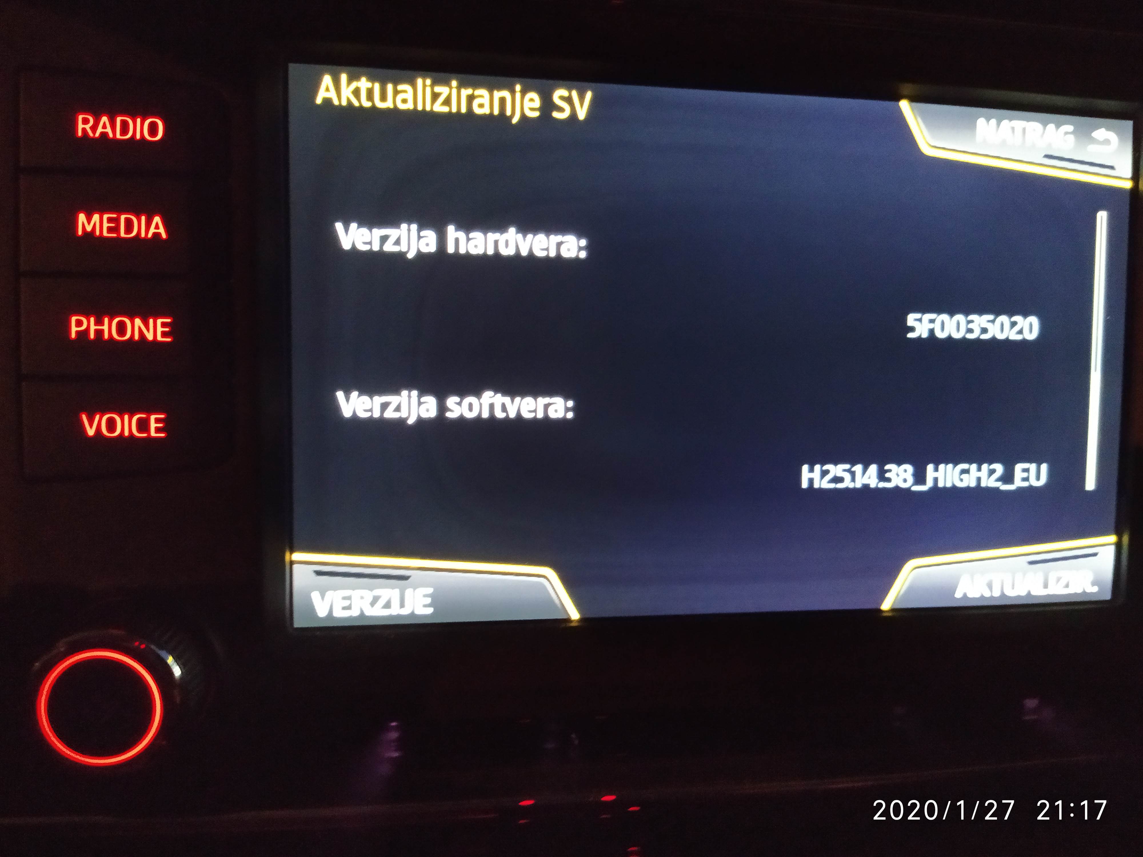

I need help with updating my 2016 seat leon 5F8 mib 2 high which didnt came with an sd card and i believe it stores nav data on internal ssd also it has mapcare. I tried downloading navigation data from seat website and updating it with a generic sd card but it didnt work so i dont know where to go next. Please help me.

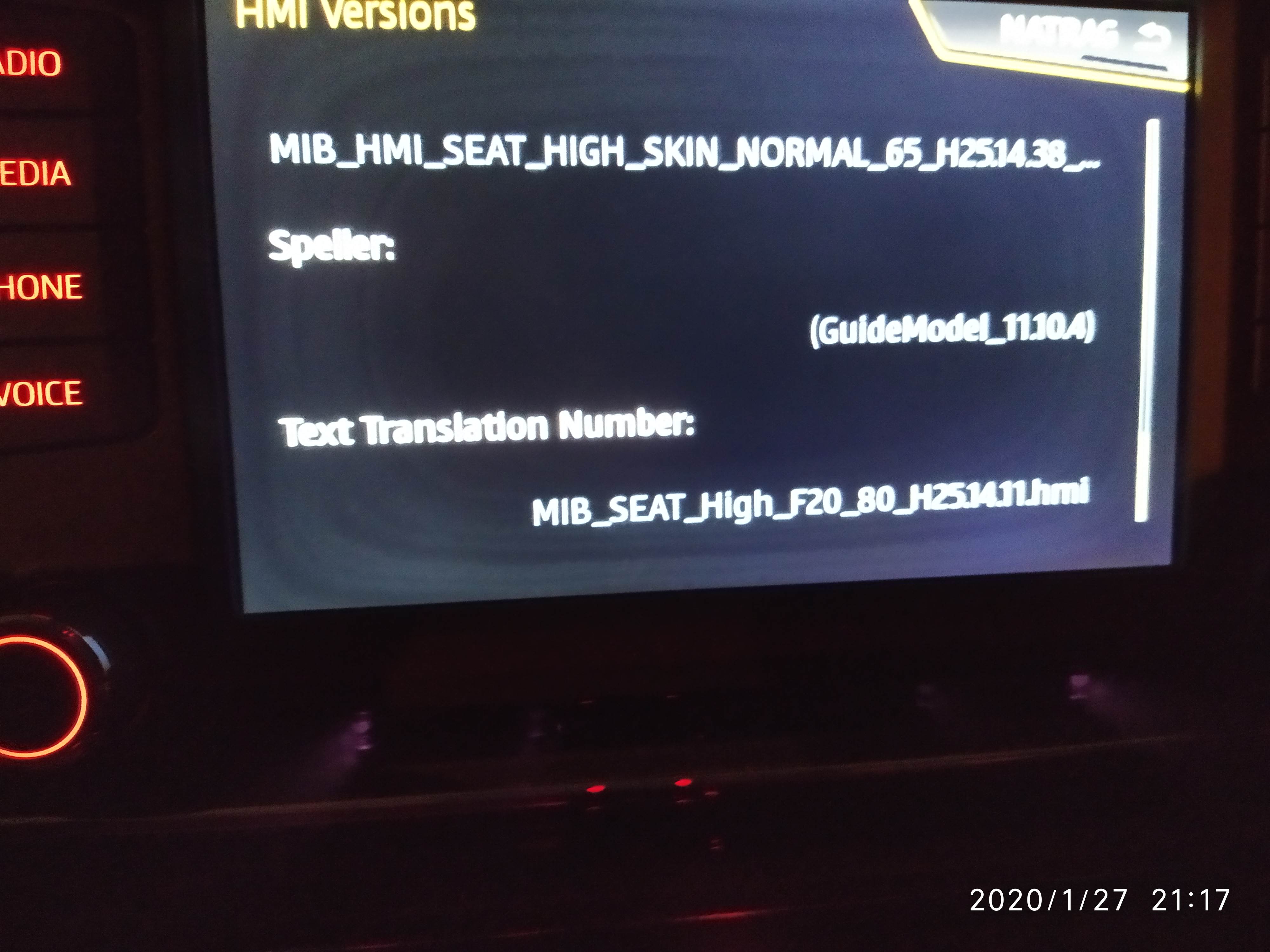

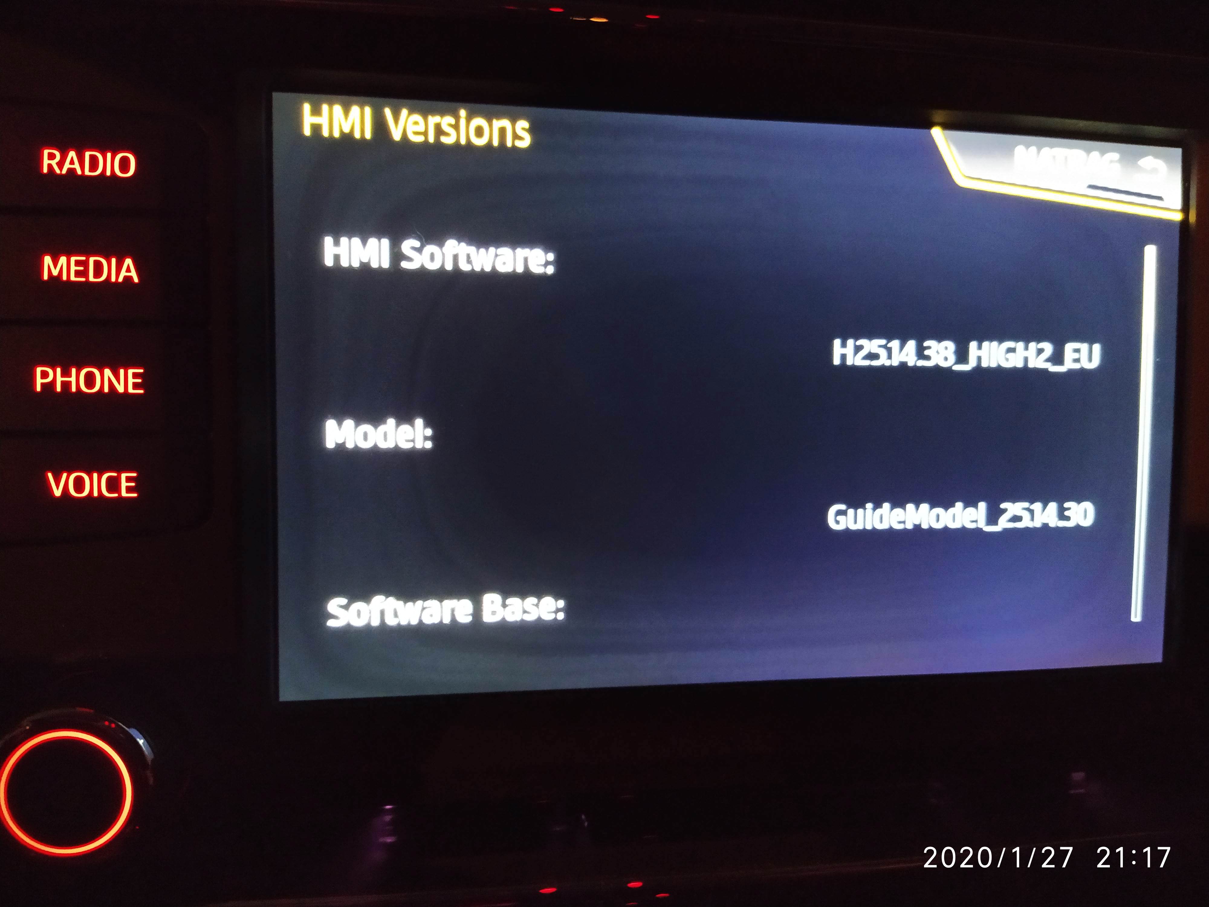

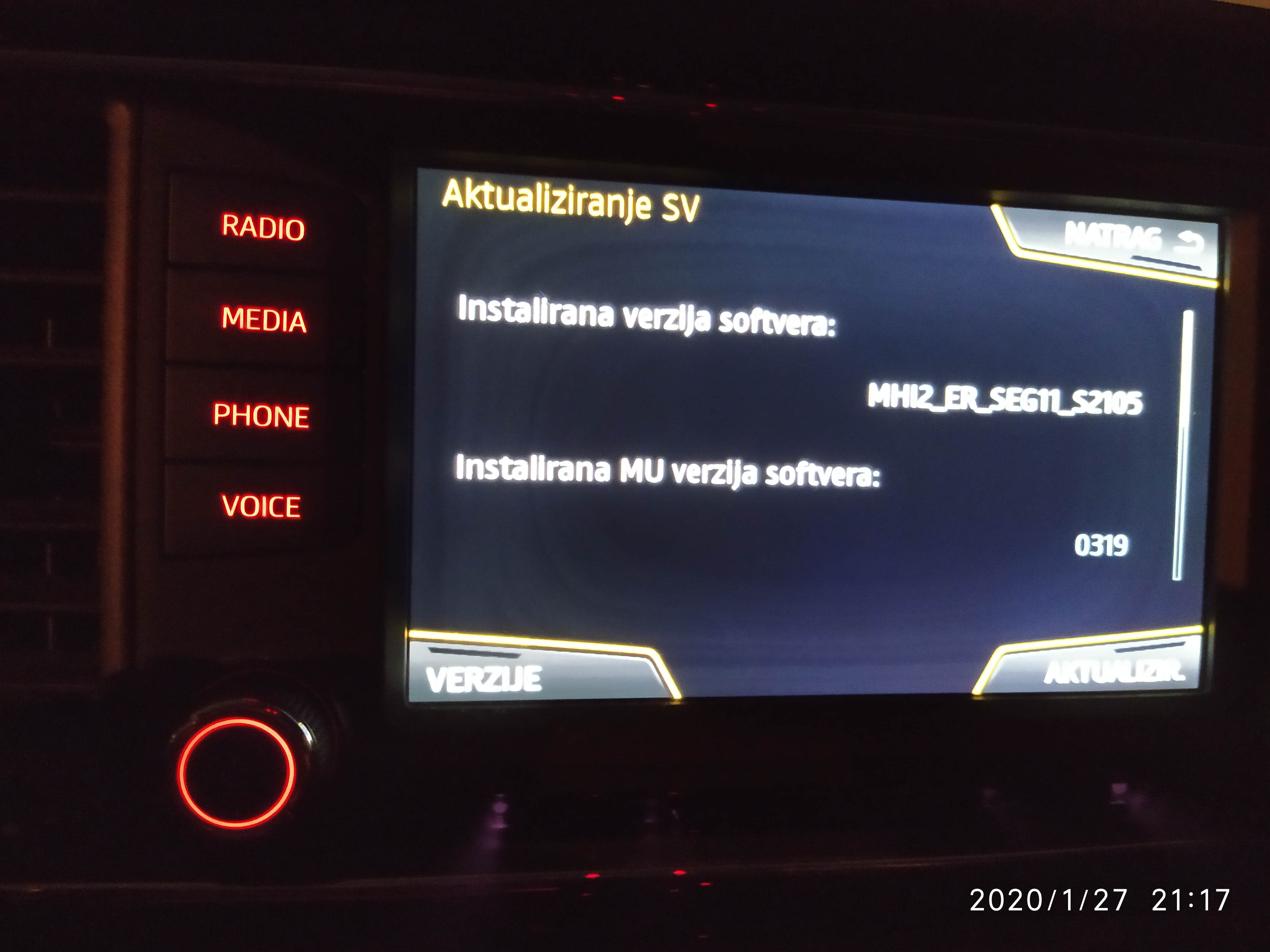

Here are pictures from when i enter service mode i dont see any codes staring with 073.
I have actually asked my dealer about navigation updates and i have been offered some outdated update for around 400 euros
They didnt know anything about map care for sale id be very thankful if you gave me part number for it

Looking at those images you need the Service menu brought up:
1. Hold Menu button until service mode shows.
2. Press "Function enabling codes (FEC, SWaP)"
3. Press "Installed codes"
We are looking for a code begining 073....
That was in the link posted.
Now we need the last two characters.
