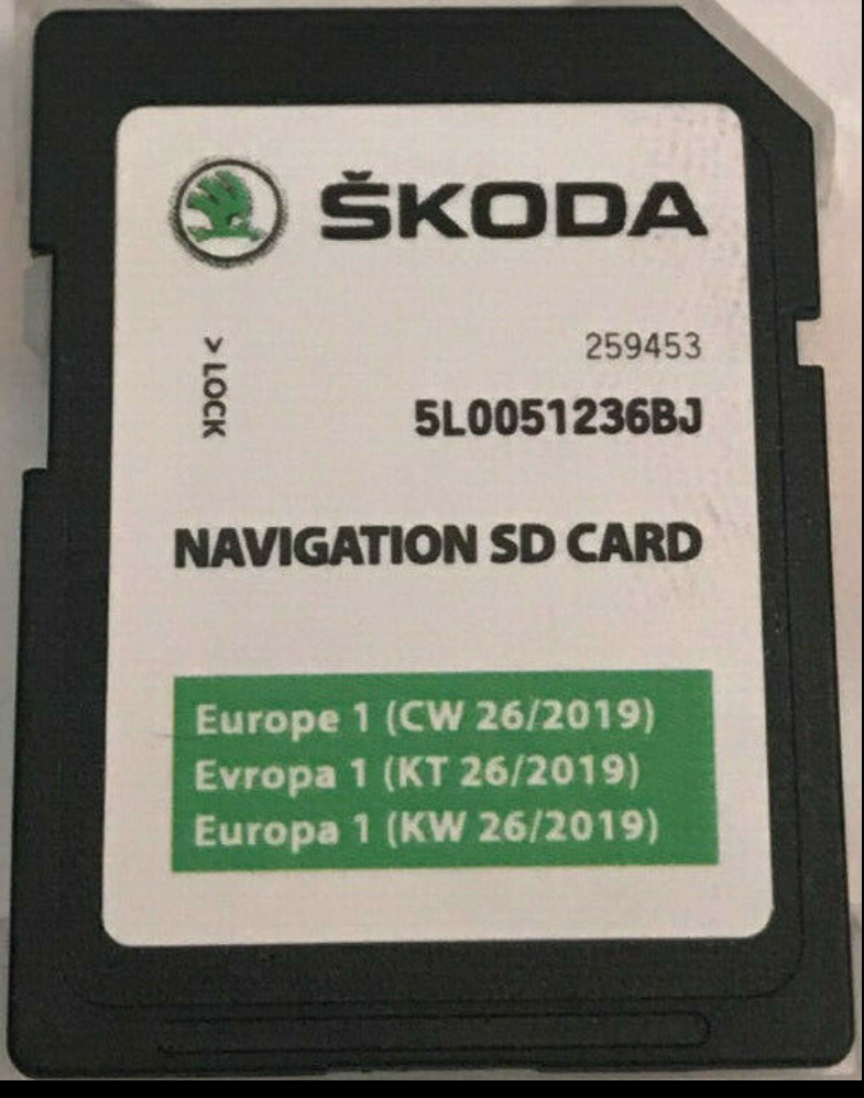

Card arrived. Indeed 32GB which I bought off EBay described as
Version 2020 SKODA GEN2 MIB2 (Amundsen 2) Card Sat Nav SD Navigation
Release 1430 the current release.
These latest 32GB cards are made by Swissbit.
Invested £40 (you might find it cheaper) to test the upgrade to this card for when the all Europe map pops 16gb for those drives across Europe where the released zones wont be much good. Good news its pretty painless and your old Seat card still works. The unit doesn't inherit anything from the card.
I didn't try popping the card in without the overall.nds workaround. Decided that would be asking for trouble. Copied the matching overall.nds file from the original card using the workaround method.
Strong believer of reboots to the system when you change map cards so with the card out, long hold on the on / off button till it reboots, turn off again, card in no problems. Works fine. Do the process again put the original card in works fine.
I was inspired by Godzzi above putting in a VW card without issue. I think for people with fairly new cars the issue would be if you did it without changing the overall.nds file Mapcare might kick in which is why a previous posters plan of getting two cards out of it failed as the unit tethered itself to the new overall.nds. This is the complimentary one year Mapcare you get in the UK. You can't buy Mapcare after that.
As far as getting a 32gb card it's far less hassle than cloning the CID on a Gold card. Cost of Gold card with be similar but with Ubunto / Linux hassle. Suspect these newer cards may be faster than the Samsung Evo 2015 cards which are the Gold cards.

Skoda sector size 512.
Partition goes all the way up to 32gb that you get on fat32 with 256mb unallocated.
Shows as 29.89 gb allocated primary partions, 256 mb not. Under computer management storage.
Shown under disk properties:
Used 15266054144
Free 16815128576
Bytes.
The indexing of Fat32 effects the shortfall of 29.8gb capacity and 32gb. Probably grandma and eggs on this :). So loads of spare space.
Pleased that we have made some good progress on how to sort out missing Mib2 map cards and upgrading to 32GB original VAG cards for anybody with the future need :flag:.
