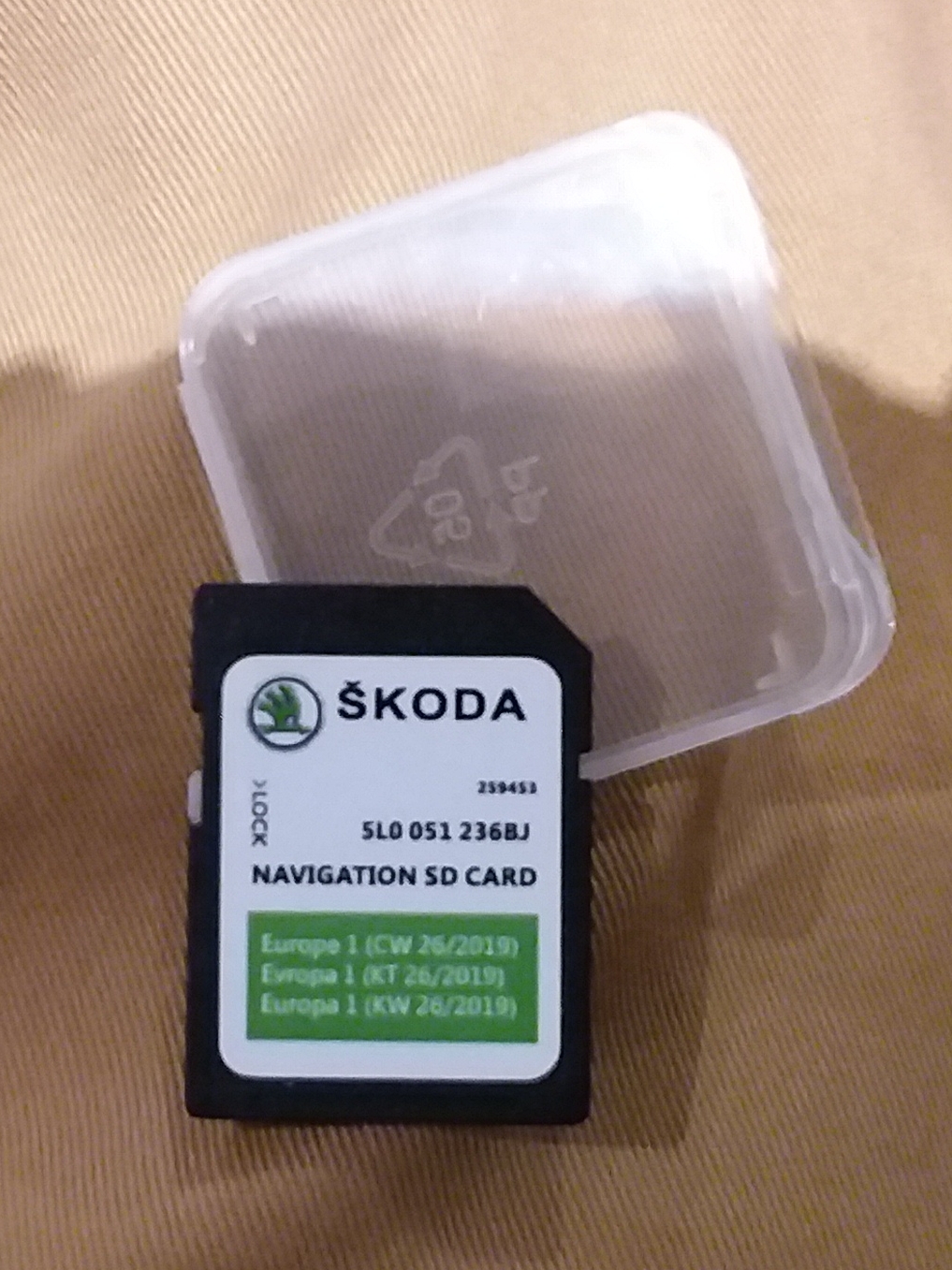

Tell, is your new card part number ending in ‘BJ’ and do you know what the difference is between the ‘BJ’ and ‘BG’ cards? Ebay sellers are showing ‘BJ’ in some of the pictures but quoting ‘BG’ in the description.
I fancy trying one but don’t want to purchase the wrong one.
Jim it's BJ.
The one I got it from had the text of the add correct but the picture wrong in the advert, so when I put the picture up I used someone else's that looked like a fake. This one doesn't. Nicely printed label but no other packaging other than the case and the mailer. Probably how OEM ones come out or someone was stuffing them in their pockets at the end of the production shift.
My picture :).

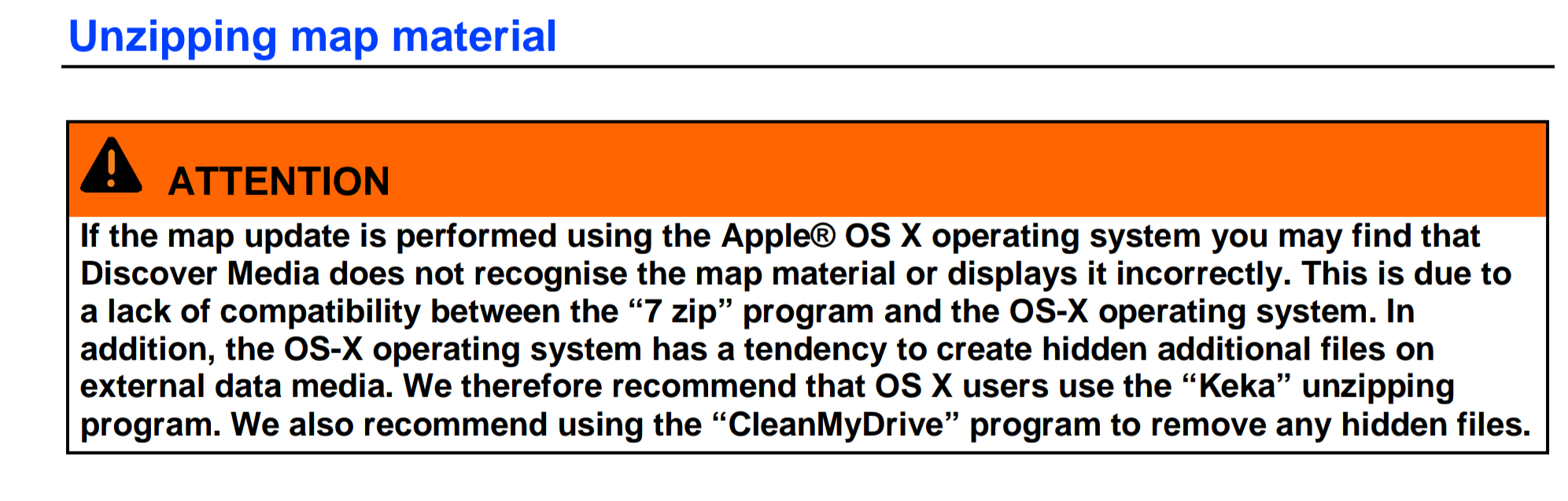

I don't have any access to Windows devices so I used my MacBook Air running MacOS 10.15.3 for the map update. It may be interesting for other Mac users to know what I did to get it to work.
Deleted all files from my current SD card in Finder (after taking a copy of course) and emptied Bin, no formatting of SD card carried out.
Downloaded new maps to my hard drive from the link in one of Tell's posts, extracted to my hard drive using Keka application, removed overall.nds file and replaced with my original overall.nds file.
In Finder copied extracted files to SD card and then ran CleanMyDrive2 application on SD card (approx 243mb of trash files removed). I didn't do any renaming as suggested in some instructions on here.

That instruction is in the middle of the Discover Mib2 update that VW publishes each year which of course doesn't mention the workaround which I republished on the thread. It's the one that causes angst with Mac users although there are other tools for the Mac to get around it but that's the preferred VW way.
Also tells you to stick to Fat32 and a recommended cluster size of 4,096 bytes. If you do a format it preserves the cluster size, can be faster than deleting. The all important CID remains untouched. Thats the only hidden thing on the card. Windows you can do a quick format as long as you have a copy of the all important overall.nds file.

Out of interest I have ordered the new Skoda card from eBay. There is a seller selling the 32gb for £44.99 and another listing from the same seller at £29.99. I messaged him and asked why the price difference, he said that the cheaper one was 16gb but was actually sending out the ‘BJ’ 32gb on all orders at the moment.
There is also an eBay10% discount code until tomorrow evening, so I should be getting the 32gb card for £26.99, so I thought it was worth a punt.
He also stated that there was no need to change any files to get it to work, do you think they are putting V1 of the overall.nds file on all the cards so it will work on any age MIB2?
