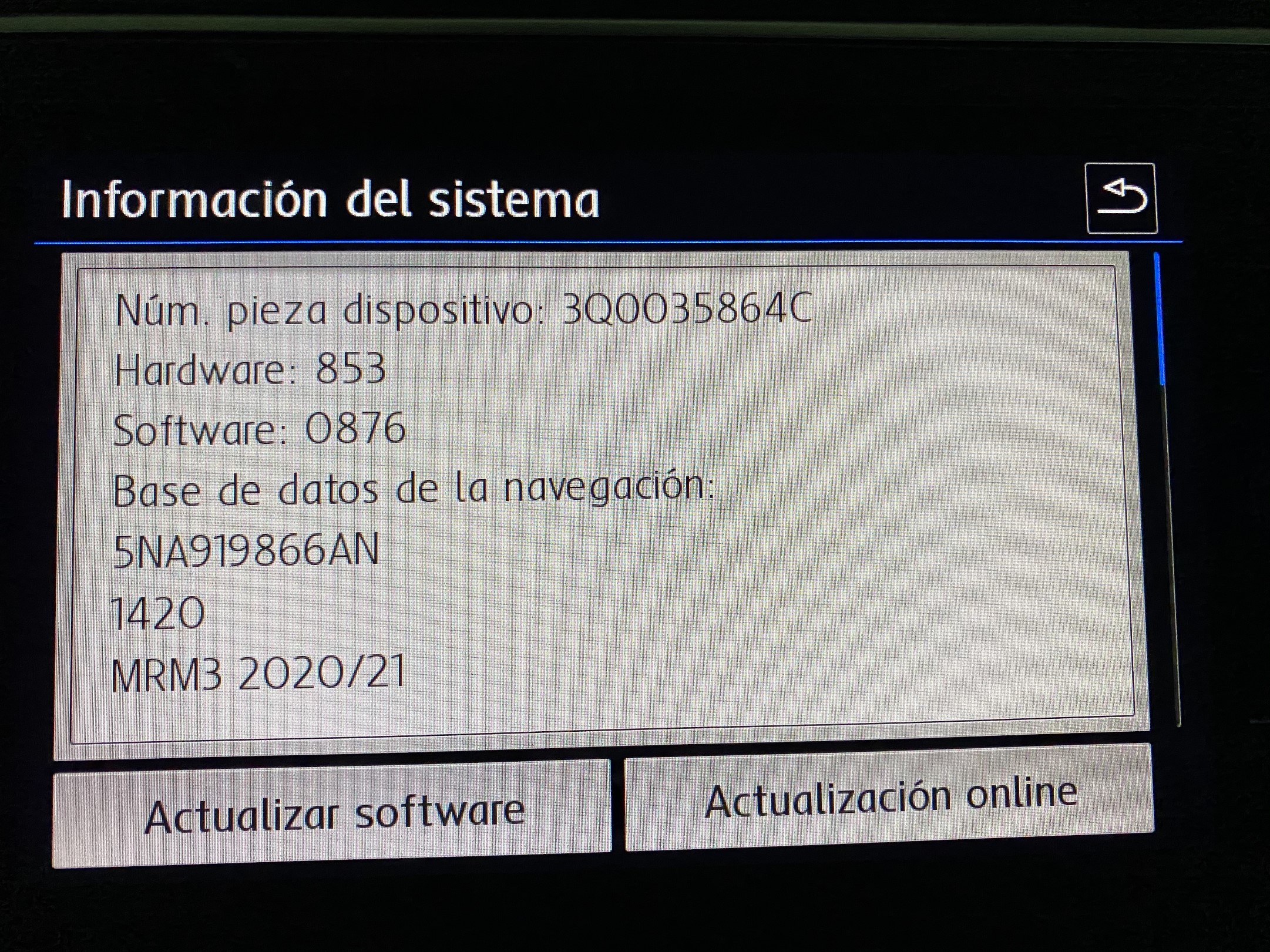

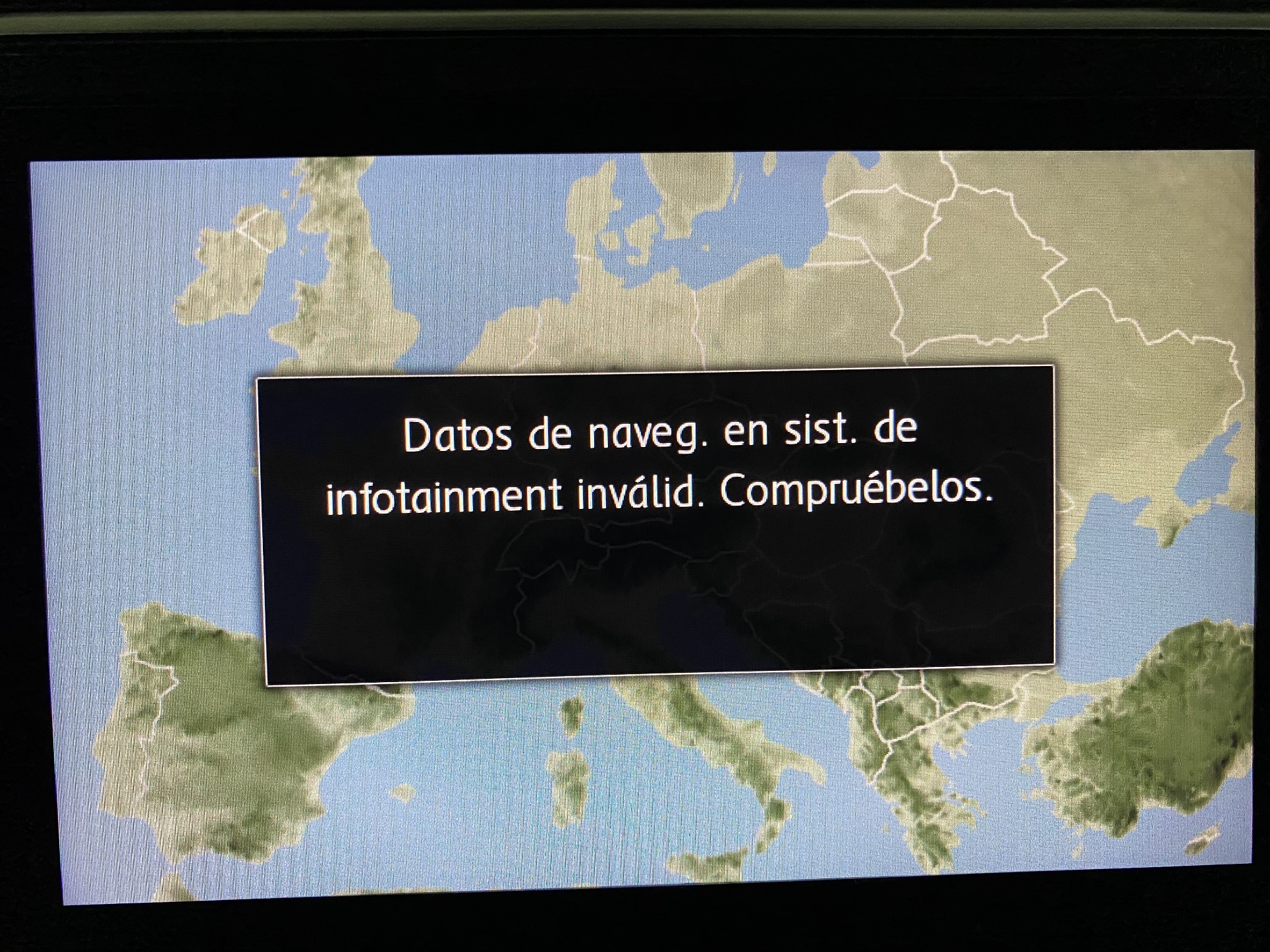

We have a trip to Morocco for work (which will surely be postponed), the case that I have tried to download maps of Morocco, and copy them to a VW SD card purchased from amazon (it worked well with European maps), I have followed all the steps of
https://www.t6forum.com/threads/how...n-eu-countries-e-g-morocco.10331/#post-249128
And it didn't work, then I have replaced the file "OVERALL.NDS" with the original one as you indicate, but I can't get it to work with the Moroccan cartography . Do you know why it could be?
Note: the recently purchased tiguan is not even two months old (DISCOVER MEDIA), and I have updated the maps it had (Europe zone) on another card to Nov19: 1430 without problems.
Thank you very much for the help.
I attach the message that comes out when I insert the card, and when I see the version in settings.

The directory contents of the 27 directory go into the 00 directory as per the t6forum. I took a working card just copied it in. The overall.nds file obviously has to be the one that works with the unit (by definition it was working since I replaced the contents of the 00 directory Edit and EEC but retained a working overall.nds file). I did do a long press reboot so as not to shock the system with such a change.
It did do it without issues. Not a Mac issue ?.
Basically I was on 1430 with an older overall.nds file on a spare card. Working. Then just copied over the 27 content directory to the 00 directory of the rest of the world exc North America 1420 as per the T6Forum.
So I'd say keep it within the 1430 release with 1420 contents. Observe any Mac issues and get that long press reboot in.

Do you have the same hardware version of the infotainment? There is still a recent version so it doesn't work for me ... I have tried everything, following exactly your steps, I do not know what to do:shrug:,

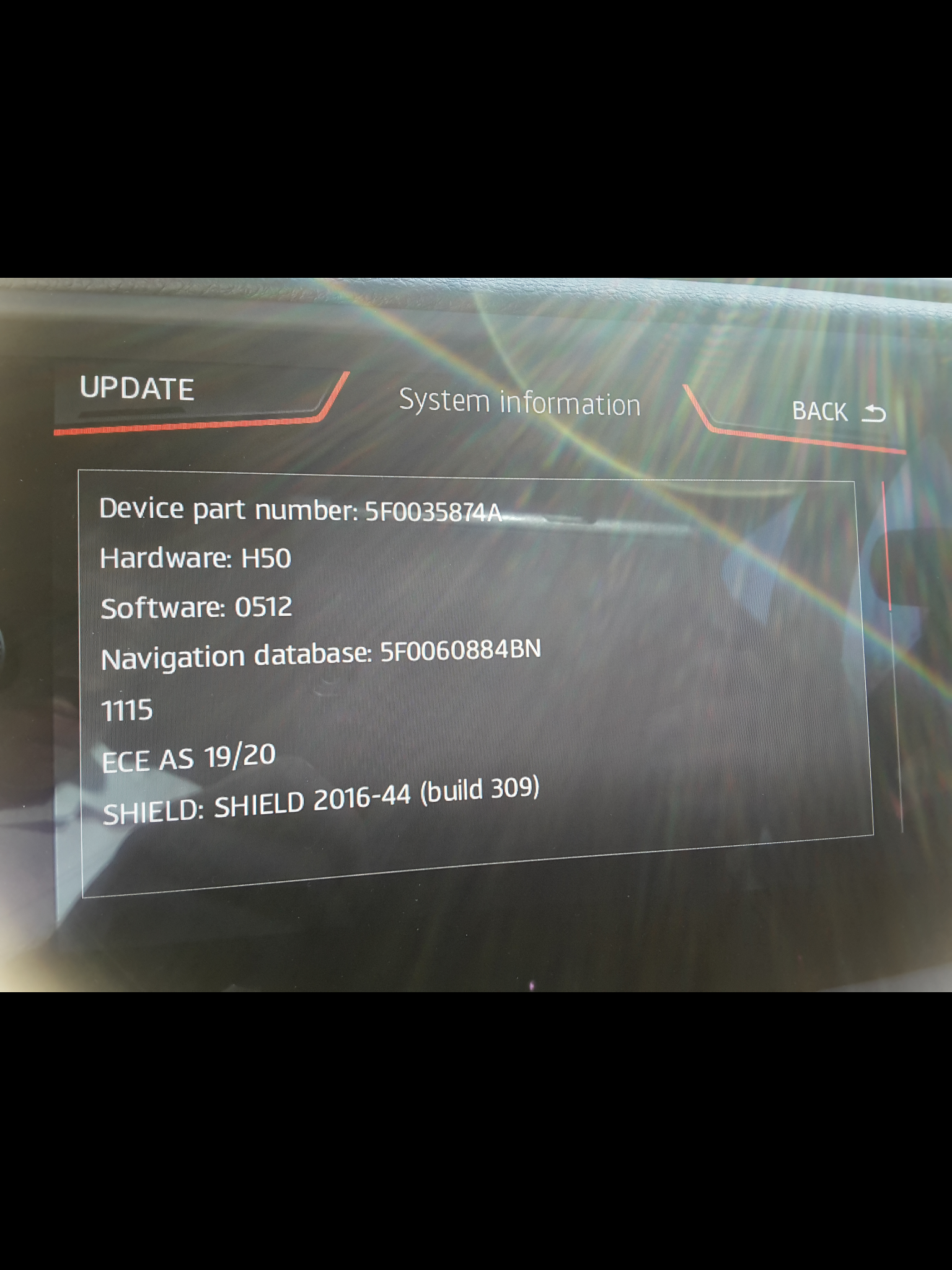

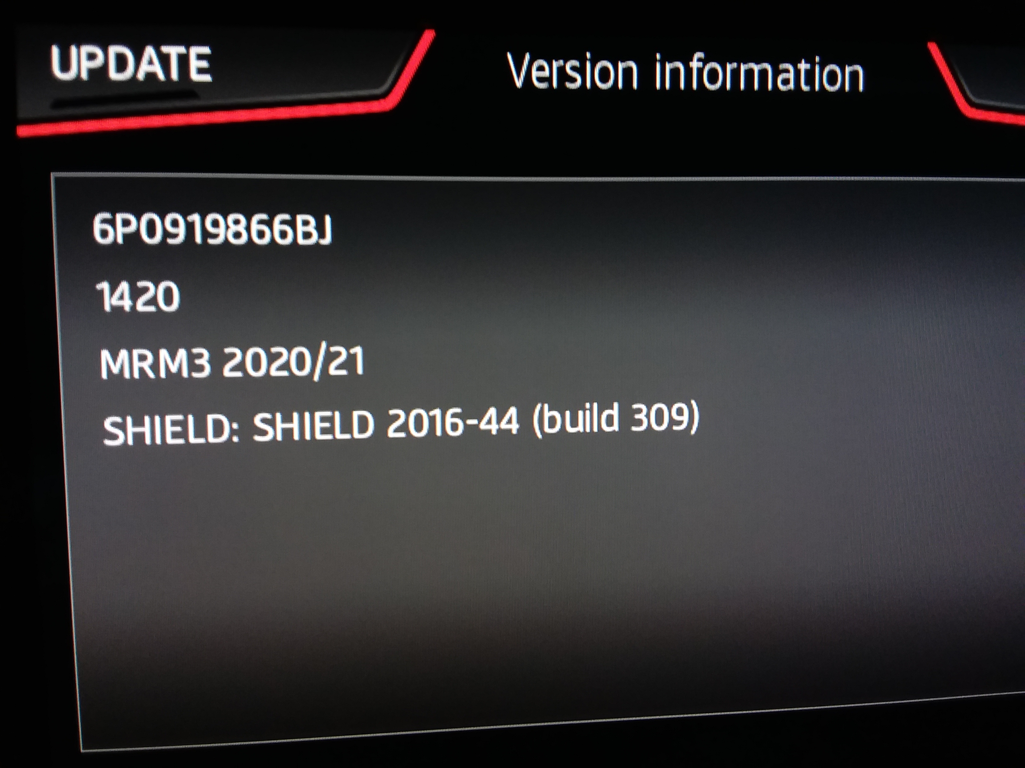

I didn't take a picture with both on together, hardware and firmware + the navigatiion 1420, that's on one from an older picture I took and the one with 1420 component in. 1030 is the release the overall.nds file belongs too.
I had it installed on a Seat 1030 cloned card for what it's worth. Exact replica of the CID on the original. Samsung Evo card as referenced on the thread.
The Seat 5F0035874A unit is a 2018 non WiFi base standard sat nav unit fitted to Aronas. Nothing fancy. H50.
