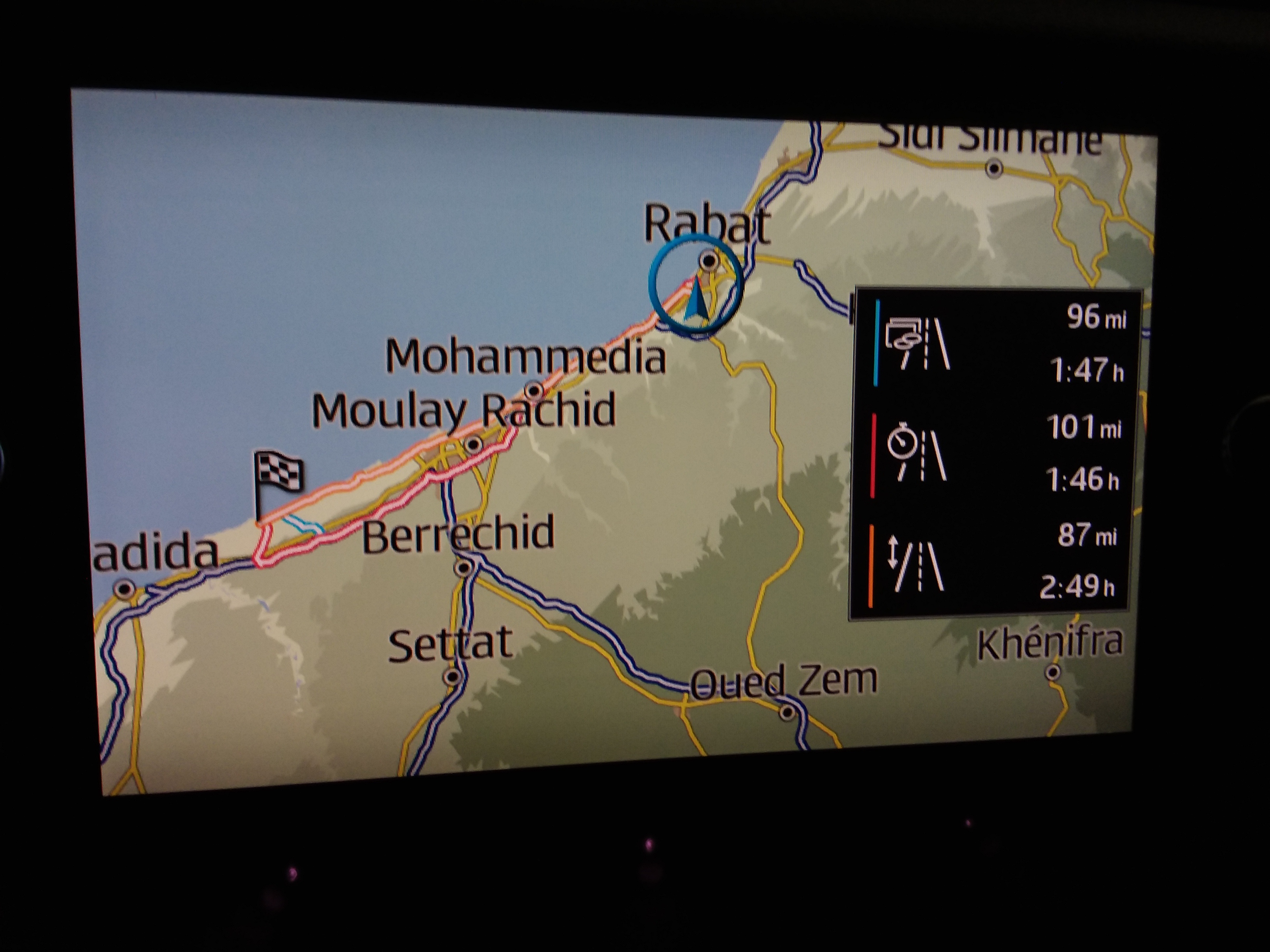

See above I've had the Morocco maps on the European head unit following what the t6forum did, adapted for the workaround without Mapcare. With this I've now edited the above to exactly what you need to do if you have a US VAG card and head and want European Maps. Least I think that's your best chance. I can't see why it won't work. Those same principles should work for any car with sat nav shipped between zones.
We change the 00 directory to 01 in your case and deploy the "workaround" in case your US VW never had Mapcare although not sure of how it would react if you mixed a Europe overall.nds file with a US one. Probably wouldn't like it so you probably need step g. In.
Probably post some pictures on here of the Morocco map for disbelievers ;) - demo drive via the advanced menu. Handy for people who want to add their Leon in the Dakar rally :sleepy:. As per the link it's been used by someone that exported their car to NZ from Europe.
Basically I can't test the 00 -> 01 since I don't have the US VAG equipment or card but did do the Morocco on the 28->00 so must work the same making the US look like Europe... 00->01.

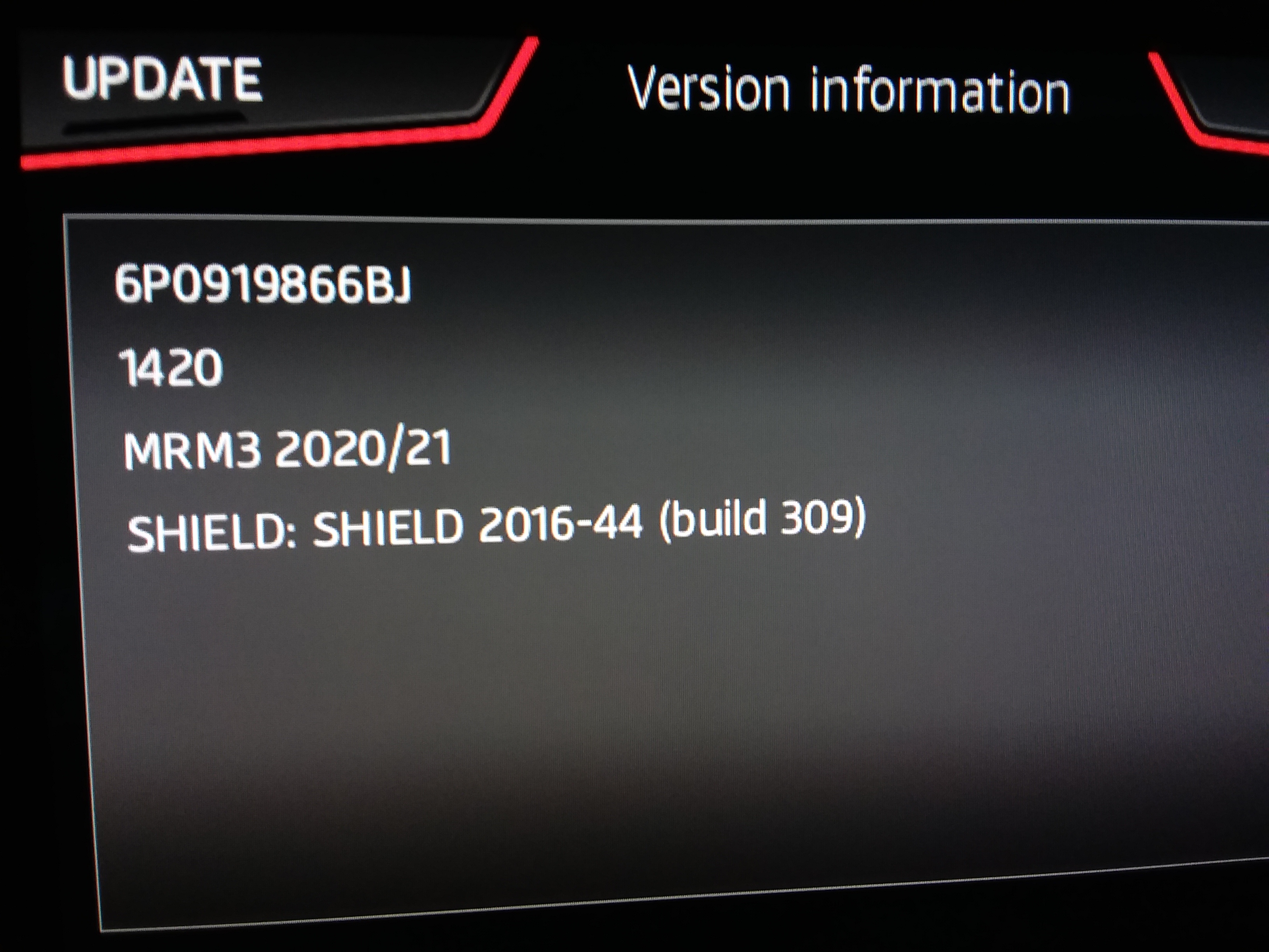

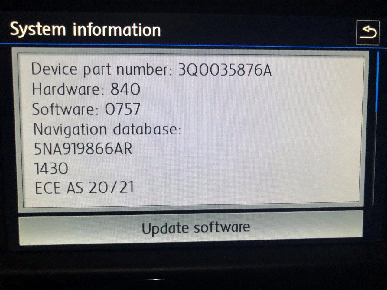

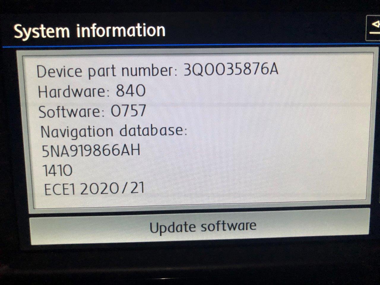

Images attached a Morocco simulated drive and the Map file version I used from the VAG website for the rest of the world on Seat standard unit. For the others in the group you identify the country code.
From Non-European Countries – Bundle 3 - DiscoverMedia2_MRM3_1420_V12 .

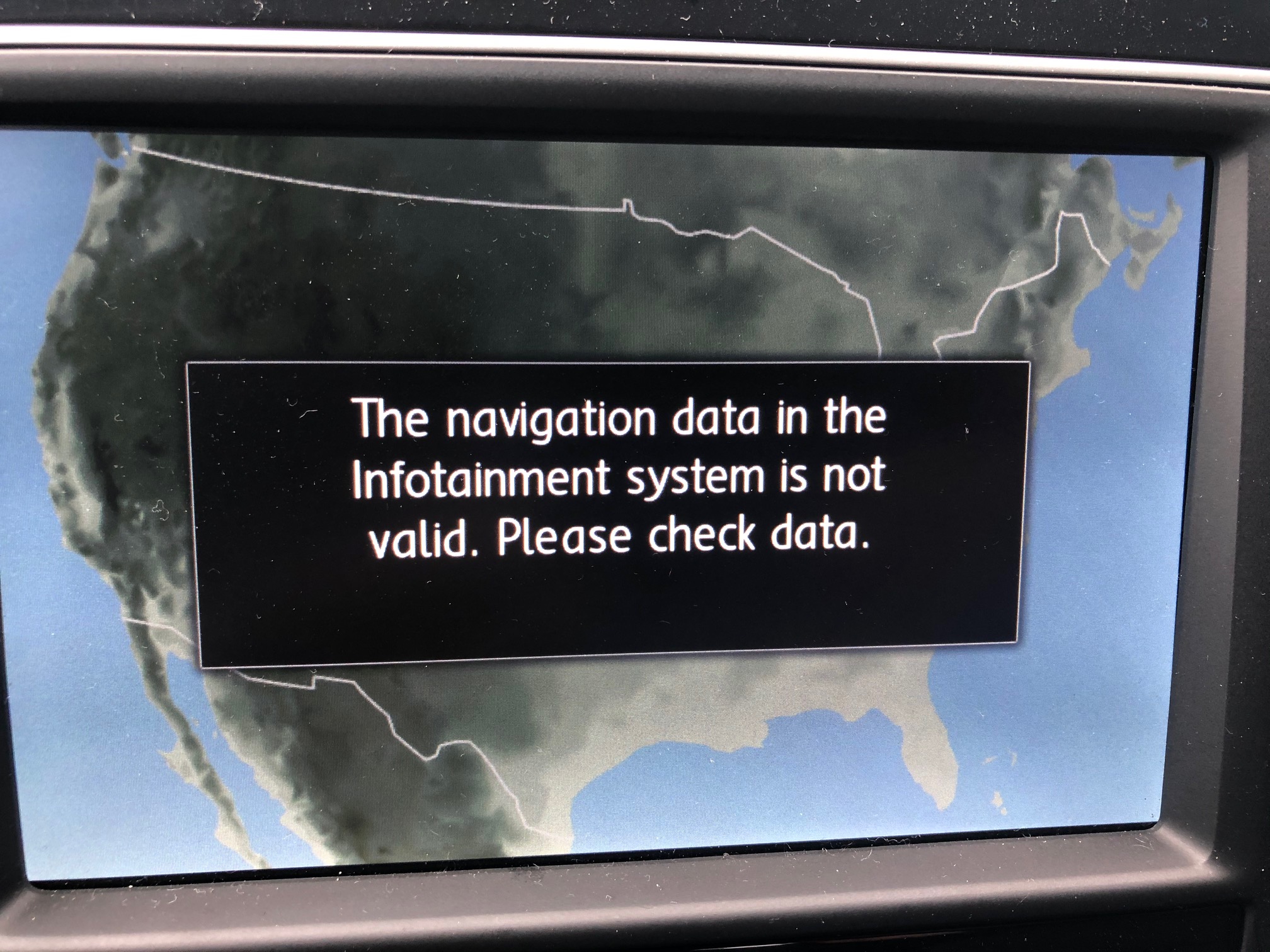

Well I followed your instructions:
1. Backed up data from original North America (NA) SDs
2. Downloaded DiscoverMedia2_EU_AS_1430_V12.7z from VW DiscoverCare to G/Discovercare/Data folder on my Windows based computer
3. Unzipped the above file to my hard drive DiscoverCare/Data folder
4. Renamed the DiscoverCare/Data/maps/00 folder to 01
5. Inserted unlocked original NA SD in the computer and deleted the maps folder
6. Copied maps folder from HD DiscoverCare/Data folder to the SD
7. Copied original overall.nds from backed up copy to maps/EEC/EEC_WLD on NA SD
8. Confirmed file structure on NA SD
9. Ejected SD and locked SD
10. Reset Infotainment system using Power Button hold method
11. Inserted SD in slot 1 of MIB2 and received "The navigation data in the Infotainment system is not valid. Please check data." error.
12. Tried power button reset a couple more times, and inserting SD in slot 2. Received same invalid data error.
Any other ideas...

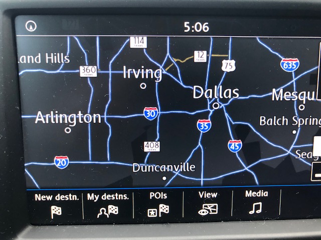

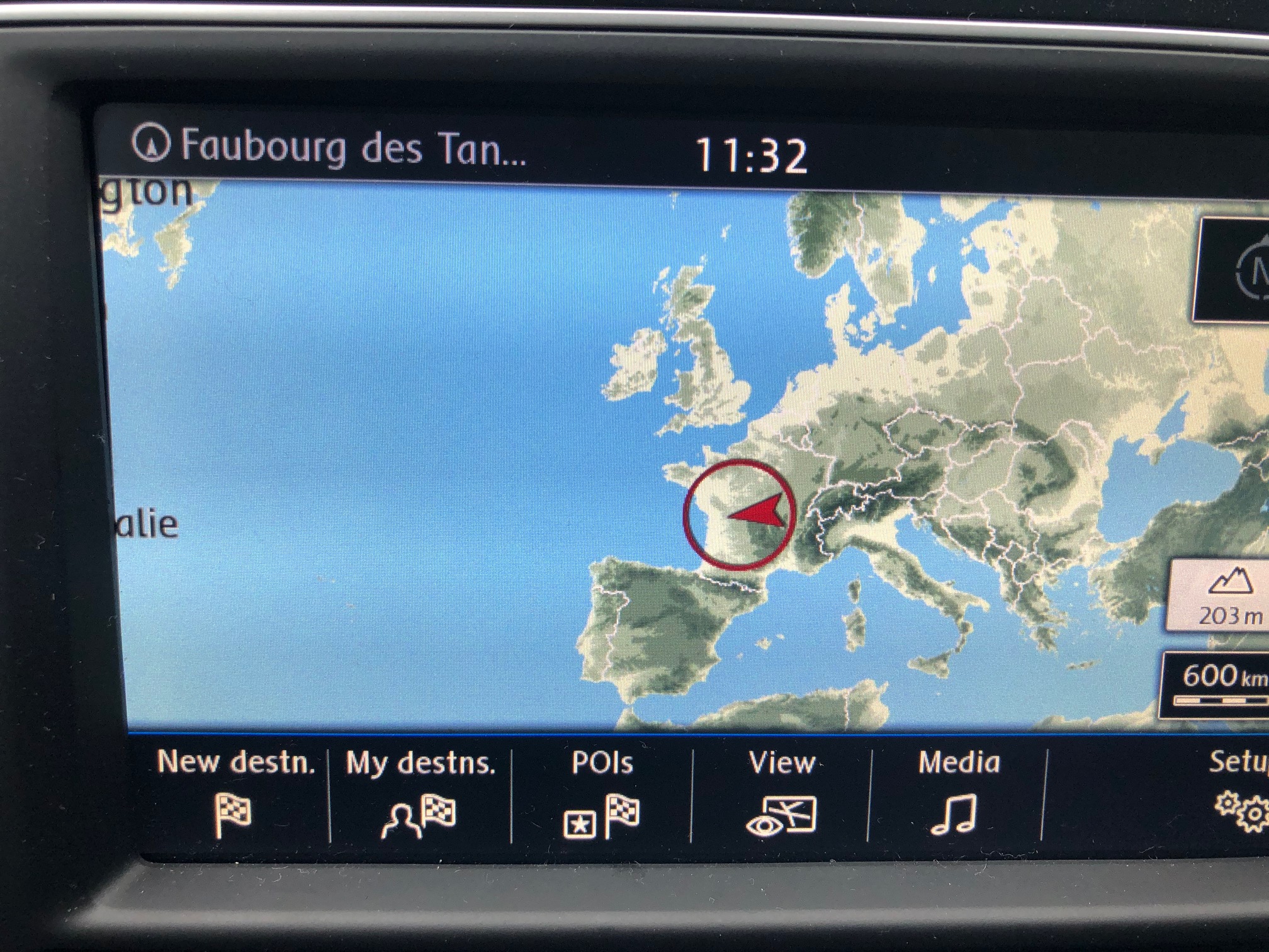

FYI - I've included a couple of pics that show that the original NA SD is operational
IMG 2119 is a pic of the error
IMG 2120 is what I show when using original NA map, shows that the car is in France
IMG 2017 to 2072 shows that original NA map SD is able to see US States/Cities/Roads
Thanks,
Ron

Hmmm.
Unless anybody can spot anything else.
You could try the European overall.nds file from the Europe download just in case it behaves differently with the US one although perhaps unlikely. Weird that the rest of world files work with the European one but not the other way round.
It is quite sensitive to the odd mistake, either works or it doesn't. You could try your other card.
Given that VW pulled out of mib2 discover media updates in North America one wonders whether there was an issue with the product rather than the lack of interest in North American maps.
Feels a bit like clutching at straws you could try the European download keeping the region as 00 but with your overall.nds file. There was an assumption that it looked into the 01 directory. Perhaps it doesn't. The Morroco fudge was to put 28 into the European 00 directory given it was configured that way.

Tell,
I did try my other NS SD (I installed European software version 1410 on it), and I received the same invalid data error. I'll try the second SD with the 1430 software version and see if that will work. Funny, I checked the System Information and it does show that the European software as being loaded.
Note: I did not have the second card activated, it was a ebay purchased card.

Tell,
The work around using your overall.nds file bypasses the need to have it activated. That's assuming the workaround works the same on US cards as European ones. So you would use your original overall.nds North American one although I'm not holding out high hopes on that.
More reading I see mib2 North American maps must have been relaunched again after they were pulled from marketing. There are no download files for them it's a dealer visit to get a card and activation suggests that Mapcare isn't supported.
Critical that you dont mess up your backup given you can't download them.
When it identified the 1430 maps it means it read them in. Presume in the 01 directory. Expect it would not do that if you had then in the 00. So finding them means it's found them and if it's in the 01 directory and not 00 it's looking in the place we would expect.

It could be the CID on the card restricting you to North American maps whilst this isnt the case for the European card on Rest of the World maps. Thus if there were no other issues and you want to continue this then the best bet is to go down the "gold card" route. Post 1972
https://forums.seatcupra.net/index.php?threads/navigation-system-updates.388586/page-99
So you have your North American card working again, restored the files so the unit is happy with it. Then clone it. Then edit the CID with the zero fill as talked about. See whether that helps. It is clutching a bit at straws but that post does suggest that zero filling removes restrictions on regions. Could be a red herring thou.
It also revolves around your original overall.nds file whether the firmware in your unit behaves the same as European firmware and they haven't triggered the file off at a different position. Exciter noted that each release moved down a bit in its location in the file of whatever it was doing which might be the key of how it works. But nobody from what I've read has decoded it, least in 2017. It uses a key. Heuristic solution was found by Exciter with some analysis whilst Notoben was busy trying to decode it when Exciter arrived on the thread. He used Binwalk which presumably pointed everything at the file.

So it could be that the North American file belongs to a different starting point in validation or it's reading the CID last strings of characters that steer the unit - that's what was suggested in the link above. Zero fill is said to stop that.
I haven't found a download of the North American maps, 2019 is out there but a site wanted a fee to give the link so didn't bother. Would be interesting to find out whether European units can read those files since it can read the rest of the rest of the world ones.
Lastly the other thing you could test is whether your overall.nds file from NAR card that works copied to the following year(s) NAR card "un activated" makes it work. If not then clearly the behaviour of the North American cards is different from the European ones.
My MIB2 unit is from 15/16 (week/year) - retrofit in progress .
It came without SD card so I get one 6P0.919.866M - v4. But it seems it was too new, may be the original one was v3.
So I use overall.nds v1 from 0430_MP143-1248.0EUR and it work.
Probably v1 overall.nds will work in all cases.
Edit: latest 1430 map with v1 overall.nds work like a charm.
So combination latest map + v1 overall.nds will work on each MIB2 units regardless of the year of production.
That's the recommendation. Historic ones work from the one activated. It's a feature of mapcare on the high so deduced it would be the same with the standard. You can always load up old maps. We did a few tests. So if in doubt go back to V1 if you have lost the file.

Ok good. That's improved the knowledge base. I thought you could go backwards with the overall.nds file if it followed the same design as how mib2 high works. What that means for anyone in a similar position would be to take the file from an early release rather than try to guess which release it was. Then just use that with the latest download.
All good stuff. I guess all these cards have a recognised VAG CID on them. This is probably why Exciter scrubbed out the CID in the image since he knew it was useable if you went down the gold card route.
Oh well I've bought the 32gb Skoda card for 2020 off eBay for the hell of it :).
32GB Version 2020 SKODA GEN2 MIB2 (Amundsen 2) Card Sat Nav SD Navigation. That would be the option for those that want to drive across Europe when the all Europe map pops 16GB.
Card arrived made in Germany by Swissbit.
Let you know how it goes. Partner won't be a happy bunny if I mess their system up. Never drive across Europe in that car in any case, backache.
