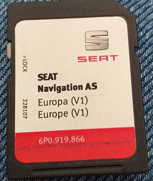

i think mib2 is a system,(seat leon 2016).
SERIAL: 6P0919866
maybe it would help only original OVERALL.NDS ?

I did wonder whether you meant V1 mib2 card.... Thinking about was going to cut and paste an eBay picture up for you to check. Right you beat me to it... now I'll attempt to research the VW / Skoda download of it. You will know you have it when you see the part number in the file as the post above. Seat runs to a different version number to VW on the printed SD label.
Basically you need the download file for
Europe West V4 0521 ECE1 2016
which was released circa November 2015.
or some kind soul in here to message you the overall.nds file from that card or just buy an ebay card and lift of the file for your card....
search continues.

OK well I've found the download now thanks to the very good Skoda German board that has a similar thread that has the history in it !!! :)... very useful to map the twists and turns.
http://infotainment-cdn.skoda-auto.com/base/maps/0521_MP151-1205c.xEUR.zip
That is the Seat V1 Mib2 card. Put that onto your blank card Seat... test and then get back on track on the instructions above.

You are an amazing person,
thank you so much for the links.
i will download the contents, copy to the original card and check the result.
I'll come back with feedback,
thanks again

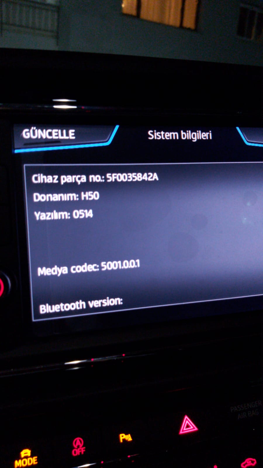

Feb 7, 2020
Gentlemen, I have bought Leon 2020 yesterday and it came with this Easy Connect system, which I could not found information if this is Mib 1 or Mib 2. Can someone make any comment?
Hardware: H50
Software: 0514
The car has virtual cockpit as well.
Dealer is also not aware if this system is Mib1 or 2. It does not have Nagivation menu button on the screen.
My aim is to be able to retreive the Navigation menu by OBD11 or VAGCOM and install the related map. And reflect the navigation to the virtual display.
Can I do it with 5F0035842A?
Cheers,

I think you will be disappointed. It's a mib2 but basic system. The last part number you gave, top line is the hardware box of the unit. You Google that.
https://picclick.it/5F0035842A-Seat...dia-Navi-Mib-2-264286146357.html#&gid=1&pid=1
That gives you four clear images of the unit. Connection at the back. I reckon you will find you dont have navigation socket on there. Searching around for other back plane images.
I did find the spec build codes which were without navigation so pretty sure.
https://www.oemvwshop.com/5f0035842a-control-unit-for-information-p2251485/
The mib2 navigation license is heavily controlled so without it you are a bit stuck. You'd be even more stuff if it didn't have navigation socket on it....
Think easy connect refers to integration with your phone. The goodies were rolled out piece meal as licenced features. Now you can get the lot with topping. The FEC Swap codes are the controlling features so whilst things can be turned on by protected methods if the hardware isn't in the box it's not going to work. That's the other way look at the Swap codes and check Youtube videos as to what you have. There is a list of installed and what can be installed. Decode those. If it's not on either list, its not going to happen. If it's on the not installed list, you'd be seeking a wizard retrofitter I reckon as a dealer possibly wouldn't want to know.
Some VW info on FEC / Swap codes... Seat ones are different, principle the same. I posted up the Seat Mapcare high ones once I worked out how they worked. I'm sure the standard mib2 Seat ones are on the net somewhere:
Knowing what the code is, is different from being able to action it.
Yay.. as the youngsters say you are missing out on the blue one, GPS
https://www.briskoda.net/forums/topic/450799-connectors-on-mib2-unit/
Picture of the back off a full spec mib1 standard on this link, got blue, yours hadn't.
https://www.ebay.co.uk/itm/SAT-NAV-...787090&hash=item216642fbff:g:xGAAAOSw~8ld1~i5
So yes, not possible.

Hi,again
feedback:
content 0521_MP151-1205c.xEUR. does not function in the original v1 card.
I tried restarting several times but the device does not accept.
i wonder if it would work if i buy another v1 from ebay?

Did you use a Mac by any chance although if you used the second link that called the Skoda download manager which if you continued would unzip directly onto the card bypassing anything a Mac could introduce into the process.
SD Card unzipped should look like
Map directory etc.
The serial number on the download did tally with the one on the card. If for example Seat re-released it still keeping that part number but different overall.nds file by poor control management of their releases I could see that it may not work. I've got back a number of people who lost their back up by this method of going to the identical Skoda / VW download as the Seat card.
You could try a Seat V1 mib2 card off eBay but yours will be paired to your card's CID. So you would need to copy out what is on your new bought card onto your old card.
So if you are sure it's not a Mac issue and you used the second download method and still doesn't work then you could try that. Of course someone somewhere could have been clever and registered something other than what the card says on it to your car.
Fail all of that you could present the bought eBay card to your dealer and ask them to install it rather than having a new card that doesn't work. Then you have the workaround method to do the update yourseld. The Mac steps are on the thread.
That's why it's imperative to copy out the contents of the card via a directory copy because if you dont you are reliant on finding the matching download that is registered to the car. We have succeeded up to now with mib2 but always a first time.

Thanks for the reIply,
I'm not using a mac.downloaded the link directly to the zip archive (no downloader)
now i will try to download with downloader,and try
thanks again

yes, i will do that.
Now I checked the label in the folder map dbinfo.txt
PartNumber4="6P0919866D"
looks like this is a slightly newer version, mine has no D,
maybe that's the problem

I had noticed a small character difference but thought not important perhaps as a print error. I'm sure the one before would have a much greater difference in characters.
Seat never saved their releases on a server over history. May be they were up to that resent trick of not keeping in synch with VAG then.
You could appeal for someone with mib2 Seat V1 card to give you a copy of the overall.nds file. I'll have a look at the six month release prior to this tomorrow if I can find it. You could check filesharing methids just in case it's been uploaded.
Probably buying the card will fix it and doing the copy as I said so it's then on your old card, CID will agree.
Hmmm
Did find this post
https://www.seat-forum.co.uk/forum/viewtopic.php?f=15&t=794221&mobile=off
That would place it as
Navigation database: 6P0919866

I'll look for 0430 in the morning. Would have been released June 2015. Since Seat were late to Mib2 perhaps the VAG software people kept the part number static for a bit and just altered the end character.
(Looked late at night and didn't have success think it falls between Skodas update portal at the time, Skoda servers at the time and VW altered their links so I don't think it will be found on VW servers)
VW card part number 3G0-919-866-H from
http://wiki.ross-tech.com/wiki/index.php/VW_Navigation_System_Maps
Known as VW V3 mib2 ECE 2015/16 with part number.
People have looked for historic downloads connected with a period of VAG navigation issues which has passed but you have to crack the filename to the download since VW have moved things around for historic files.
Example here
https://www.trocforums.co.uk/viewtopic.php?t=1394
Suspect that Skoda Amundsen mib2 didn't arrive in that year to Skoda so the link you can't find. Suggest you buy a Seat V1 off eBay. Copy the contents out. Copy back onto your old V1 card. Try. If it works do the workaround to get yourself onto 1430. I've giving up the search. Moral behind this, always back up the card before the workaround if you don't have Mapcare.
Hmmm
Did find this post
0430
ECE 2015/16
i think i found it
http://infotainment-cdn.skoda-auto.com/base/maps/0430_MP143-1248.0EUR.zip
