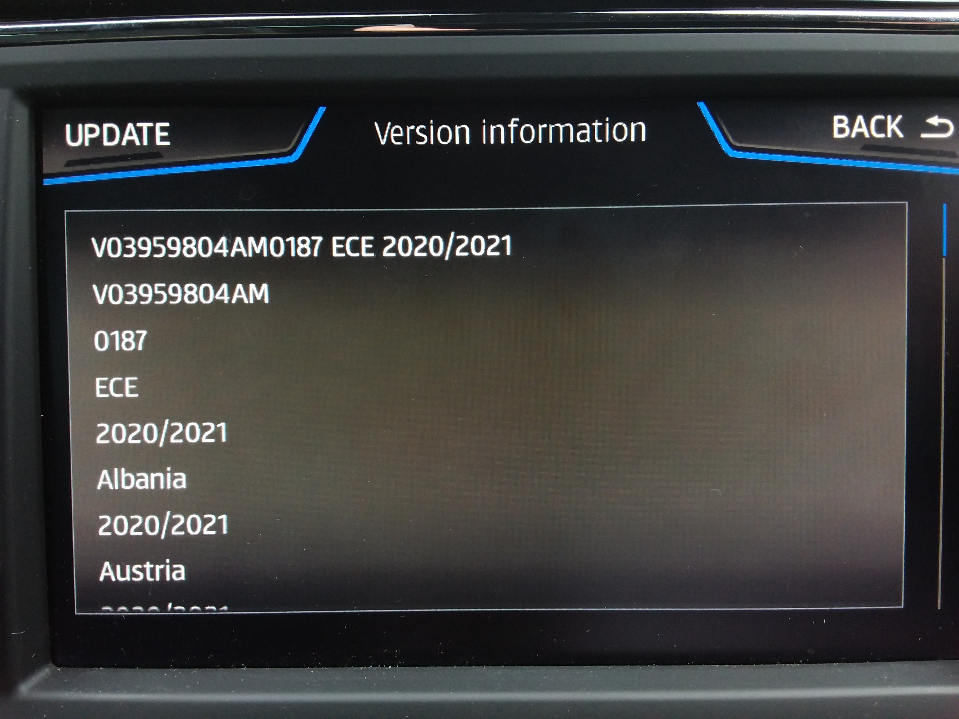

Worked fine for me. No problems since my FeCs are fine :).
Reactions: Med and Walone
