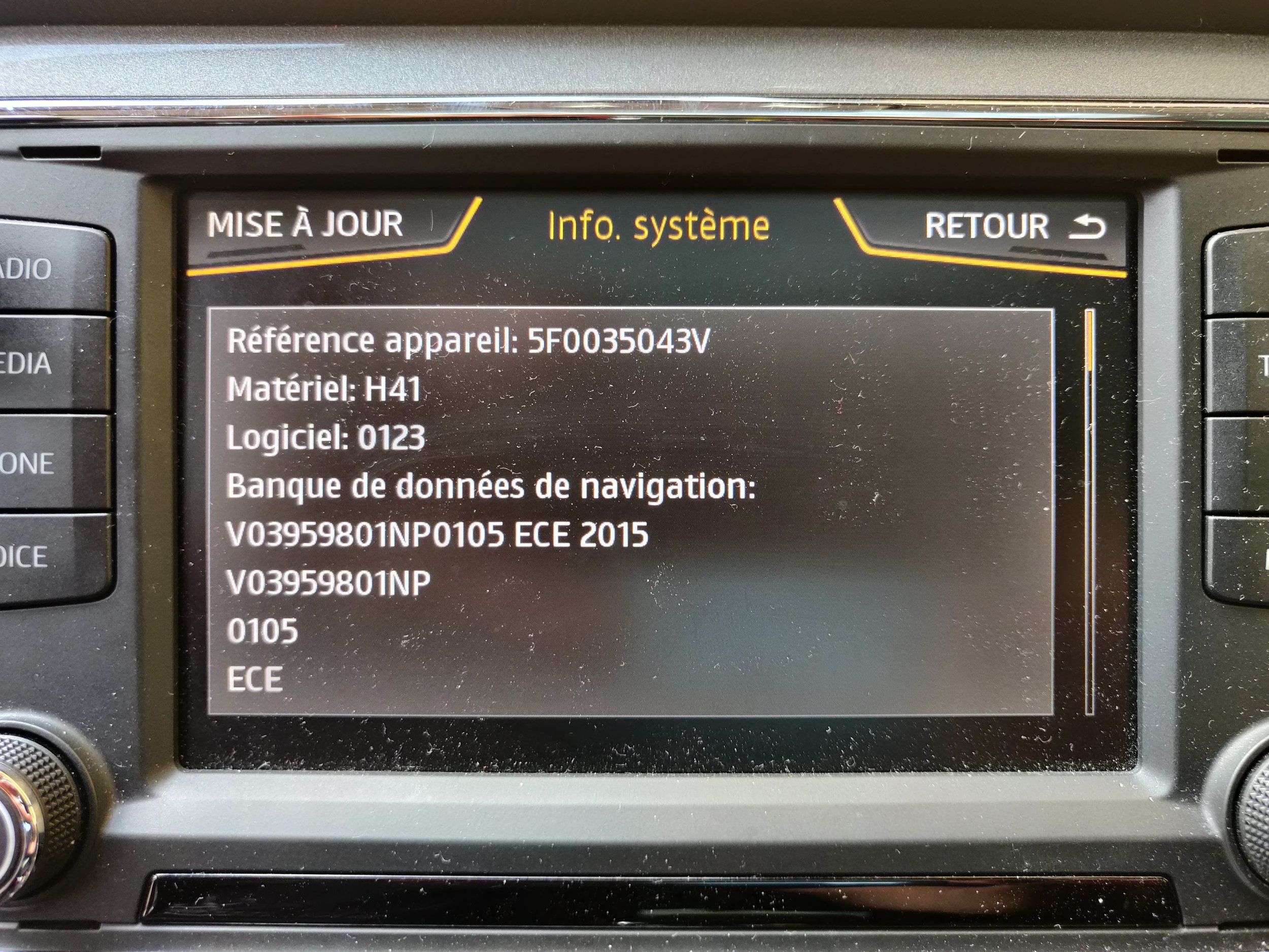

Hi all,
I'm the happy owner of a Seat Leon ST 150 Tdi from 2015.
I have the Navi System Plus (with hard drive) and NO mapcare option that was not available when I baught the car...
I spend 3 hours reading this thread and others on the web and I have to admit that I'm lost here...
Here is what I have in my system and I'm looking for how to update to a newer release for free.
What do I have to download and maybe doing for being able to update my system please?
Thanks in advance for your support!
Olivier

Hi Tell and thanks for your answer.
I did check going in the Services Menu but I only have two options : Update and see HMI versions. I don't have the option Function enabling codes (FEC, SWaP) .
Maybe my software release is too old? But it seems I can upgrade it thru the Services Menu.
Do you know where I can find a up to date release please?
Tell
Full Member
Why I gave the details of how to dig yourself out of a hole after temptation got the better of you was for that reason. You would have to find the serial release you are on before ECE 2015 before you upload any new maps if you havent had your FeCs changed since your unit will lock up navigation. Odbeleven will enable the service developers menu, post 34 other VCDS tools may do the same:
That will give you the retrofit Swap menu but won't change your FeCs so you are stuffed if you upload newer maps hence why you need to have found your release before you mess it up !. Been there, done that, locked myself out for a month.
I have a post on here of my experiments, post 699 and the one after:
You will be able to mess your unit up if you do that !. You need the ECE 2015 link which you need to find so you can restore it back again if you load up Navdb where you do not have a valid Navigation FeC that covers a newer map release. The backend ruthlessly locks you out of setting a navigation route by suspending visual navigation, voice remains present.
The good point is you have access to the Swap menu of what it will look like if you get your unit converted into a retrofit but otherwise you can't do anything else. If you use a Mac beware of the CleanMydrive stuff and the substitute of 7zip. The Mac garbage just one byte change will render the import useless since it will fail the signature check.
Jun 28, 2020
Hi Tell,
Thanks again for this detailed answer. This is far too complex for me... I'm going to see with my garage and ask them to upgrade if it is not too expensive.
I was expecting to do it for free as the car is 5 years old but what you explain makes me giving up that project.
Thanks again and hope you will find an easier solution maybe ;)
