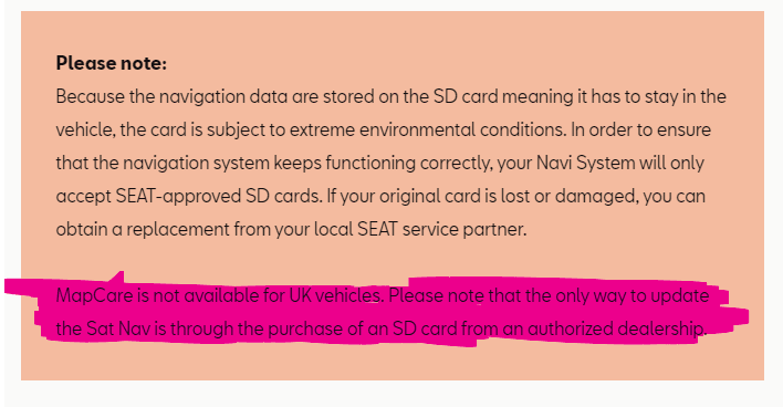

So I tried my first update since getting the car last night. I followed the instructions on the Seat website. Copy files from SD card to a folder on my PC (back-up), Format SD card, UnZip downloaded file from Seat website, drag and drop new software onto SD care, Eject from PC but the car gives a message "SD Card: Error". When I go into settings and choose Update on the System Information screen it says the same. Can anyone help and tell me where I went wrong please?! Much appreciated.
Did you make a back up of your old memory card?
Surprised website gives those instructions as was under impression Seat UK does not officially let you update maps with out buying a new SD card from the dealer.
If you've made a backup there is a file you need to copy from it and put into the new map pack, this then makes the unit think its the original map set.
Yeah I copied everything from the SD card to my PC before doing anything.
These are the "instructions" I used https://www.seat.com/owners/my-seat/navigation/resolve-doubts.html
That sounds about right, I wasn't 100% whether or not it was a full replacement or more of an extension to the old pack if that makes sense? Do you know which files I need to keep?

That's good :) we can get you sorted, I just need to find the instructions in this thread haha!
Its helpful of Seat to put this very important piece of information at the bottom of the page...
