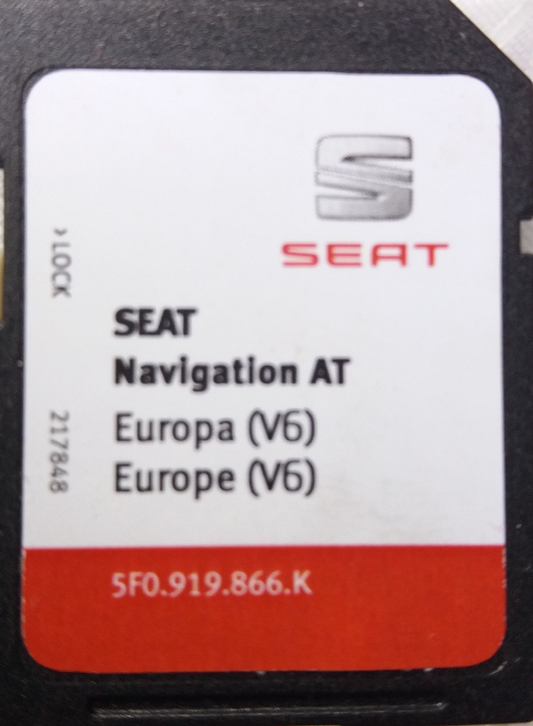

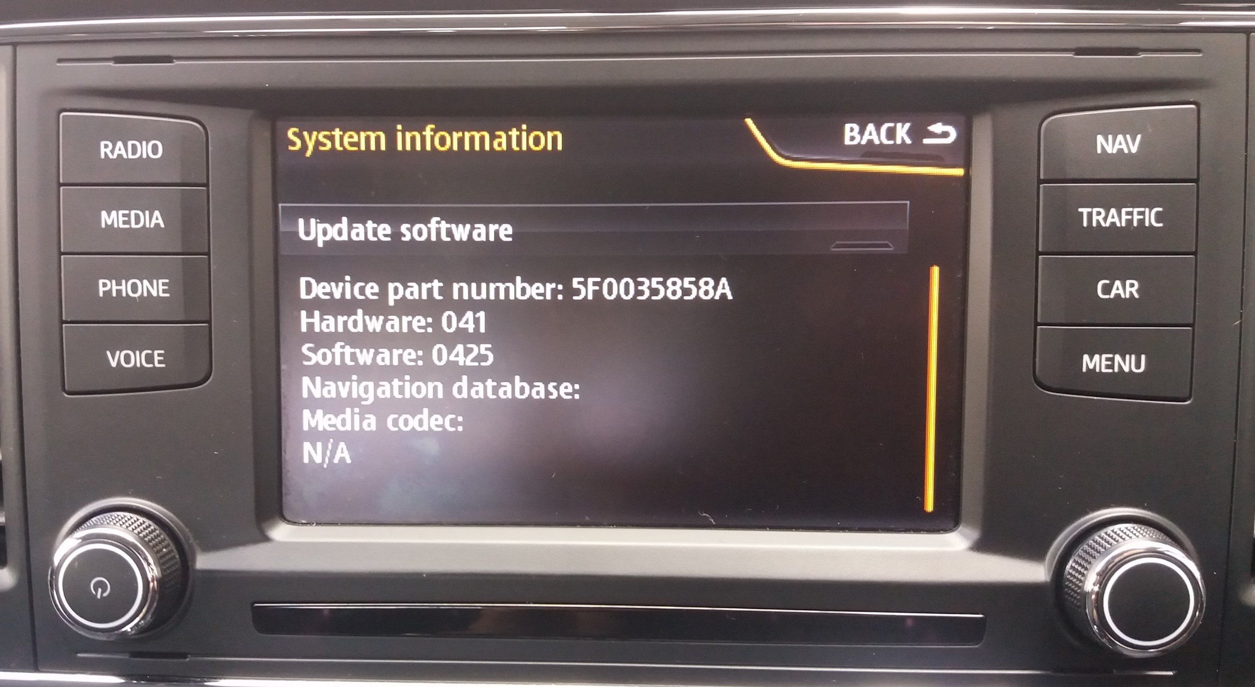

Hi all, new to the forum.
Bought a 2015 Leon TSI SE just yesterday.
I'd like to update the sat nav as it is outdated, but I'm struggling to work out which version I have.
Is mine a Mib1 / RNS 315 and would it work with this replacement?
https://satnavstore.com/ALLCARS/Sea...S315-V12-NEW-SD-CARD-MAP-SAT-NAV-UPDATE-EU-UK
Alternatively, can anyone kindly point me in the direction of a link to Skoda or VW compatible map data where I could update my current SD card, please?
Many thanks.

Nobody has been able to use DIY techniques on standard mib1... the holly grail of the thread in it's early days. Only mib2 standard where you can do anything yourself (thanks to Exciter) other than that you are off to a dealer. Have been instances where people buy them off the internet then turn to a dealer to install.
Disappointing to discover that is the case.
Thanks for the info.
