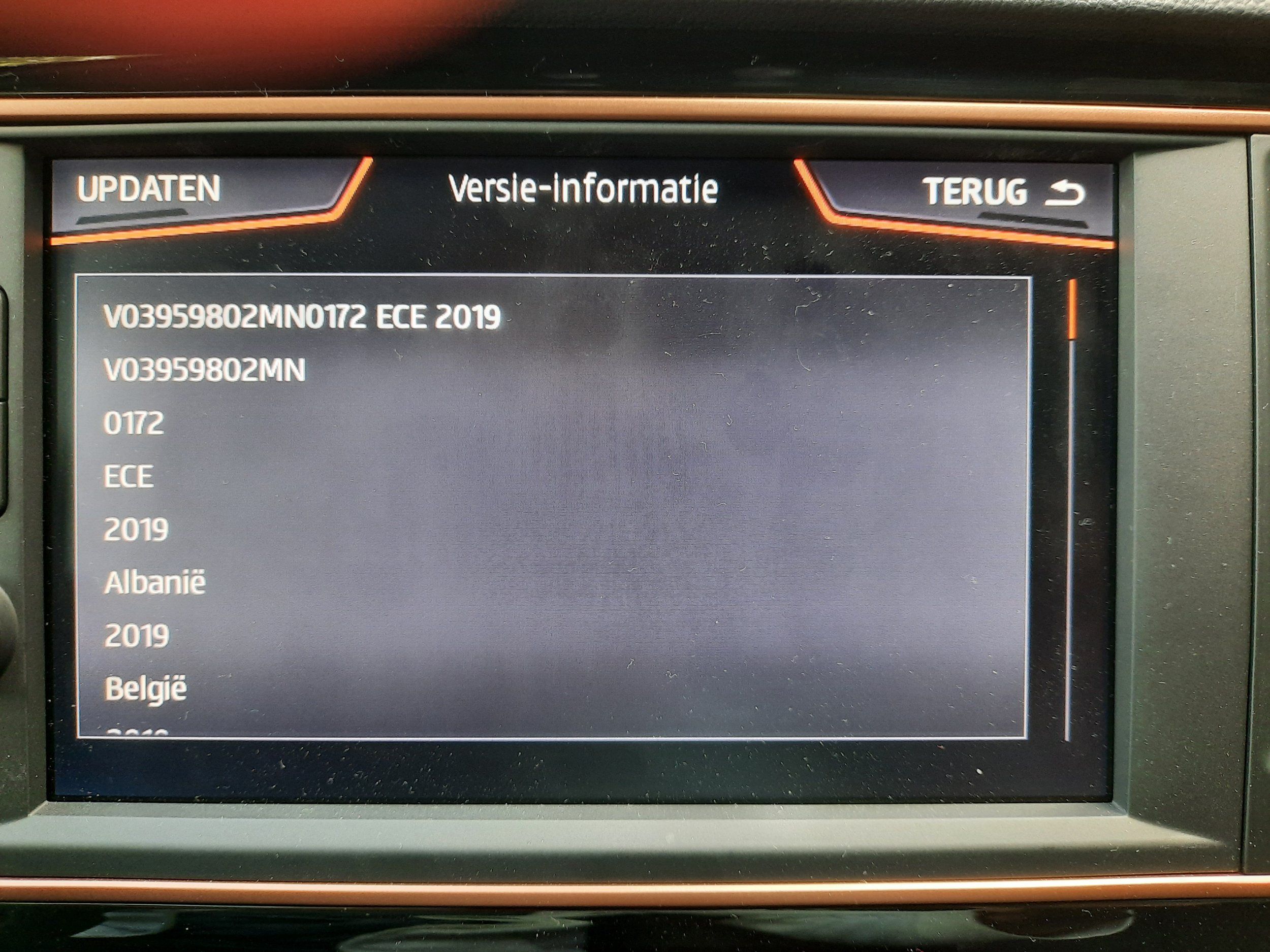

It took some time before I could try to update my maps, because I wanted to do this while driving (without using the nav).
My starting point was V03959802MN0172 ECE 2019 (in Navi Plus)
First I tried to update with the downloaded files from the VW site, from package P187_N60S5MIBH3_EU_NT.7z
But whatever I tried, the files were never recognised. Don't know why.
Then I tried with the files from EU_HIGH_T176.zip , downloaded from the SEAT site.
This worked, within 35 minutes the maps were updated from 072 to X176.

Well, moving all directories and files one level up did help. The files were recognised and 35 minutes later the update was ready.
What remains is the question where the wrong level could come from: Was it in the downloaded file, was it made by 7zip, or was it me by agreeing too fast with the automatic settings made by 7zip?
I'm happy with the resulting uptodate maps and I know now what to do next time. Thanks again @Tell !

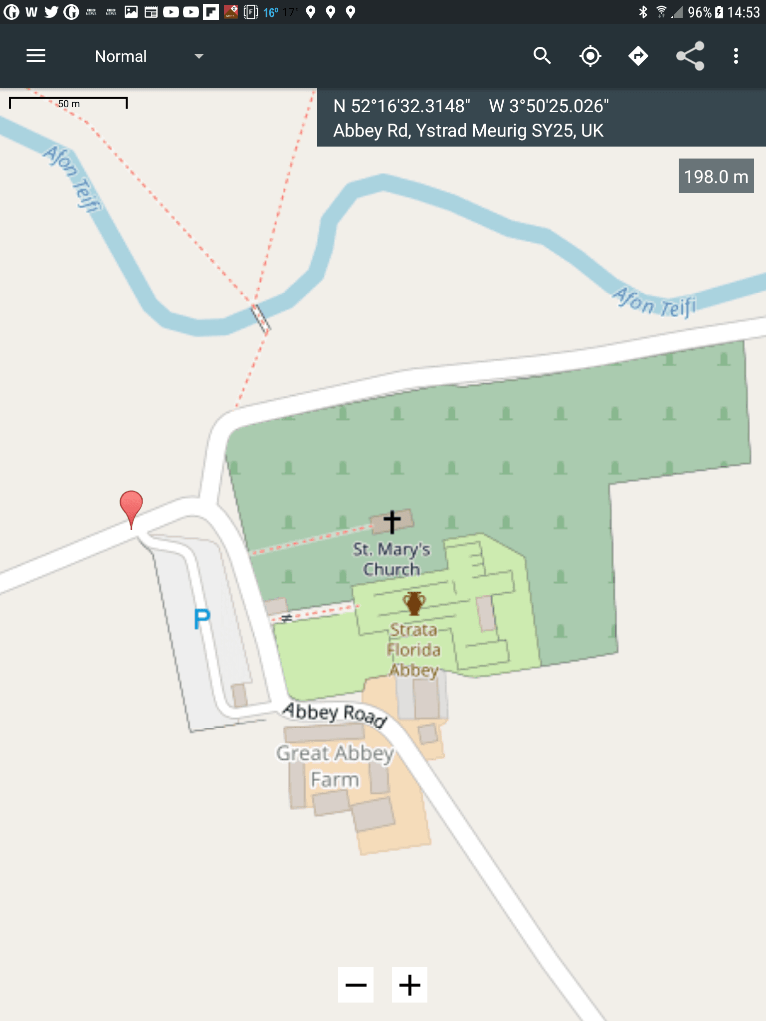

The other useful piece of Android software I use is Map Cordinates N45, E25. That generates coordinates in both the standard decimal degrees and degrees, minutes and seconds. The latter is what you dial into the car, former is the PoInspector one. It integrates into Google Maps and Openstreet (crowd sourced). Former is good for commercial, latter for outdoor activities. You toggle. You can find car parks for outdoor activities, camp sites etc on Openstreet that you won't find in Google Maps (They can't money-orise those too well so get left out). You do get access to the Google Street view so you can peekaboo places. Illustration of Openstreet map attached.

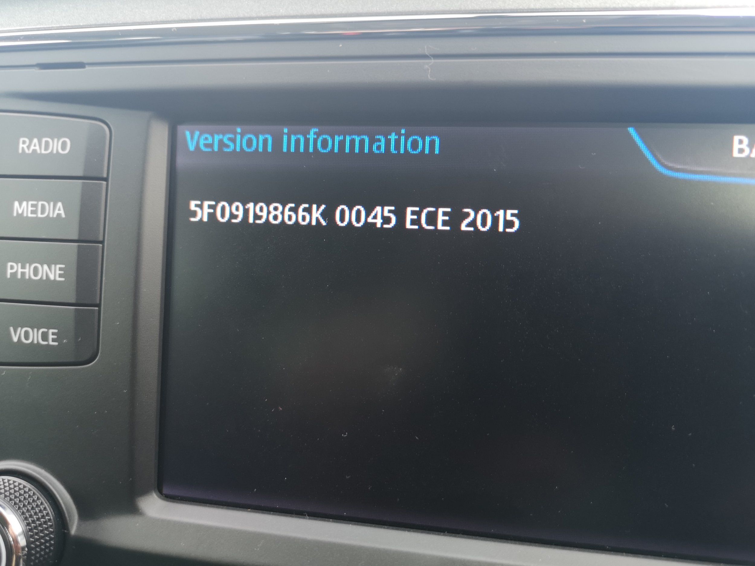

I need a copy of the files from 5F0919866H sat nav card, I wanna do a little experiment and I am more than happy to share the outcome here.
I have got a brand new 6P0919866AB card which doesn't fit to my MIB1 (5F0035858A)
I wanna check if I will leave a genuine OVERALL.nds file (if this will fail, I will keep trying with another files) , but will overwrite other ones my seat will recognize it and I will have my sat nav
to sum up:
Leon 2.0 TDI FR tech pack 2014
MIB1 5F0035858A
Hardware: 041
Software: 045
Card I have got: 6P0919866AB
copy of the files needed: 5F0919866H
Anyone can assist?
