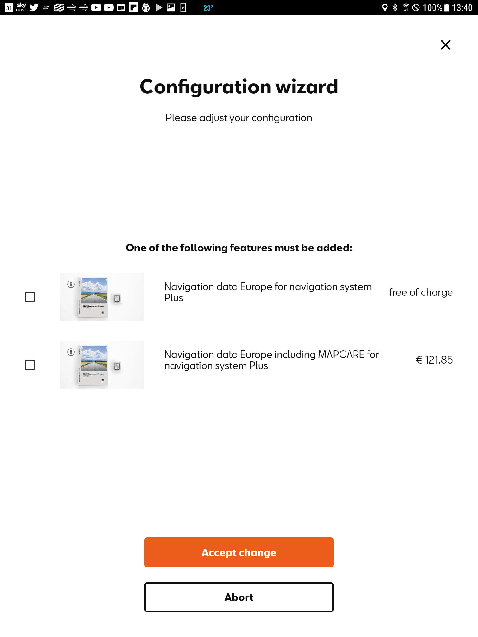

Building myself a German Ateca I got this. Still chargeable, the free bit is the non updatable maps I'd say. The other option is the 3 year fixed one unless anyone says anything different. I.e. no change on the continent but can be checked by anyone over there against the link above where the navigation FeC would take you beyond three years if the dealer story was correct. Did a few Googles, the situation is as is. Limited mapcare, not free for life in Europe on Seats. Their pet moan on the German Ateca Forum is that the three year Mapcare bought for a token figure starts on the build day, with delivery delays you miss the full three years (6 updates). Three years on the price is rammed up to 500 Euros or so for the next three years. Antagonism of Mapcare goes on. Buy a VW or Skoda and it is free for life of the car.
In summary, a dealer yarn.

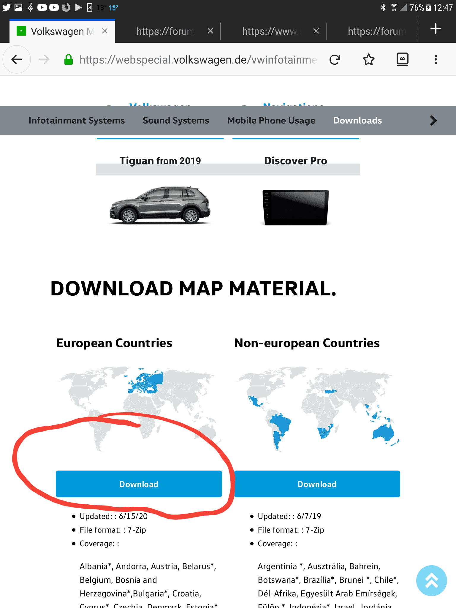

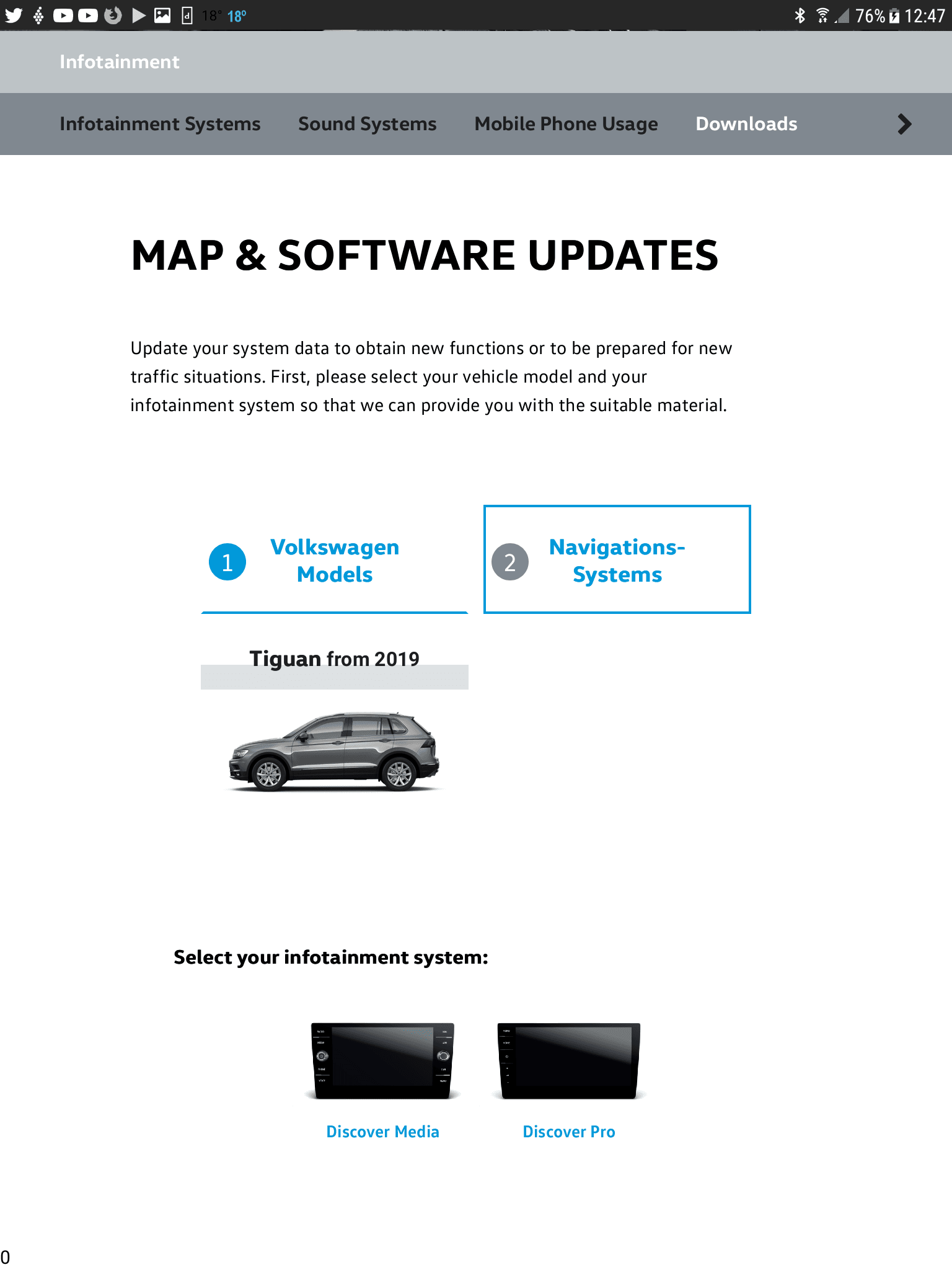

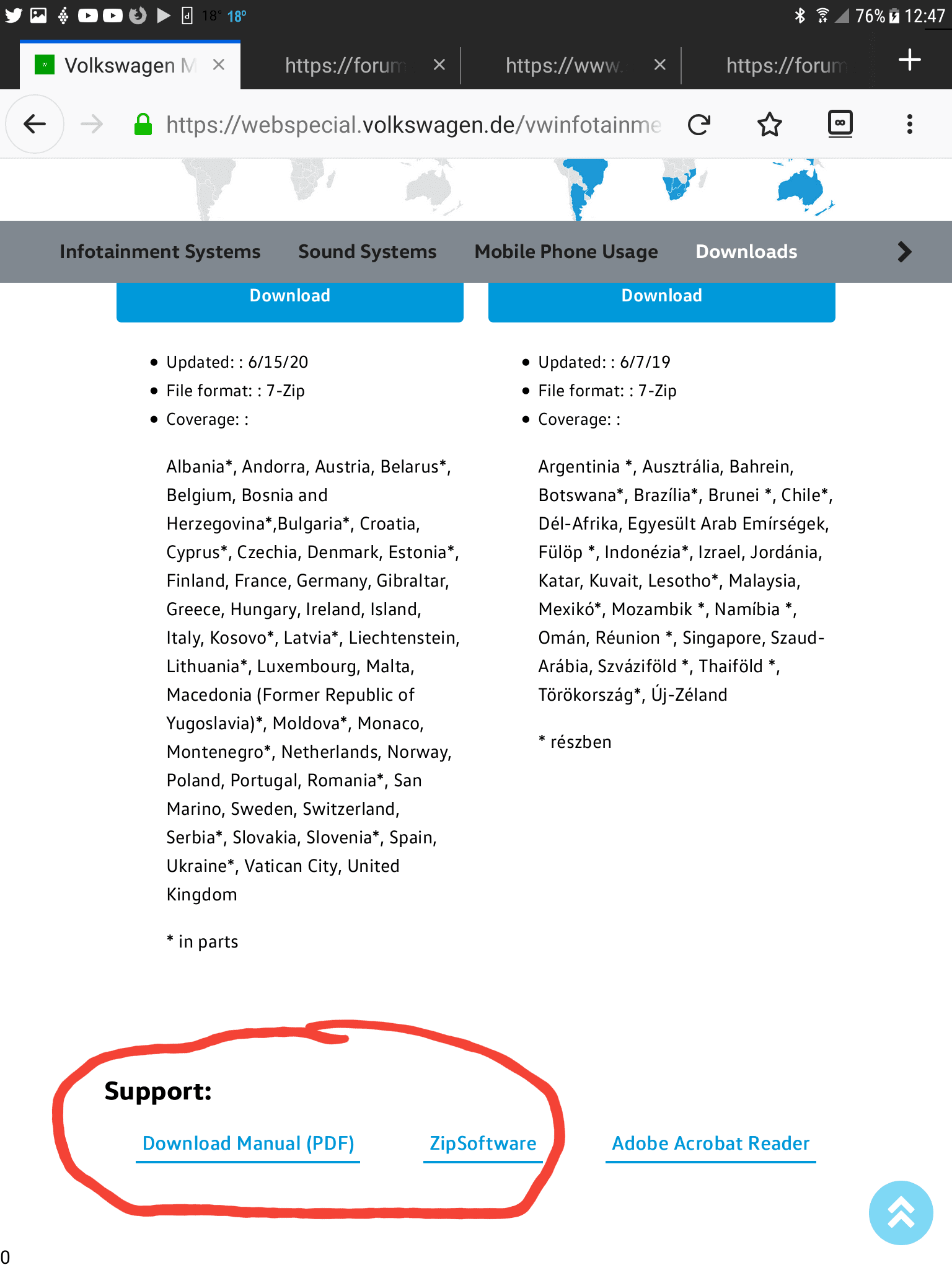

@CupraRST just in case it got lost in your question since you have unlimited Mapcare on a high you just use the VW map update site instructions since the Seat map update site tends to lag behind VW and the servers are faster:
You select say a recent Tiguan (2019) and Discover Pro unit, that is the Seat Plus unit (mib2 high), select download. The VW instructions are on the PDF, well written, 7 zip can be downloaded from the link. You are advised on a PC to only use 7 zip. If a Mac you need to use CleanMydrive on the SD card after the copy and the VW recommended Mac unzip “Keka” .
The units import needs to read exactly what was downloaded. It does a signature check. If there is an issue it will not start the update process off. Forums tend to be full of these issues for the high but as long as one does not vary from VW instructions and your navigation high FeC is fine. It will go ahead.
For a PC best to download and unzip to a local drive, then copy the contents to the SD card, you need a 32gb standard SD card, class 10, Fat 32 format. People mess this bit up by formatting the card to something other than Fat 32. You can use a USB if you want, probably better with SD card. Then once installed in the unit and triggered off it will do the update over a period of time restarting from where it left off, if you stop and start the car. 1-2 hours.
Retrofit you use the backend menu which won't be available to you. Some Leon mib2 high owners in the UK with the fixed delivery one year Mapcare have done it that way (VW route front screen), basically all Skoda owners without connect services use the VW site. All the same maps but released later although Seat did put out some odd quarters at one stage probably by accident. They do have recent mib2 standard South America and Middle East maps thou that VW aren't publishing so not all bad.

Crossed posts see above. Use the VW download. That is the most recent direct link:
And eyeball VW pdf

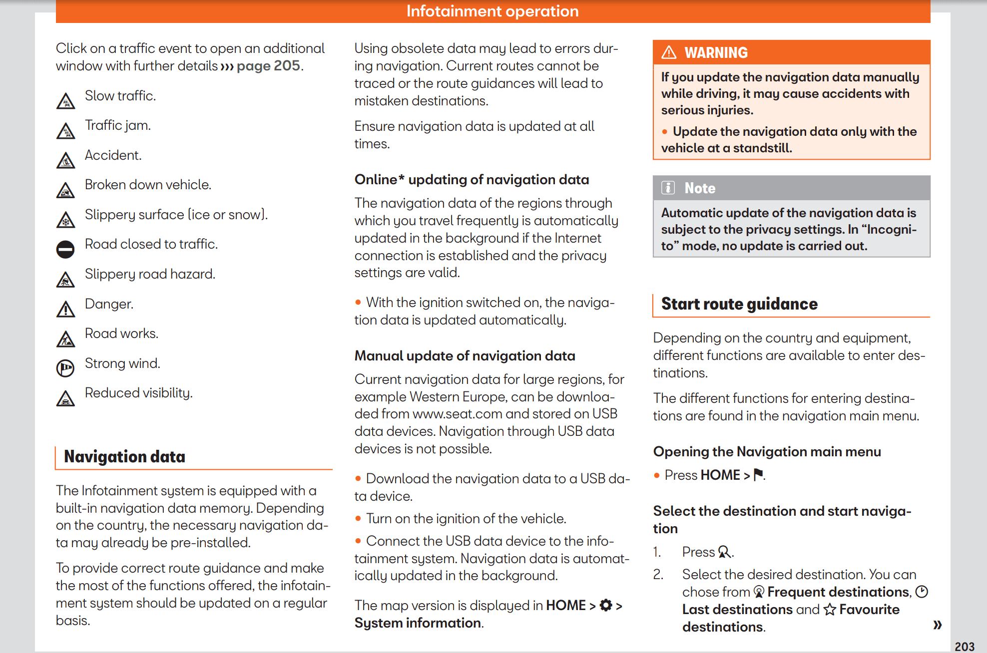

You won't loose your Cupra icons they are controlled by VCDS. They are stored elsewhere. It only updates the maps. Saved destinations and user POIs are left as is as well. Just the map memory.
With regard to downgrading a built in feature is that you can downgrade as well as upgrade, latter controlled by FeCs. So as long as the map series number is greater than what you have it's an upgrade. It will also show that on the screen once you have finished. Information / about what ever that option is.
Whilst running the update on the unit in the background disables navigation during the process you should come out the other end fine. Some people drive to work, turn the engine off, drive back and find the maps updated. You can always sit with the car with the engine running for the period :). The unit powers off about 20 minutes after the door is last closed with the engine off. You can do it off battery, least in the developer mode which is how I do opening the door every 15 minutes / visit the car twice. Does take longer the front end way (up to two hours) but the advantage is it remembers where it got to and will start up again if it looses power from where it got to, developers menu, no you have to start again from scratch. It is designed to be updated the way you will do it.
If you have any doubts this is where it was done using the front screen using the UK not for life Mapcare using the VW download:
I was a spoil sport and worked out when their Mapcare would run out @paddy6789 given their FeC codes from Walone ;).
So Paddy can tell you how it went that way. It's just the normal VAG high map update using the timely VW website.

Just when you think the music has stopped, stumbled over the new MIB3 Standard map up load file for the Leon 4 and I believe Ateca 2020... now where is @exciter these days. The download can be viewed on the VW site under a Tiguan 2020 Discover Media. Different to Mib 2 / 2.5 however those little NDS file pop out at you and overall.nds files are scattered around. eg.
C:\Users\Mate\Downloads\EUR_4PR031_FCT3WS-19144_Offline_Update.tar\MIB31_EUWO.UR5001\
It's snuggled up with other files as Mib2 standard which we recognise. I don't know whether the workaround works or whether the stable door got bolted up before the horse left it. Don't have a MIB3 standard unit and it will be a time. The .db files look interesting.
The question anyone with a Leon 4 / Ateca 2020 who is familiar with the workaround and has maps could give it a go - all risk to them. Reading the PDF on the link to the MIB3 Standard which gives you the VW process it appears there is no map card in these units now since the data import is via USB C. Like MIB2 High if the maps are held within and you force an incorrect copy you could have a problem. They may be validated to stop you doing this.
Raises a few question as to where your base overall.nds file is stored. Say for example you are on June 2020 maps you would take a copy of that download then that overall.nds file would be the one you would use in the future. If your car has come with old maps then you would be looking for that version...
Direct download link is this
  • Does the workaround work for future releases ?.
  • What download are we currently on for Leon 2020 uses... (June 2020 ?)
  • Do the UK ones now come with Mapcare beyond a year or free now or is it more of the same ?. (build codes will tell you that)
However there is a nasty signature appearing in the file PACKAGE.SLIST which might lock down the whole lot from wandering fingers. Sorry to break the news if that's the case. Let's hope Seat have seen sense and have adopted the same licensing of the product across the VAG group.
The Maps are getting on for 32 GB about the same size as the MIB2 high ones.
Doesn't stop here either... the Discover Pro maps (MIB3 High) is the same map upload as the Discover Standard assuming VW haven't messed up what they have on their screens (the two files are byte to byte identical). What Seat UK's version of the high might become apparent at some stage. Needs further research of the difference of the VW offering.

Switching to looking at the Leon 4 user manual
https://secure-www.seat.ru/content/...03&_charset_=UTF-8&chapter=MOD-NAV&category=1
Appropriate section attached. For off-line updates USB-C is the only way of updating the maps, online is via the connected services as you pass through region's. Maps would appear to be stored in the unit like the mib2 high not on an SD card.
The data structure of the off-line maps in the download relates to the text. The fragmentation of the map files and repetition of some of the files we recognise from the standard mib2 unit, that's to say they have adopted the Mib2 standard's indexing method into the geographical data rather than the Mib2 High.
Current material does not make it clear whether Mapcare is abandoned as a product or not on Leon 4s in the UK. German configurator shows Mapcare as "free". Whether there are time-scales to free is not known.
UK configurator 'Online infotainment: 12 month subscription included: Online map update, Online traffic information, Online route calculation, Parking and petrol stations'.
Is it free offline ?.
